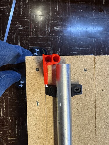

Would someone mind posting a picture of the Ymin Endstop from directly above? I just want to understand the location of the tube / last clip to the end stop. Just curious how you located the holes for drilling? just a pencil inserted into the end stop?
Looks good. I can only offer a glow-in-the-dark shot:
/edit: the screw needs to be all the way in. :slight_smile:
That’s how I did mine! :man_shrugging:
I printed the first few layers to locate the holes for predrill
