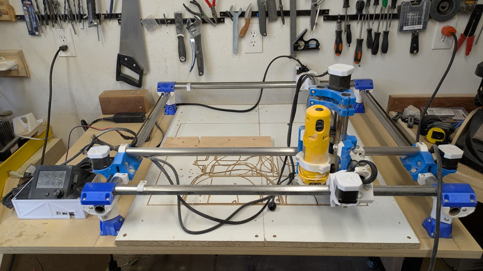

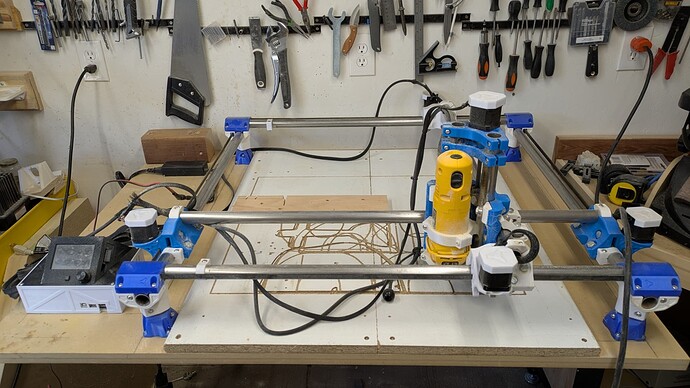

I have had an MPCNC since January 2021 - used it quite a bit. However I never got around to doing any wire managed or dust control, and its showing its age:
I would like to upgrade to an LR4 to address those issues and to get a little bigger work area. I have room for a 3’x5’ table so am planning a 24"x48" work area.

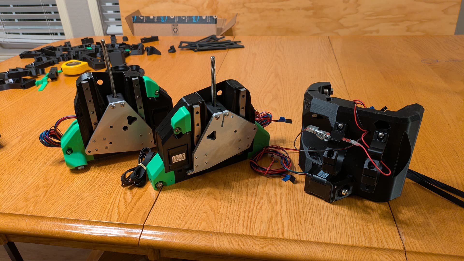

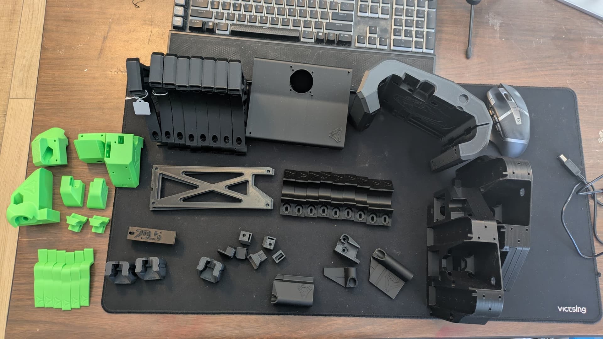

I have my parts all printed and ready to go:

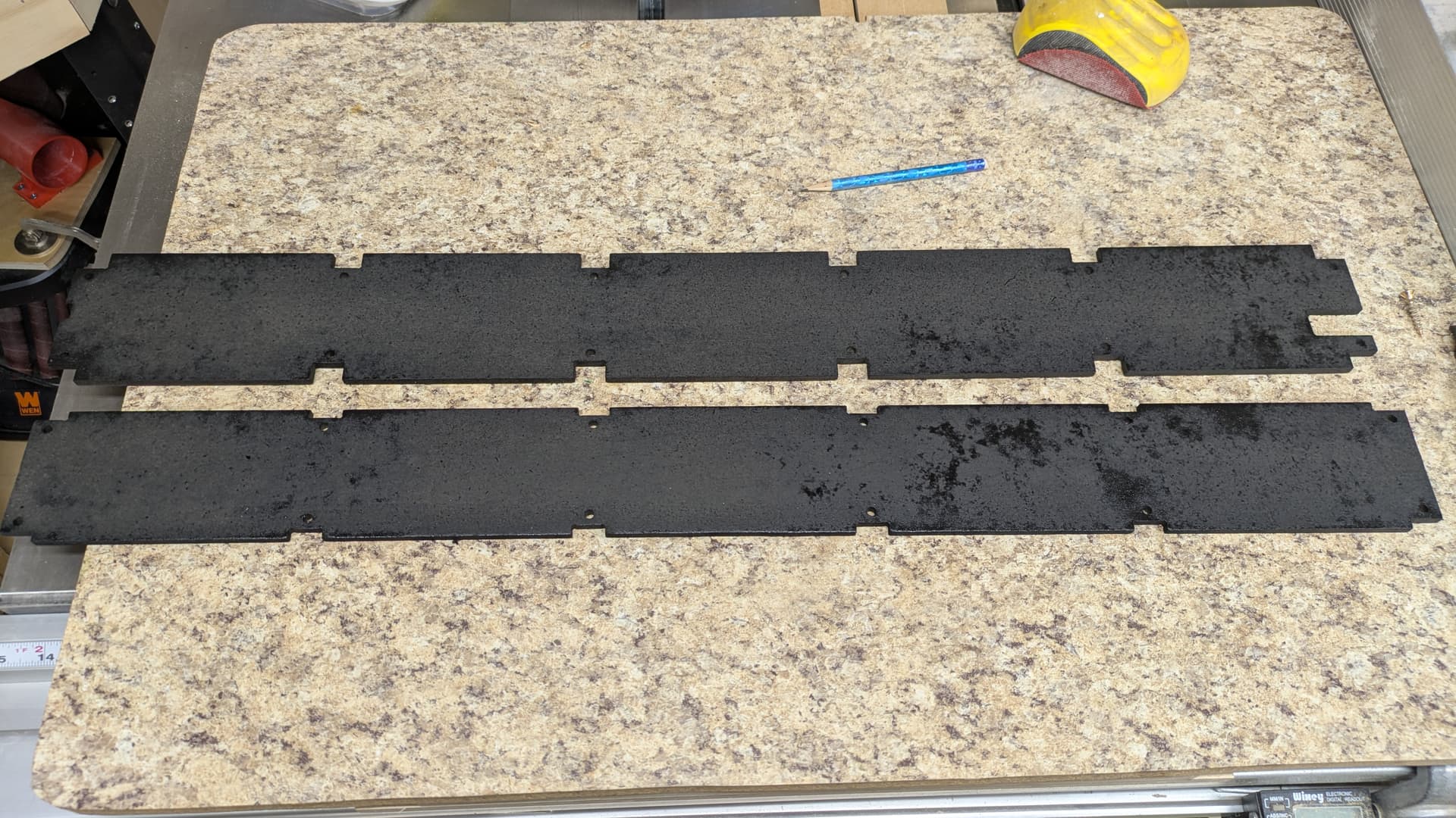

I got a set of strut plates cut on the old machine tonight!

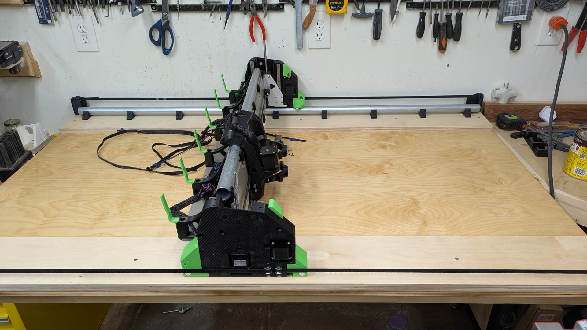

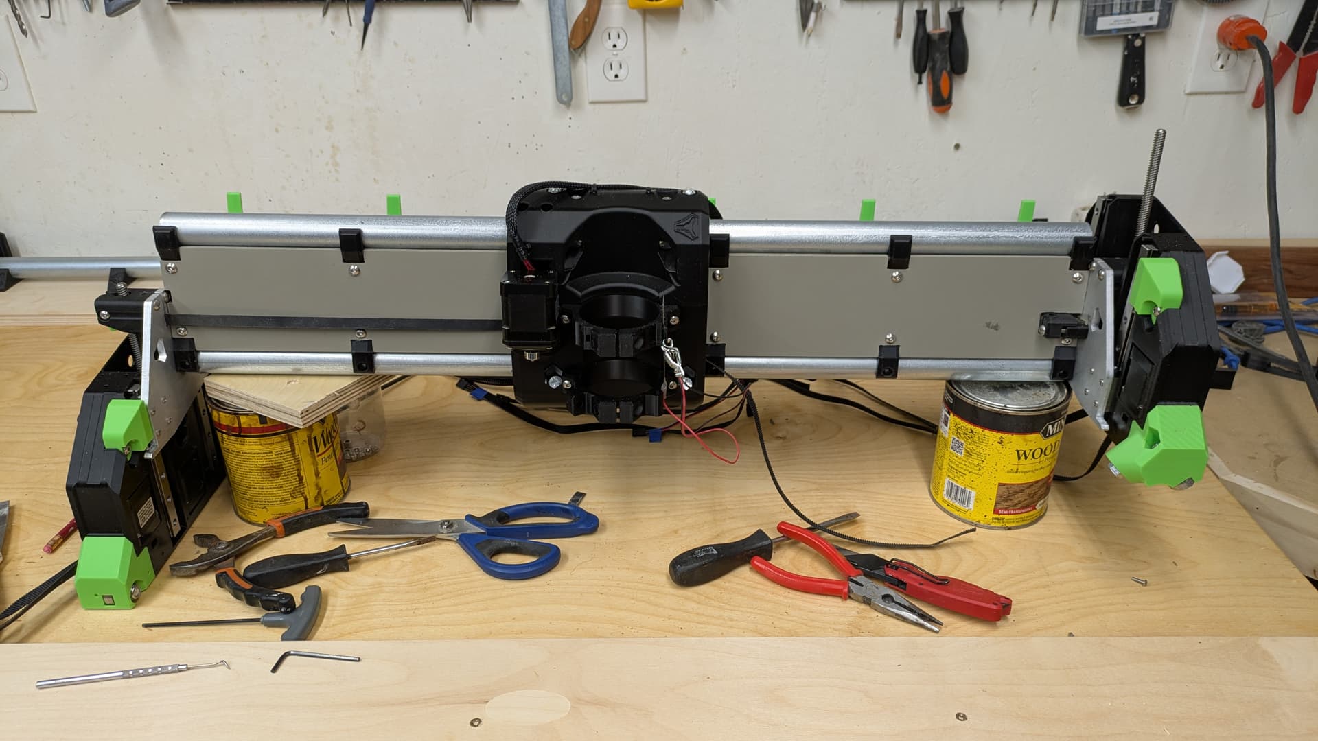

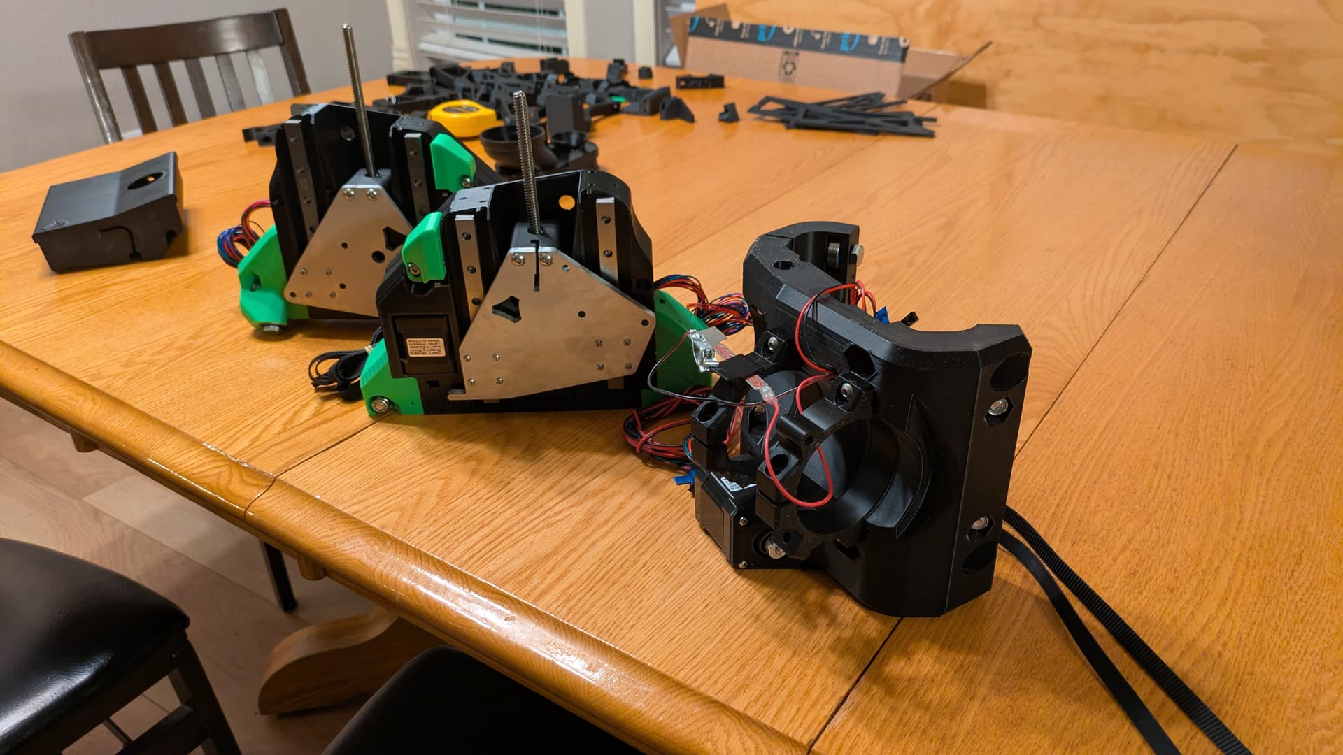

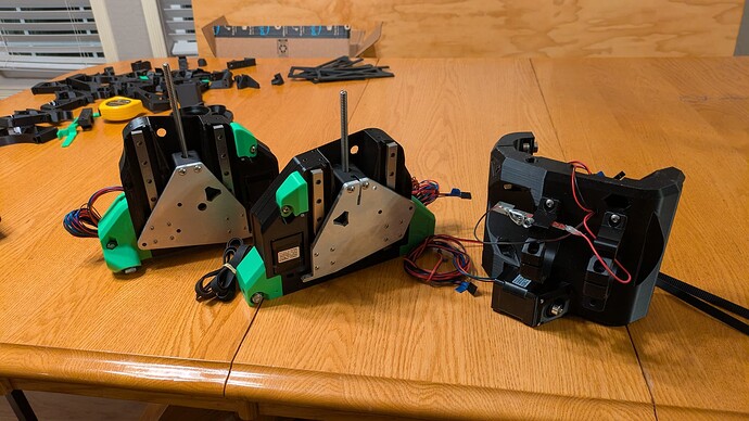

I made some good progress today! I tore down the MPCNC and built the core and side plate assemblies

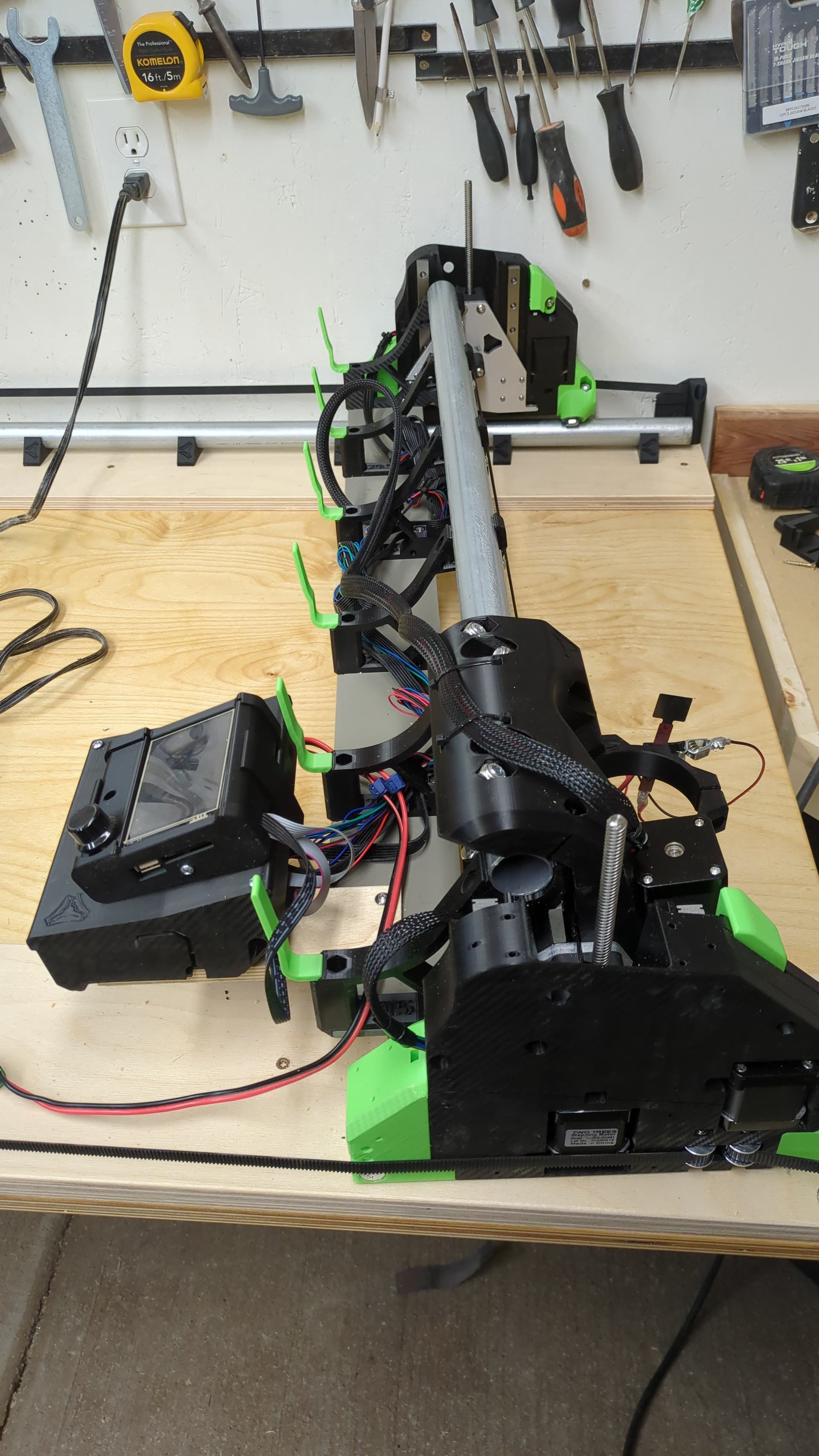

More progress today. I got the machine together and a table built for it. Hopefully tomorrow I can get through the wiring.

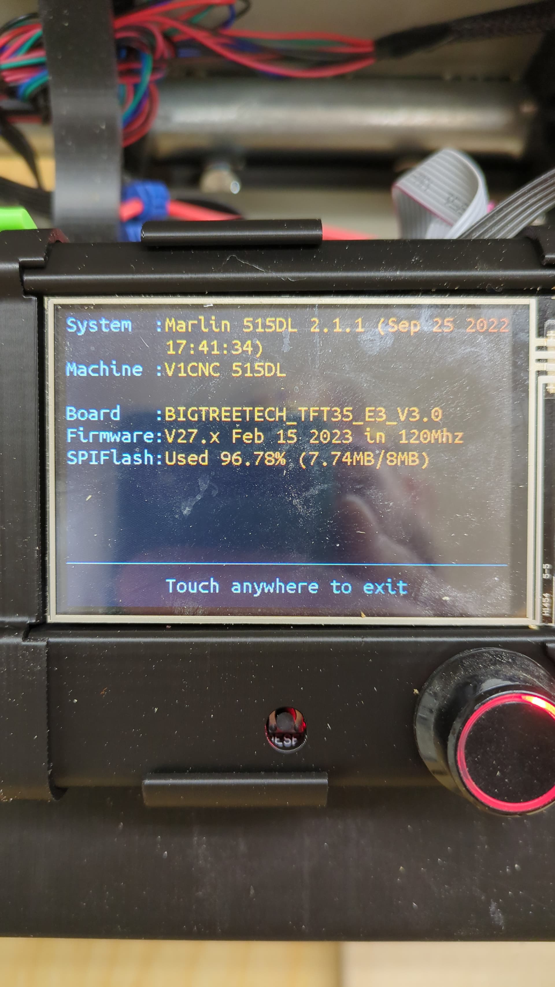

I have the machine wired up, but am having trouble with homing. The machine moves manually as it should but when I home y or z then only one side activated. I am using the SKR Pro 1.2 control board and tft35 from my MPCNC with the latest version of the firmware as far as I can tell. Any tips?
Here is a shot of the system info if that helps
Scratch that, homing is working! A couple of my endstop plugs had come loose when I was putting the lid on the electronics box.

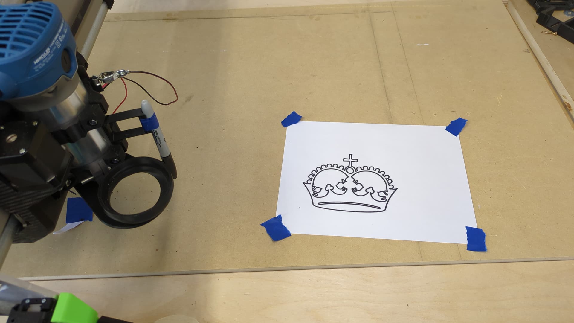

Well I succeeded in getting it to draw a crown!
