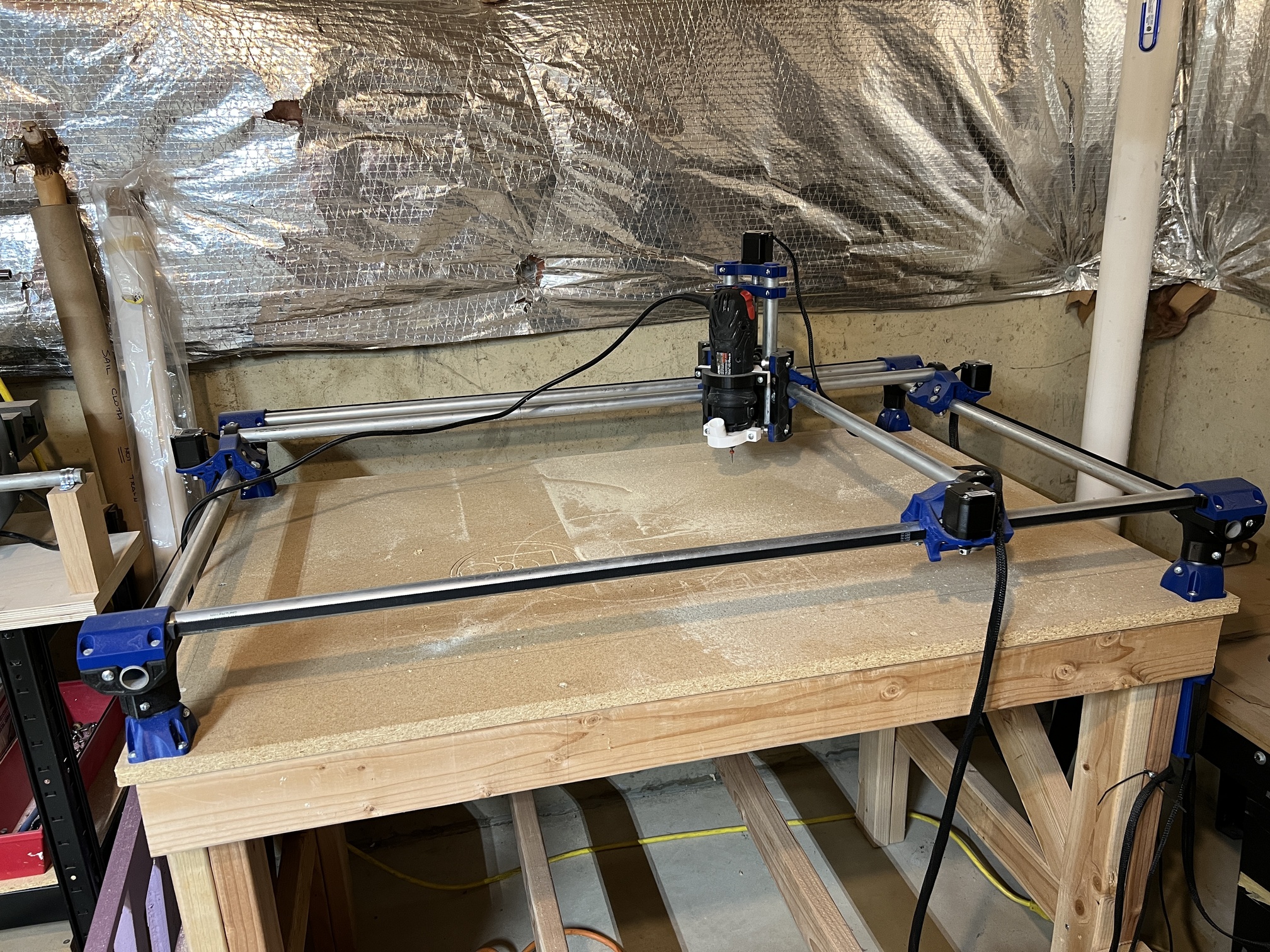

I’ve had an MPCNC Primo for a few years and decided to change to the Lowrider 3 sized to use my existing table. I stretched the size of the Primo and it looses accuracy just as the documentation said but I am stubborn and built it to have a cutting area of 19.5” x 39”. The Lowrider with be 19.5” x 34”.

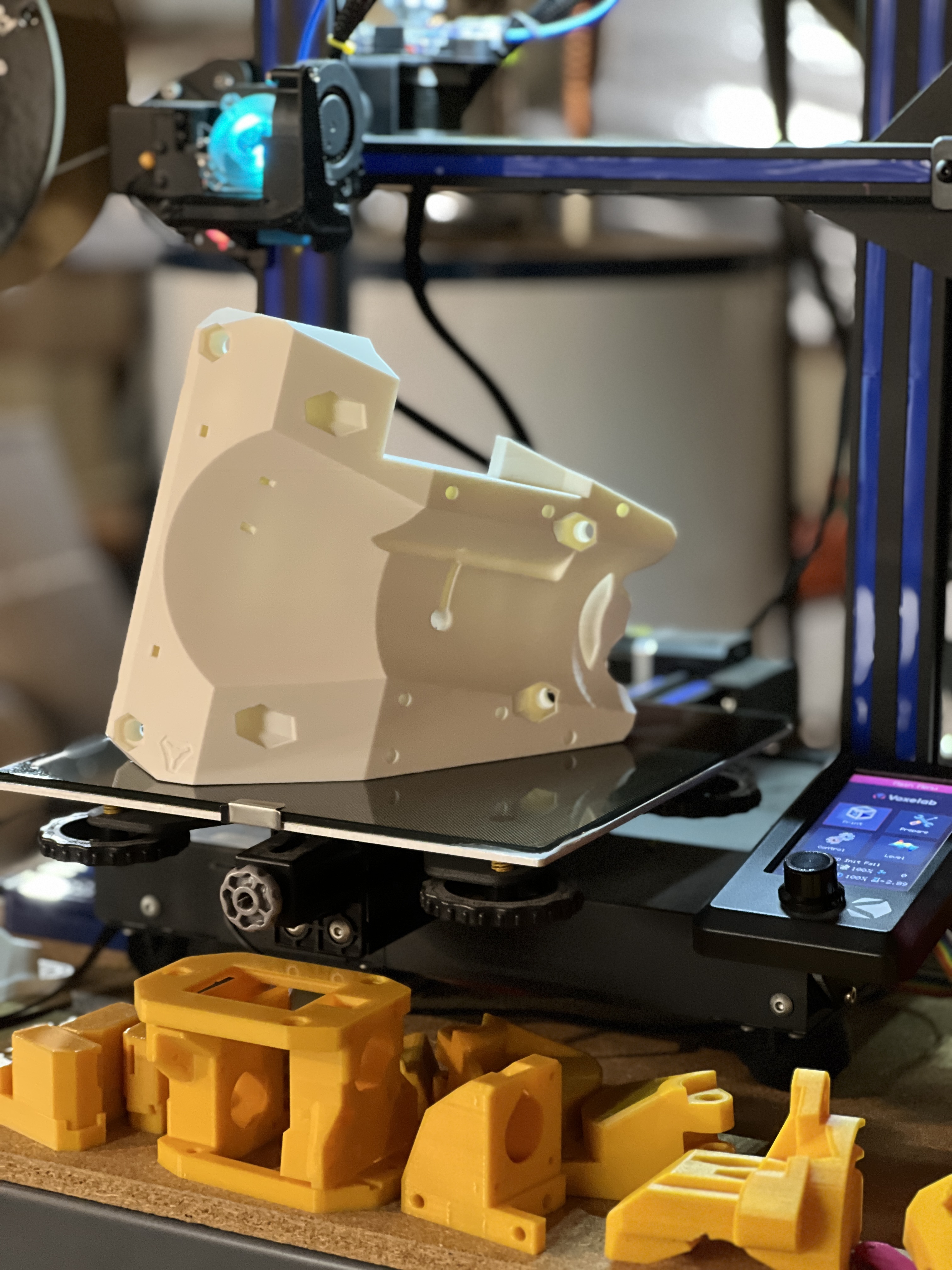

I have finished printing the new parts and only need a some hardware and can start the build. It is nice being able to cut the struts and XZ plates on the Primo.
Looks awesome. I guess you can reuse all your railing too, right?

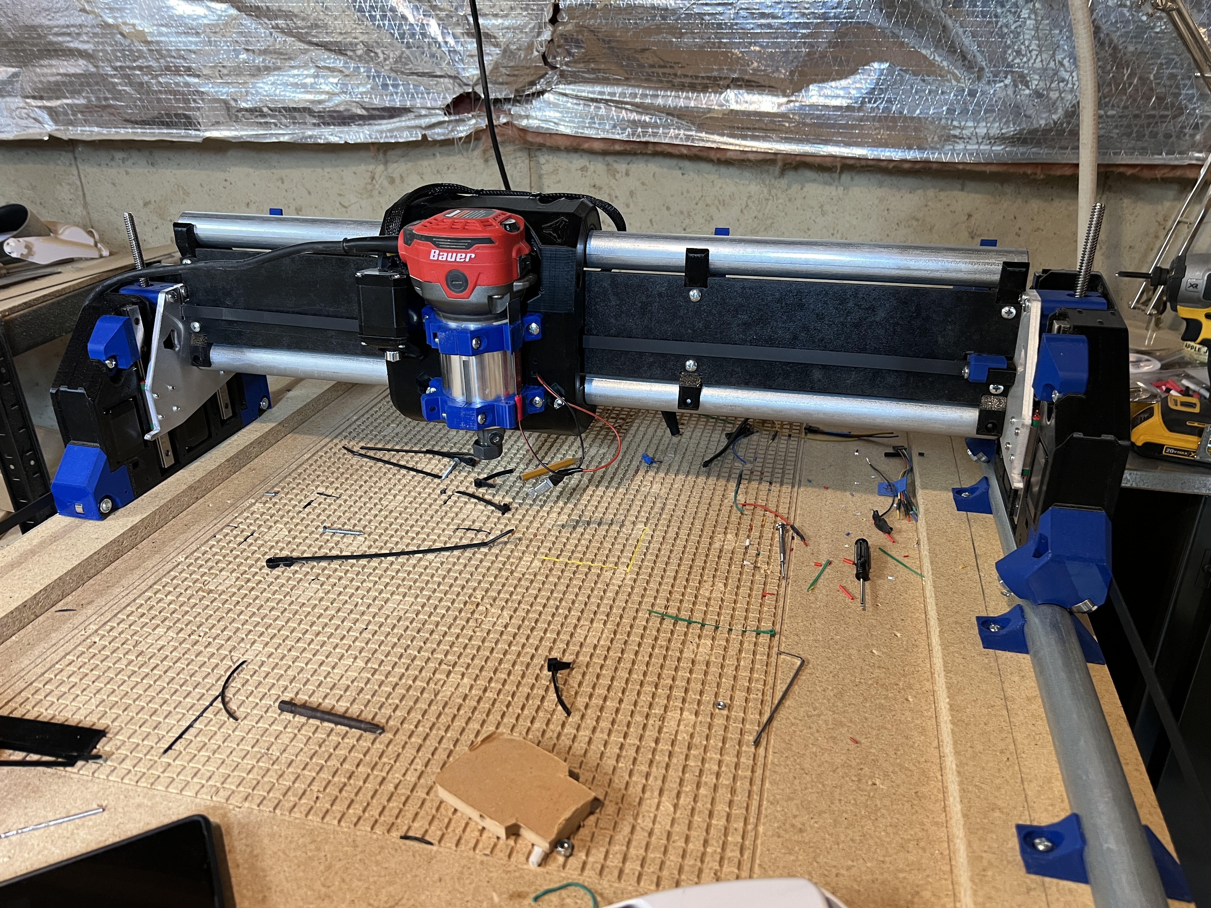

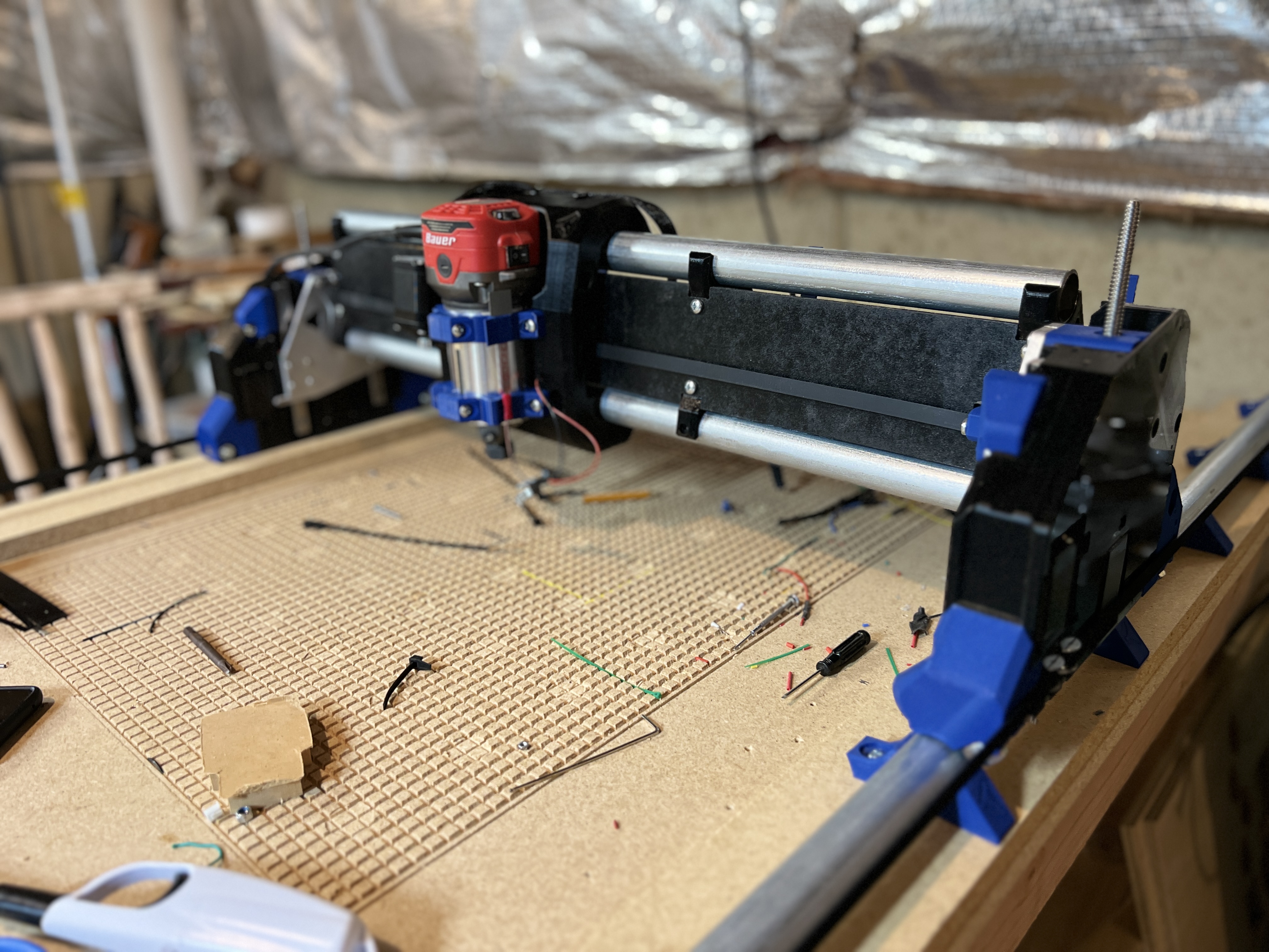

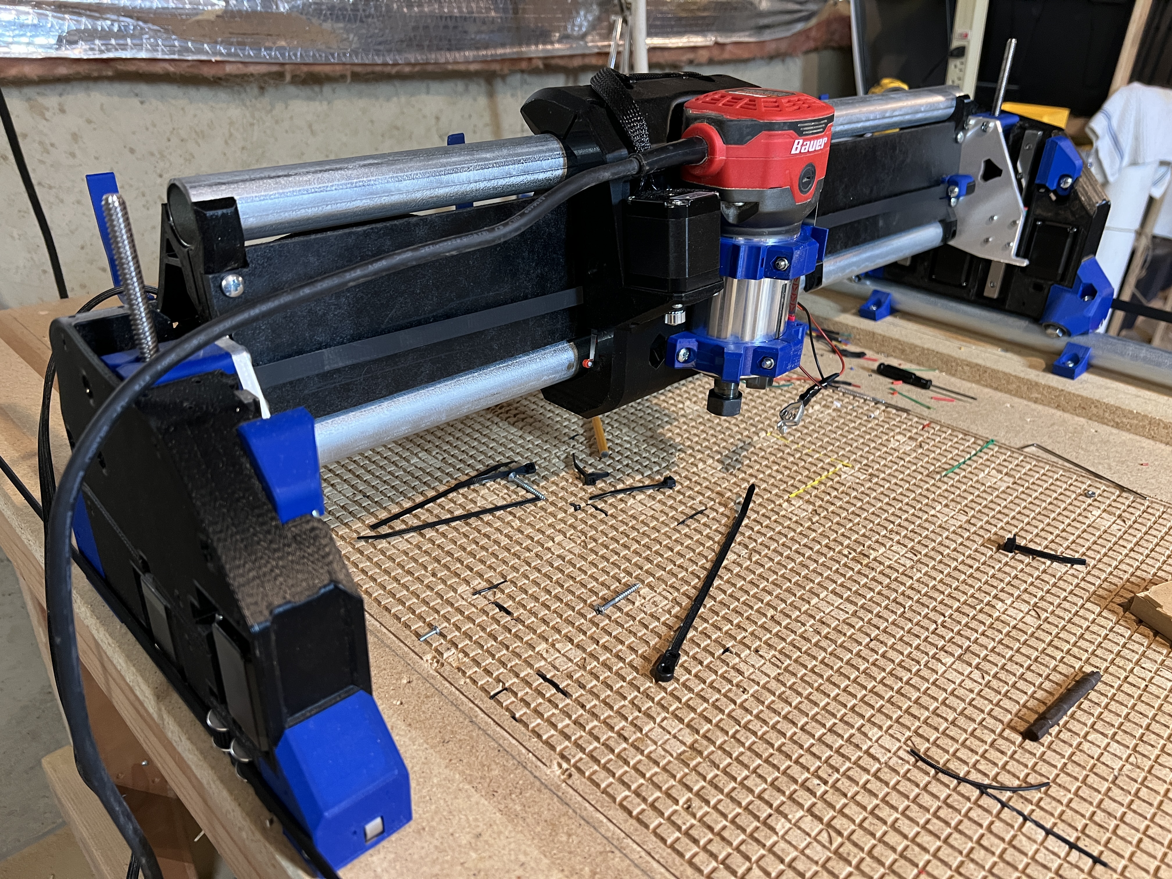

Well I couldn’t help myself and went with the Lowrider 4. Plenty of screws from my original Primo so just bought the 1” conduit, new plates and LR3 to LR4 upgrade kit. And one extra endstop. I managed to build it within 1mm of being square too so that was a nice treat.
Looks great! But that looks like a Lowrider 4. How is the bauer working out for you? I had one for a while and it worked great.

The Bauer is working very well but only has a few hours on it so far. I am yet to be disappointed with a Harbor Freight tool. I had an old Craftsman rotary cutter that I used on the Primo originally but it finally dies after a decade of use as it was designed and then used on the cnc.
My total upgrade cost was just under $225 to go from the Primo to LR4. This includes three new rolls of PLA, linear rails, belts, flexible couplers, endstop switch, and Ryan’s LR3 to LR4 conversion kit.
It was a rather easy build aside from getting the x belt slotted. That was not an easy task and I mucked up the belt a little but it works perfectly.

I just tried the Tramming & Squaring with Jackpot controller that @DougJoseph posted on YouTube and it seems that my years of woodworking have paid off. My LR4 is square by less than 1mm and the x-axis is within 0.097mm. Not too shabby.
