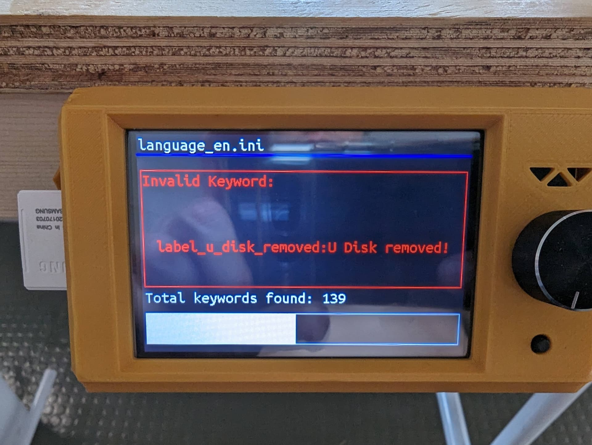

Another error I get, any language pack I choose is this :

Is this a board from the v1e shop, or did you source it independently?
That screen is not from me. The screen firmware we offer should actually work for it. Have you flashed the screen with our firmware, you need to?

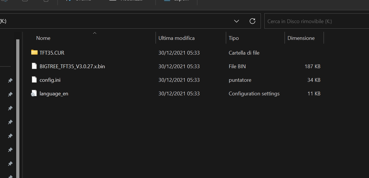

I just updated the lastest FW of the board:
But I still have troubles with the tft monitor:
in fact even If during the update process there was the “updating logo” message i still have this thing:
this is what I copied into a fresh formatted FAT 32 memory (2gb)
