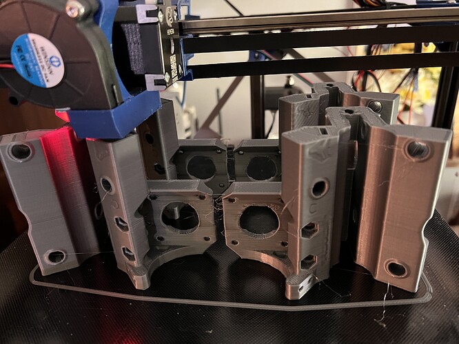

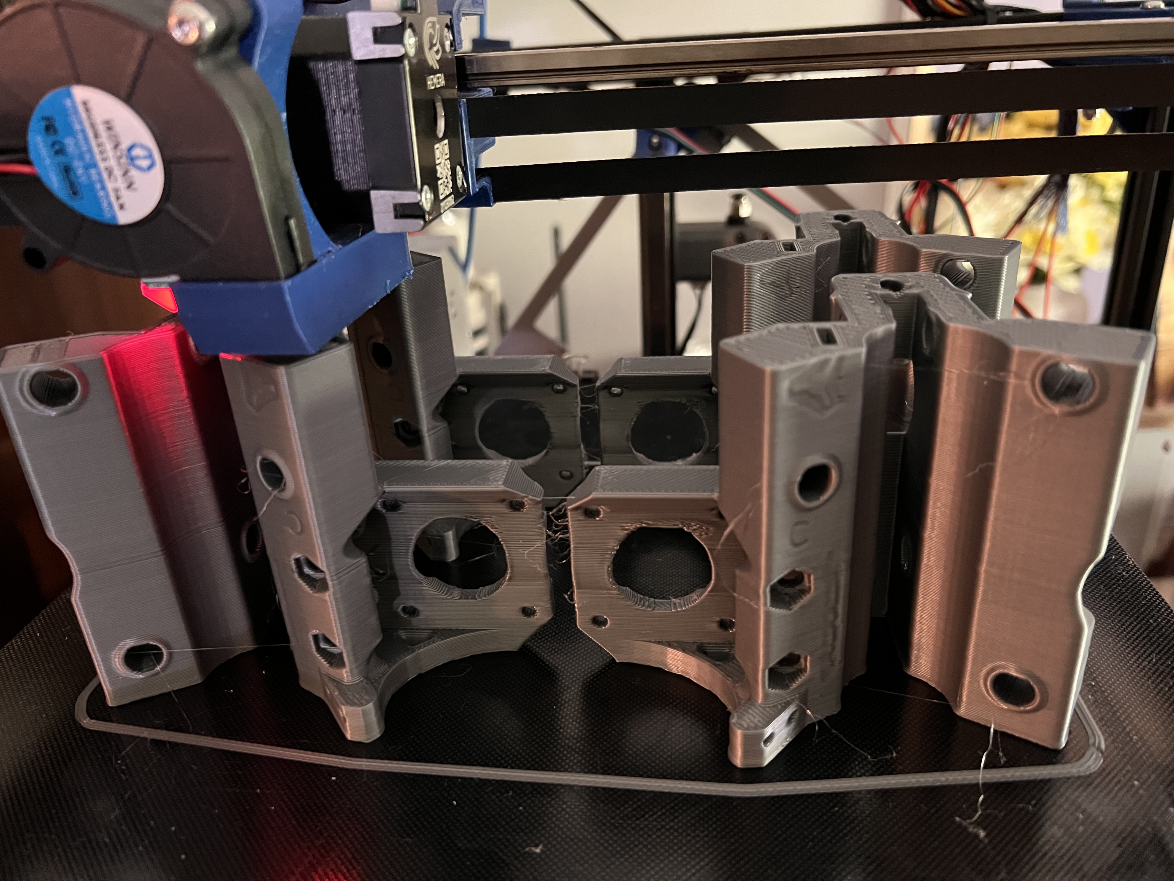

Thank you for the Teaching Tech recommendation. I went through all the tuning, and most things didn’t change. I did however find that increasing the nozzle temp to 230 bonds this PLA enough to fix the area in question.
So to whoever’s is having issues with this particular area, increase the temp to allow the layers to bond stronger and not break at the thin/weak area.

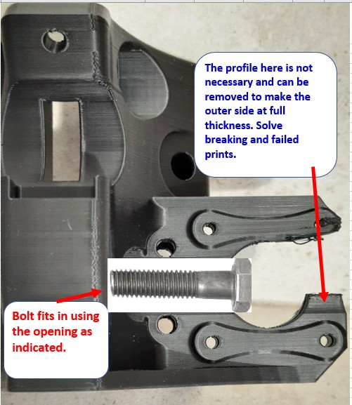

I also have the print failure on the truck as described above. I am using the the recommended settings and two of my prints broke off at the thinnest part. I am stuck now with all the parts printed except the trucks. I dont see the point of extending the hollow profile of the bolt through to the outer side of the motor mount. The bolt is short enough to slide without having to use the hollow profile on the outer part of the motor mount. Is there someone who has modified the outer side to be thicker so that it prints easier. Hi,
I also have the print failure on the truck as described above. I am using the the recommended settings and two of my prints broke off at the thinnest part. I am stuck now with all the parts printed except the trucks. I dont see the point of extending the hollow profile of the bolt through to the outer side of the motor mount. The bolt is short enough to slide without having to use the hollow profile on the outer part of the motor mount. Is there anyone who has modified the truck to make the outer side thicker to make printing easier or at least possible.

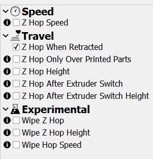

You can try orienting the thin part to the best flow from your fan, use Z hop, and print a bit slower to give your parts time to cool, I also suggest layers at 80% thickness/nozzle diameter. While some have had an issue printing this I assure you this in not very common (this thread is a year old).
You can add material if you would like, you can edit the stl in most cad programs.

I am a bit of a novice and dont fully understand the Z hop, but here are my current settings. Maybe something I need to do extra here.
Z Hop

Print a bit slower, 40-45mm/s. I am not sure what slicer that is or what those different zhops are. If the information doesn’t help for each for them what you have selected should help.

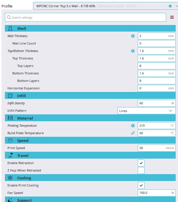

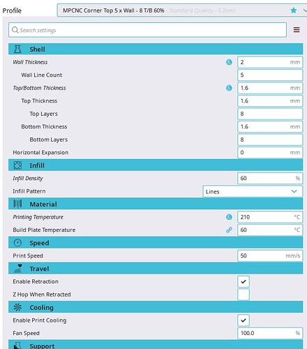

I am using the Creality slicer that comes with the Ender 3 S1 I just bought. Thanks to Ryan for the suggestion which I will follow. Can you please share your print settings to compare with mine and maybe comment on mine.
Layer Height - .2mm
Wall Thickness - .2
Wall count - 5 = 1mm wall thickness
Top and Bottom Thickness - 1.6mm
Temp 210 - The PLA is rated at 200 -230Deg
Or anything else yo can see on my settings . And the direction you had your prints. Side to side or front to back.

I have 3 creality printers and use Cura on all of them. I don’t have any experience on the creality slicer but i do believe its an offshoot of cura, but it doesn’t get the updates that cura does. So you might think about switching to Cura as it will have a profile for your printer in it already.
Im printing my trucks on my MP3DP V4 so my settings might differ from yours. Also I’m running a .6 nozzle as well. Also I use Super Slicer for this printer.
I use 3 Perimeters at 1.2mm wall thickness, Also 3 bottom and 3 top layers
.3mm layer height (this is achievable with a .4mm nozzle if that is what you are using. I could go up to .4 or .5 just never have)
I’m using 50% rectilinear infill
Printing at 50mm/s
Hopefully this helps you some. If you are using a .4mm nozzle then i would bring your wall thickness to .4mm. If you are using a .2mm nozzle then I have to ask why??? also if that’s what you are using then you are pushing it way too hard with a .2mm layer height. no more than 75-80% nozzle size to layer height.
