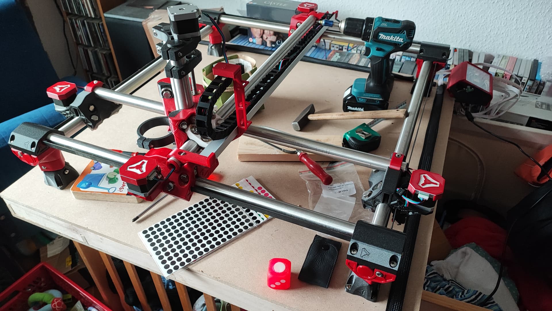

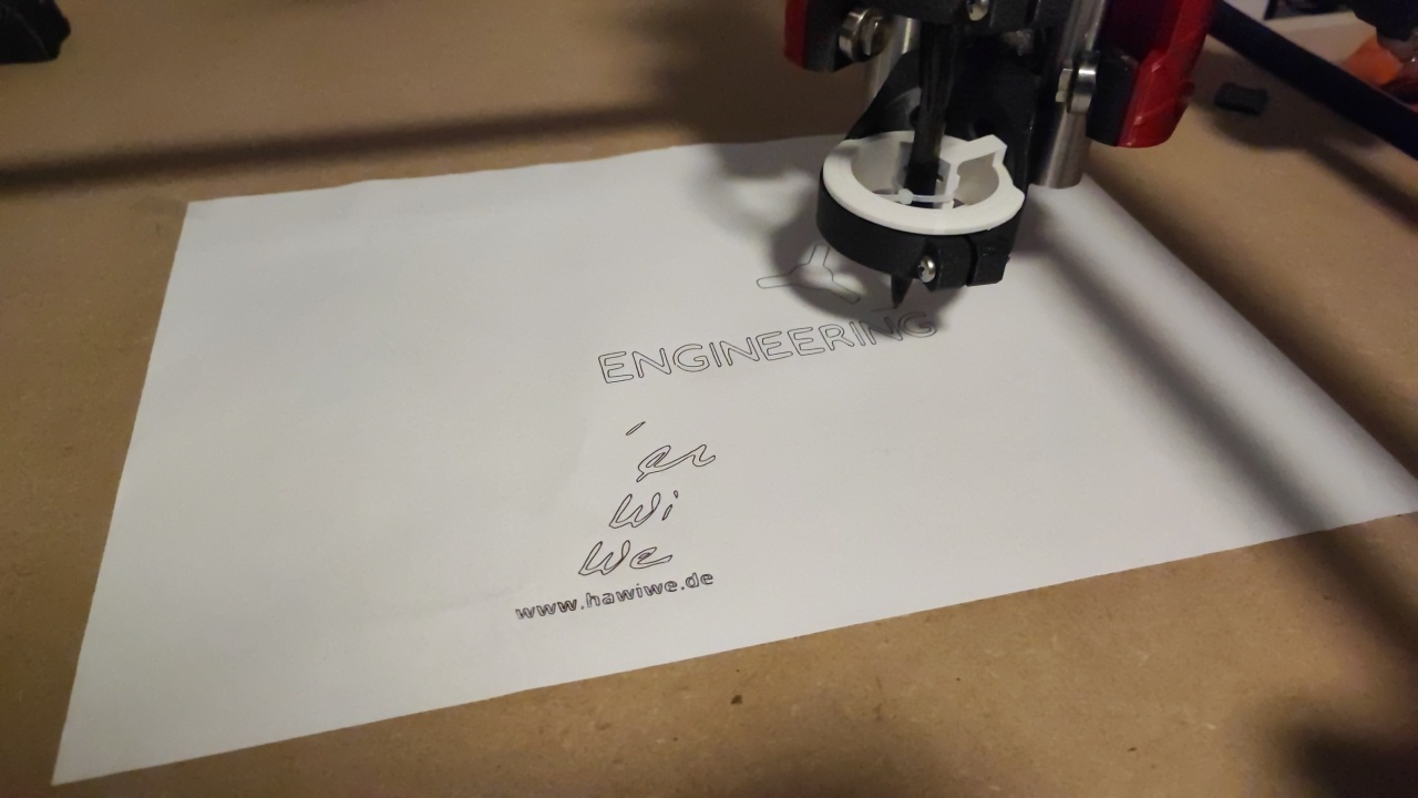

Schneewittchen Reanimated as a drag knife, plotter and later laser.
Oh yes, I want to do that!! RAWR!
The new insides (not all of it, but most of it). I am not crimping cables again. I can buy a cable for 3€ with everything ready which saves me at least 20 minutes per cable (yes, I am that bad at crimping). I call that a deal. I also still have some 6mm belts from when I bought everything for the Burly, but then the Primo was released, so I am going to use those 6mm belts. They do not need to move much. I also ordered bigger motors for the Froschkönig, so Schneewittchen is getting the old ones back. I am also reducing the size to 50x50cm for more rigidity.

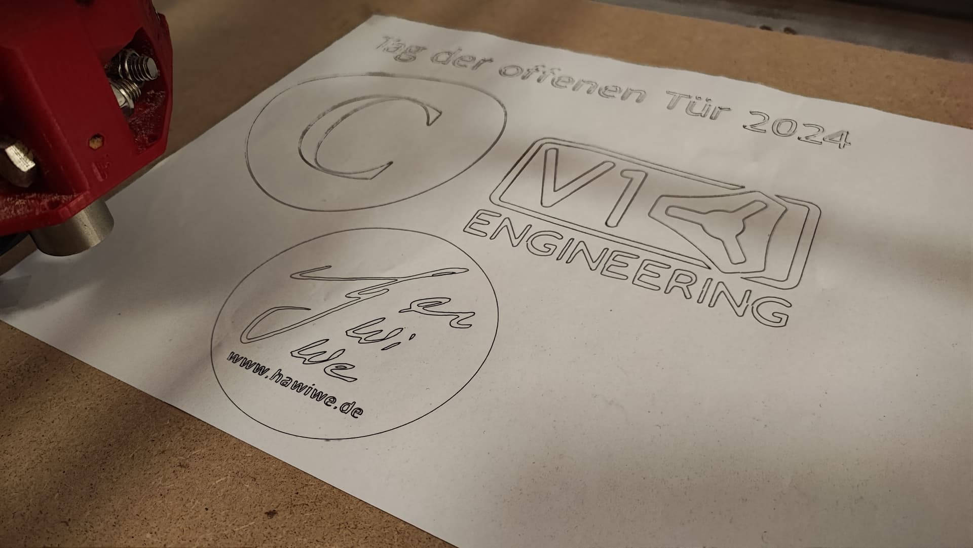

Getting there. To be presented at school on Saturday. :slightly_smiling_face:
Looking good!

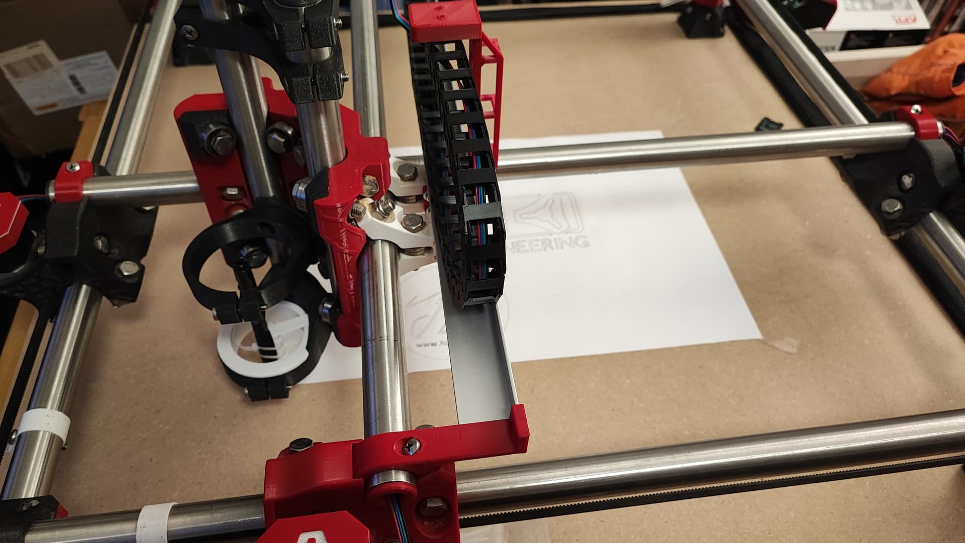

Do you feel that the cable-chain is a must have? Also, do you have any plans for the spoilboard?
This one is for plotting only first, if it was for cutting I would have suspended the feet on another board, like I did in the past. I still have them and could add them if needed. :slightly_smiling_face:
I played around with the tape measure trick on X and Y and made some mounts for it, never had that before. I used to have a drag chain for Z the last time as well, so I did that again, but the tape measure would have worked as well as long as there is the aluminium profile. I also like that nothing attaches to Z directly, just the core.
It‘s not a crown, but I think that should count as well. :stuck_out_tongue: I did manage to get Fluid going, though I still think it is inferior to Estlcam as a controller (except for autosquaring and the wireless option)… :sweat_smile: One thing that amazed me is the speed for the rapids. That thing is fast. And soooo quiet. The motors on my LowRider, powered by TB6600 always make noises, the stepper drivers also make some noise, but the small ones on the Jackpot are just silent. That‘s really neat. Does not really matter if the CNC is working, but for a plotter it is incredibly cool. :slight_smile:
