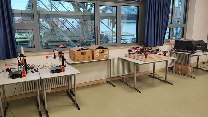

Open House today at my school. Schneewittchen Reanimated’s First day. :slightly_smiling_face:

Today’s bad idea: planing the spoilboard in your office because you don’t want to carry the CNC to the shop…
It looks great though. :smiling_face_with_three_hearts:
Now with acrylic for that extra little bit of flatness:
