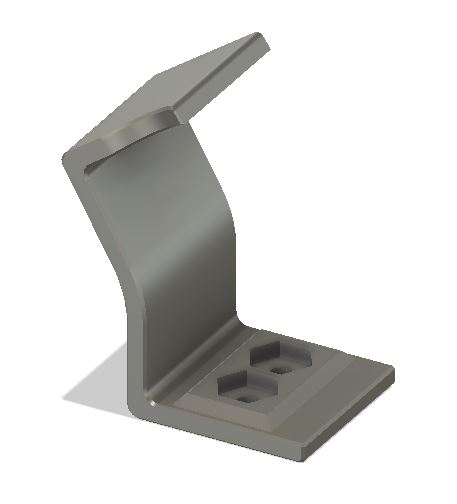

My solution is nothing special. I modeled a bracket that I glued to the side of the trucks.
I glued it with contact cement since I considered it a prototype, but the first version worked well, and the glue is holding. Here is a ZIP file containing both a STEP and a STL versions.
DragChainClip.zip (38.1 KB)
I purchased this drag chain. The selection of this drag chain was pretty random, but I reference it here since the end link of the chain matches the hole spacing on the bracket.
I don’t remember for sure, but I believe you will need to mirror the bracket in the slicer for the “mirror” trucks. It was printed on it side, and I believe I used 50% infill.
