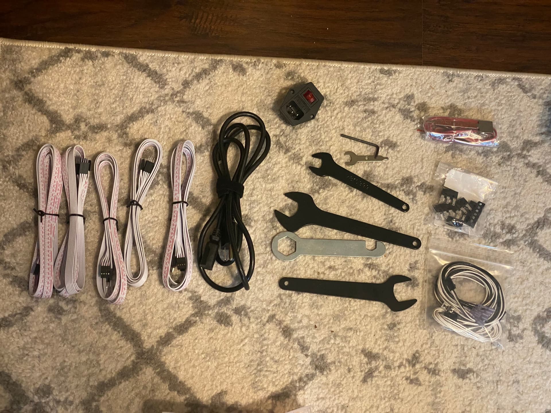

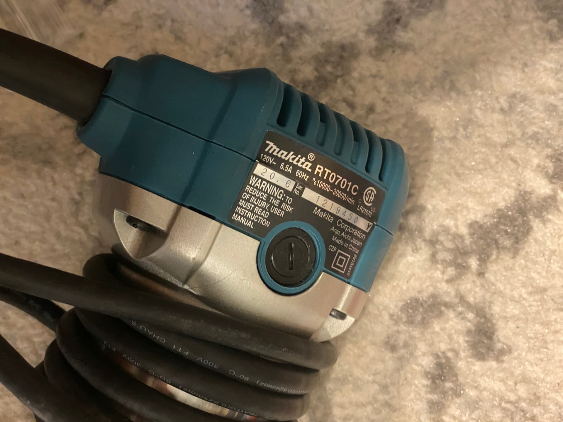

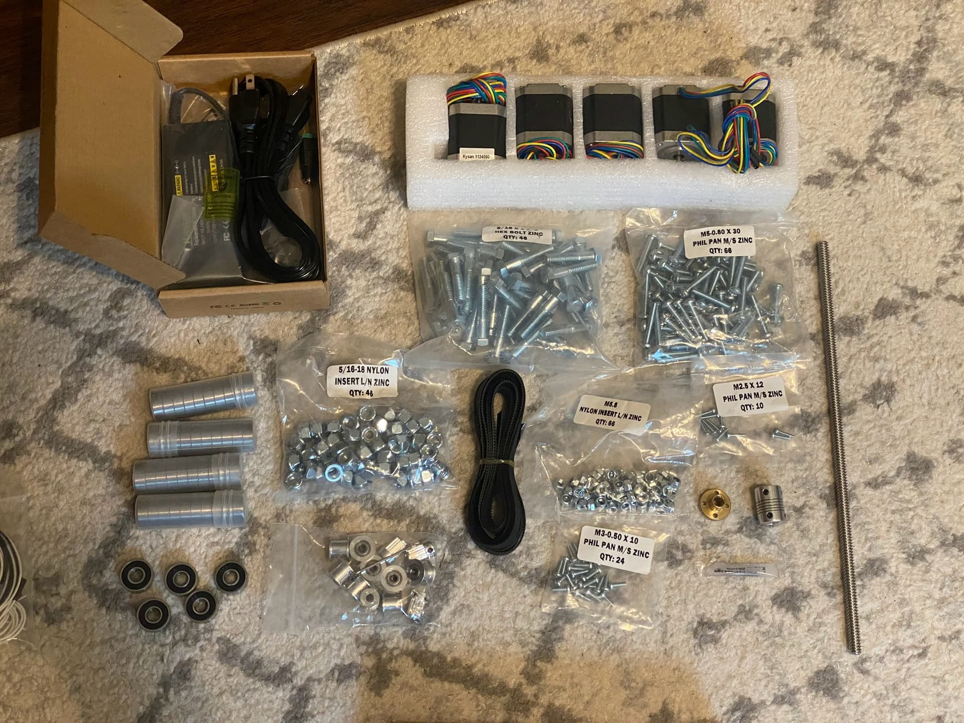

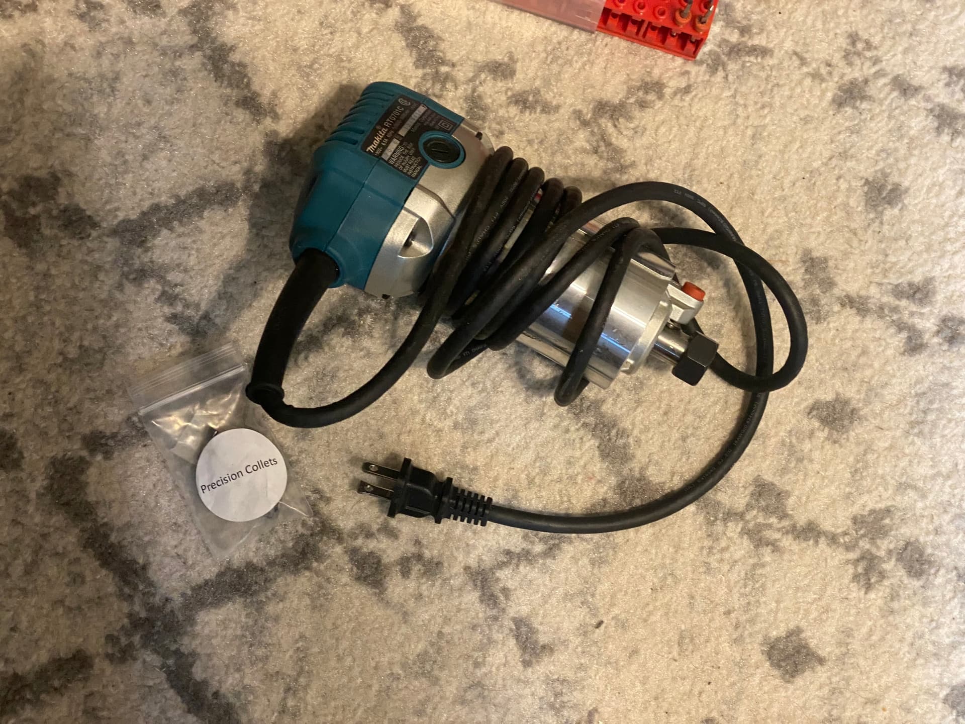

Hello! Everything is new and unused. Unfortunately I had to move to an apartment right after buying all this so I didn’t get a chance to put it together. Here’s a list of the parts and their value:
Primo build kit - $242.99
Tiny touch plate - $8.99
Makita 1/8" collet - $21.50
1/8" Endmill variety pack - $26.25
1/8" Ball End - $3.90
1/8" Single Flute Endmill - $5.40
Power plug - $3.00
LCD Smart Controller - $22.70

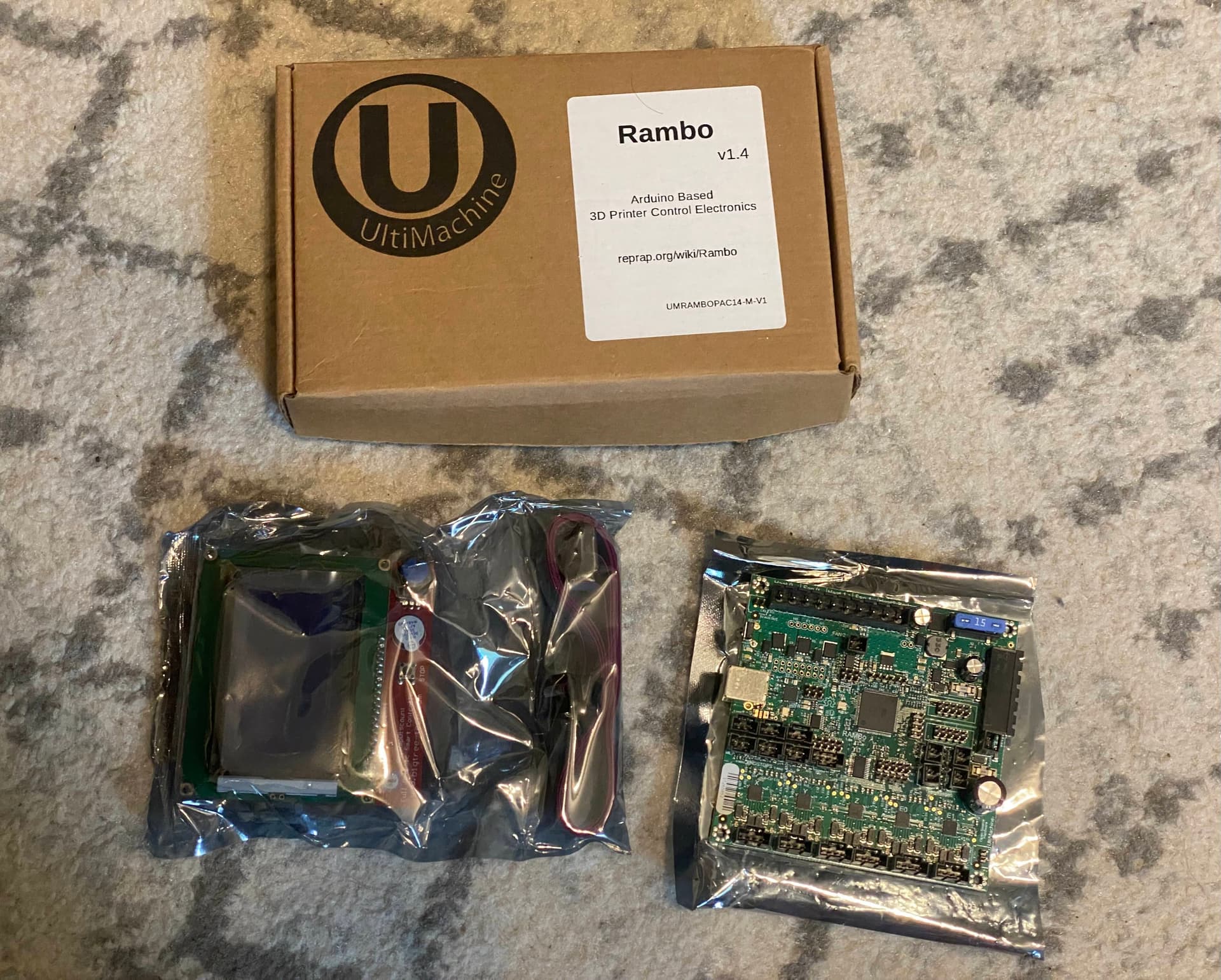

And the controller/router:
Makita RT0701C - $100
UltiMachine RAMBo V1.4 - $150
The total value is about $600. I’m asking $425 shipped in the continental US, or $250 for just the kit and accessories (no Makita/Rambo).

One comment here is that although the Rambo is a very robust board and still has firmware available, it is no longer what we use for most new builds, which are SKR Pro 1.2 or better still the V1 Jackpot board. It also looks to have the Reprap LCD whereas most new builds with SKR/Marlin will use a BTT TFT35 touchscreen instead.
You can absolutely build up a working machine with the Rambo and RepRap LCD- but let this guide your(and anyone else’) assessment of the value of the offered kit.
