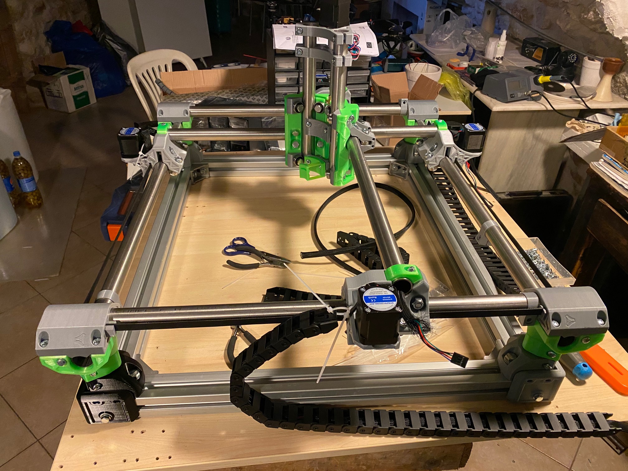

Mpcnc primo almost finished
just finished motor- dual endstop wiring, tried few moves ,it homes ok…so happy untill now
i connected it with pronterface and i get these readings …

do they look ok??? also the Z axis when i press + goes up is that correct???
thanks
and a pic before the wiring
Yes Z+ should go up and Z- should go down.

I just received my kit and about to embark on my build. I like aluminum extrusions you’re using for the base, can you share the details on that?
Also curious what type and dimensions of tubing you’re using, as well as build volume.
510 is the latest. You have 414. DL is for the low rider, D is for the MPCNC.
print area 340 x420mm
the tube lengths are those reccomended…in 25mm outside diameter…
i had few 4040 pieces left from a 3 d printer build so when i see this remix https://www.thingiverse.com/thing:4634236 i like it…Rock solid frame and ithink maybe after i m use to it i will go for extrusion legs as well.
the extrusion lengths were cut according to outside dimensions 720 - 609 ,the tubes could be cut 5-10mm longer but they are ok

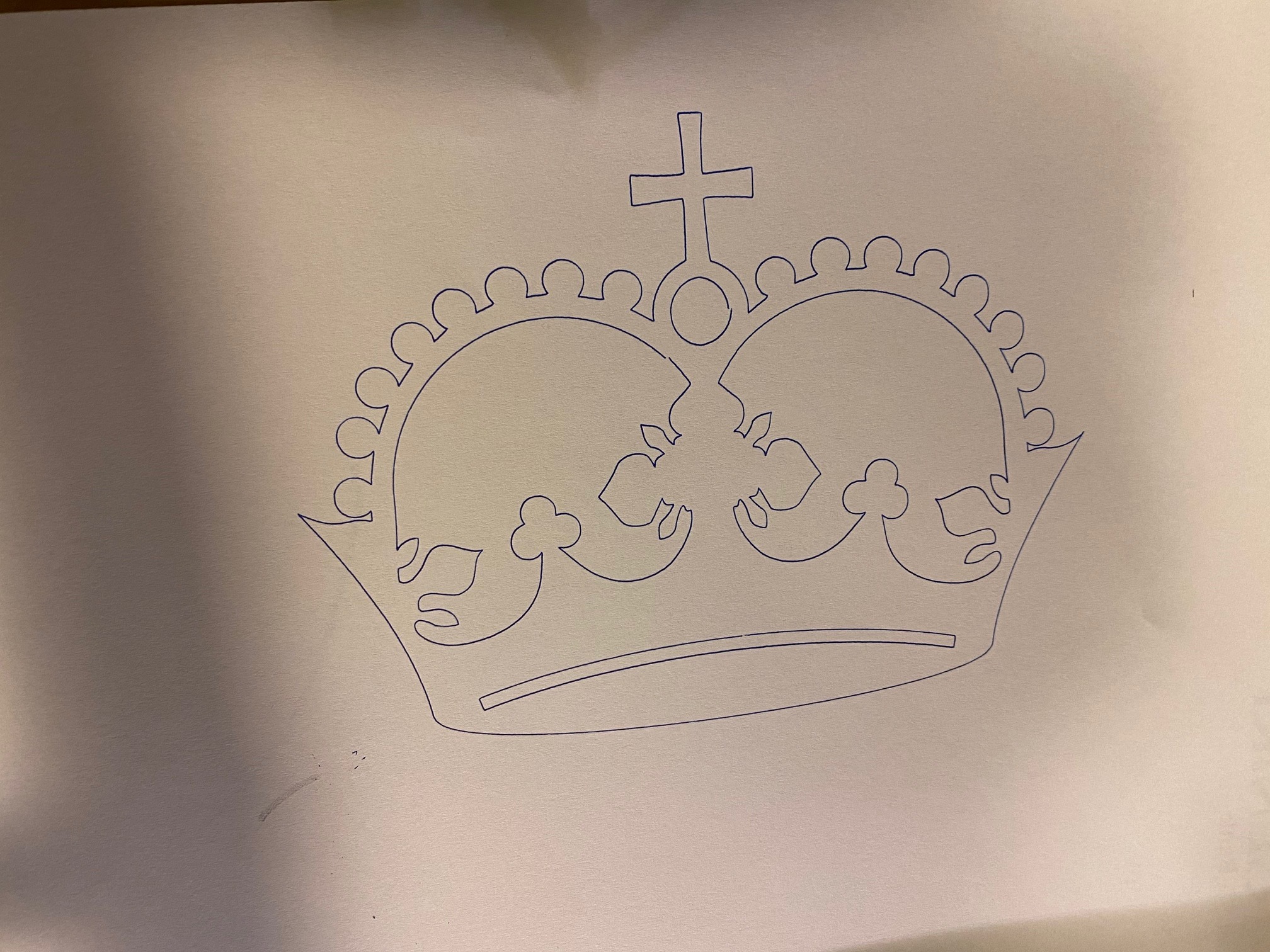

ok first print pen not really stable…
the circle under the cross not really good…probably alittle bit of adjustments and start understanding my new printer…thanks for the help …i foollowed your advice and i used g92 x0 y0 z0 in the begining of the g code file
FWIW, the circle is not a circle in the design. Some places to look closely are the inside corners of the cross, which look ok. And does the circle close, which is close.
The crown is not meant to be a true calibration and test pattern. For one thing, pen and paper holding is most often the cause of little errors like this.
IMO, unless you really have a solid pen and paper mount, I would consider moving on to learn more and make it dirty. The estlcam basics are next, or the milling basics. The router in a properly held piece of wood should be much more rigid
