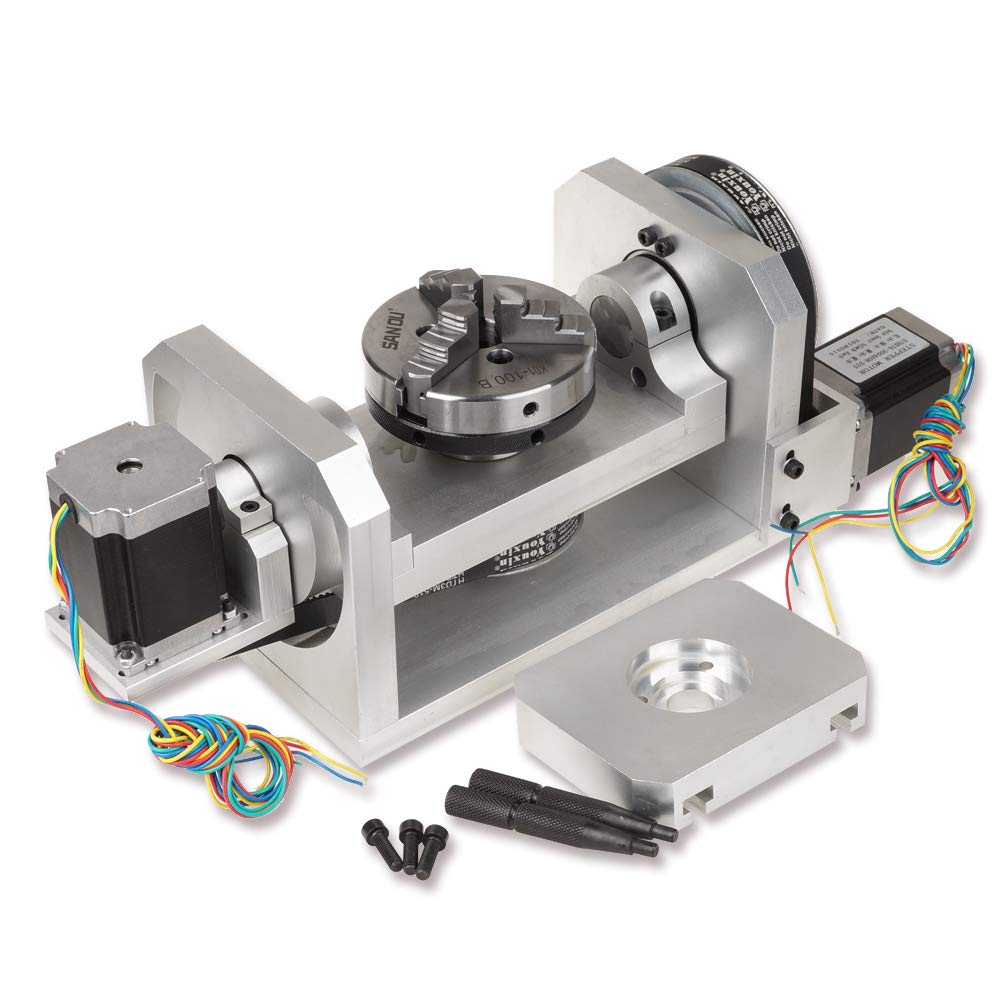

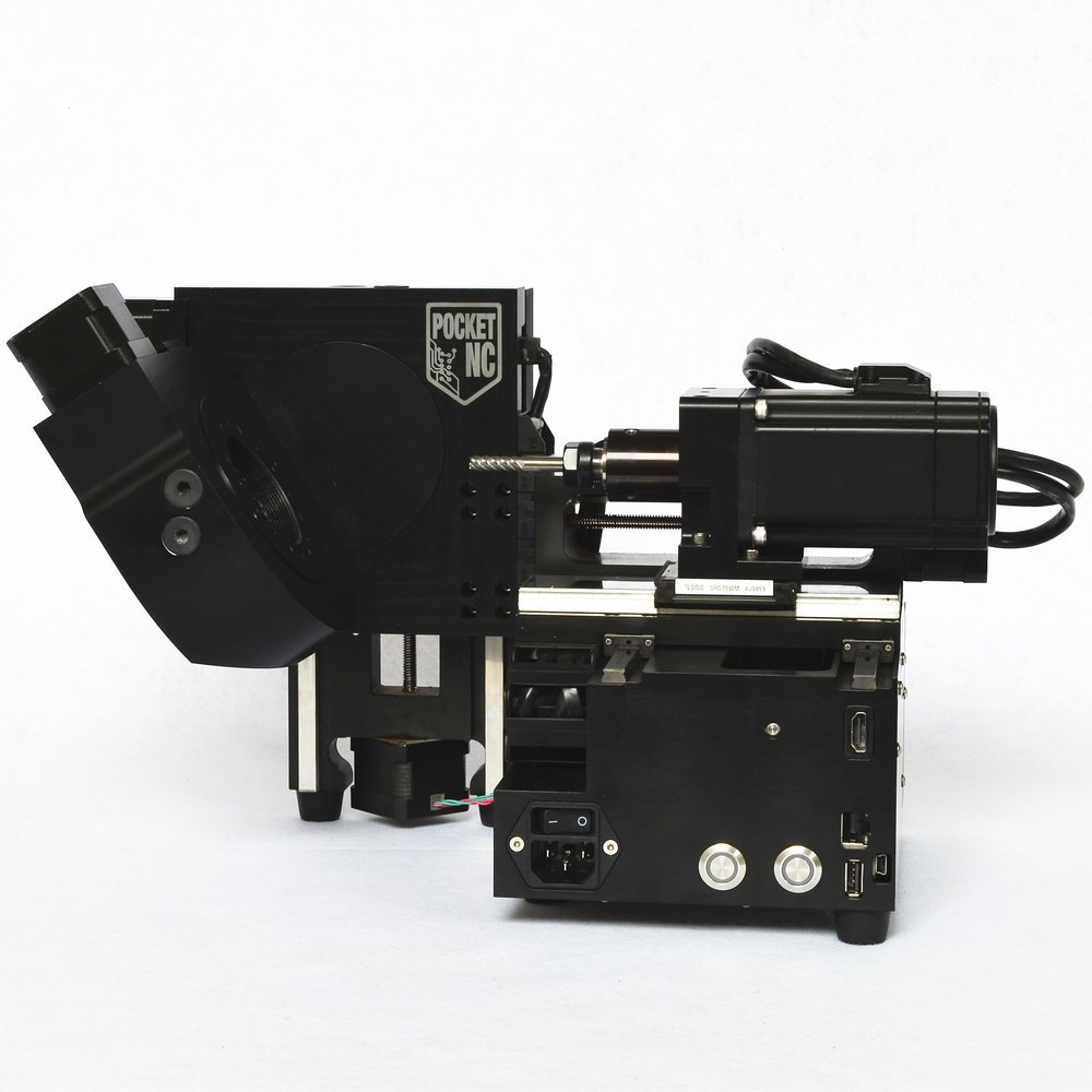

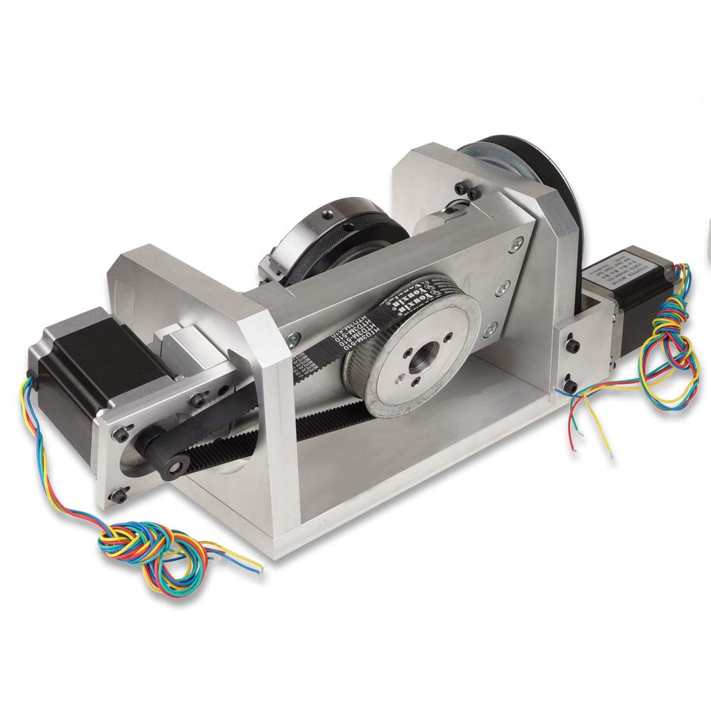

Regarding the Z depth, having an extended cutting arm will multiply the forces on it. To stabilize it will be complex. 3-axis designs choose to make the cutting arm as rigid as possible and move the part/platform. This also simplifies the design. Still trying to figure out a way to go from 3 to 5 axis – portable designs also share this separation. I’m thinking of keeping the X-Y and cutting arm on the gantry and moving the Z-axis to the legs or a platform with 4 independent ball screws.
Due to the number of motors, at least 8, this will require a simpler control method than an all in one board. Maybe an Arduino + off the shelf driver for each motor and then a brain to tie it all together, perhaps the brain can be the control PC or RPi or Beaglebone.
Here are the 5-th axis designs I’ve seen:
[attachment file="_6008134.jpg"]
[attachment file=86018]
[attachment file=86019]
These make sense and alignment can be simplified with computer vision + alignment sensor. See https://www.machinedesign.com/sensors/proximity-sensors-compared-inductive-capacitive-photoelectric-and-ultrasonic for different types. I’m leaning towards ultrasonic
