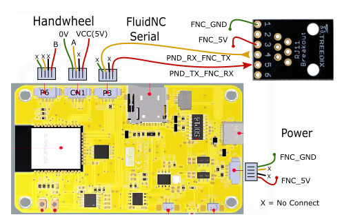

Hello all, bringing this over from here to start a new thread. So I have a Jackpot controller with the FluidNC software (Newest Version) and the CYD (Cheap Yellow Display) version of the pendant as defined here, specifically with the following wiring:
I am using the configuration from Ryan here. I have wired the application using the provided guidlines to the Jackpot like this:
(Note: I am using Ground and 5v connections along with RX/TX)
I have also updated the config.yaml file and restarted the board, the config looks like this:

Try swapping your txd and rxd pins:
  txd_pin: gpio.13
  rxd_pin: gpio.14
Agreed. tx on 14 and rx on 13 is what I have on my Jackpot/JL1/FluidDial setup, works great.
The txd/rxd look backward in the posted config to me (though the wiring may be swapped so that’s a troubleshooting step)

I have the M5 Dial. The config is the same though. Have you double checked your wiring on the 6-pin breakout board? The reason it has NC is the wiring for tx and rx don’t match. Tx from the cyd goes to rx on the Jackpot and the cyd rx goes to the tx on the Jackpot. I had this happen to me when I built my M5 dial.

This is really important to highlight - most of the time we connect
GND —- GND
3V3 —- 3V3
Etc.
But his case we don’t , it isn’t RX——RX It’s.
RX——-TX
TX——-RX
And the pin allocation needs to match the jackpot side.
I built both a M5Dial and a CYD - but am currently only using the CYD since I like the feel of it better.
I’m also thinking your TX/RX wiring is backwards as that seems most likely. I didn’t use the breakout board so I’m not sure what the wiring on that should look like…but that’s what I’d be checking first since your config looks right.
The CYD definitely does NOT go to vmot…only 5v unless you add a regulator in the pendant…I learned that one the hard way. So you’ve got your power wiring correct.

I have the fluid pendant working in the same configuration as you. I’m not at my Lowrider, so I cannot take pictures nor post the config file. But I want to point out, that you have to use the correct build environment for this wiring scheme. For the scheme in the picture the wiki states:
To compile for this wiring, use the cyd_nodebug platformio env.
The standard cyd environment uses other rx/tx pins on the CYD.

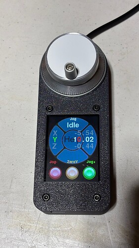

I finally got all the parts for the CYD Pendant. I got it put together and working on my MPCNC. All I did was unplug the M5Dial and plug in the pendant. I didn’t change anything in my config.yaml. Did you get yours working @ahbrown41?
Hey @Britt you motivated me to try it again so I reset Git and pulled the main branch and gave it another go and lo and behold it worked! I wonder if I had modified the PIO file at some point to try to get things working.
How are you liking it vs the M5 version? It is a bit slow but still need to spend some more time with it.
Thanks!
That’s great news. I really like the dial on the pendant. I originally ordered a Resistive CYD, but the circuitry was funky and Mitch and I couldn’t get the touch screen to respond. I ordered a Capacitive CYD that someone mentioned on Discord and it works great.
The dial on the M5 isn’t as responsive as the pendant dial.
In the other thread, you asked this question before this new thread was created, but I can’t find an answer. Which V source is correct?
This diagram is correct. Use the 5V, NOT the VMot for the CYD.

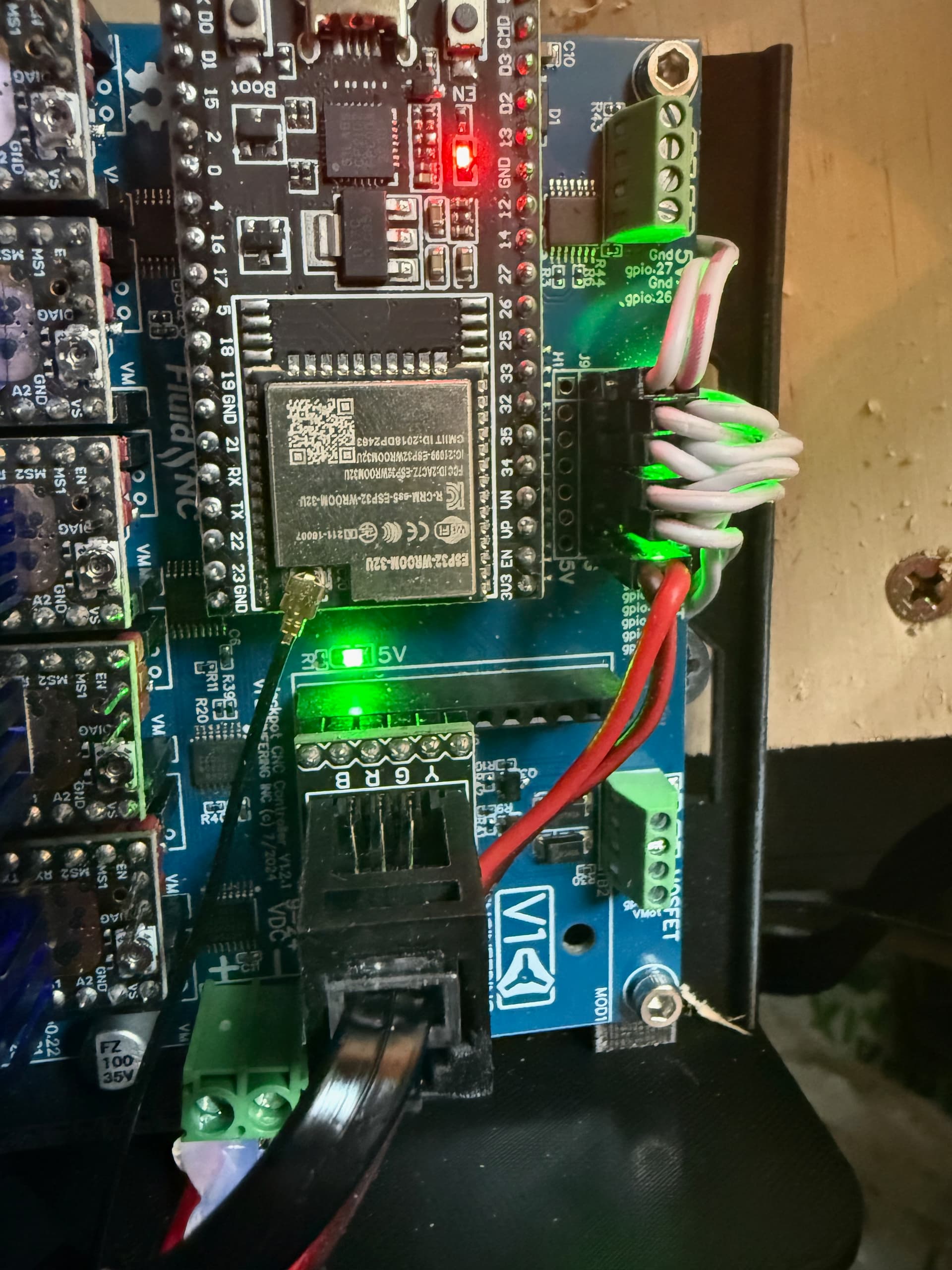

What type of modules are you using for the Jackpot side (The $8 expansion module from Bart is recommended), and for the pendant?
Make sure you’ve wired the TX on the jackpot to the RX on the CYD, and vice versa.
Pictures of your setup will help us help you.
