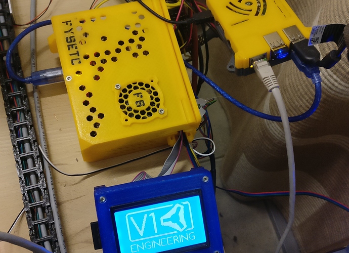

Was a bit productive and made me a new enclosure for the FYSETC F6:
[attachment file=90566]
[attachment file=90567]
[attachment file=90568]
[attachment file=90569]
[attachment file=90570]
Its just great fun having tne MPCNC!
cheers!
Armin
Oh, I like that case for the FYSETC. Is it up on thingiverse yet?
Yes, absolutely!
Cheers
Armin
Thanks!

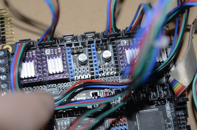

Dear Armin and Jeff (who tried to help me kindly)
I have been trying to configure my fysetc f6 for last few weeks now with no successes so far, may i ask your kind help since i saw your machine is running same setup.
  1. FYSETC f6 m board with marlin 2.0 v1 version
  2. 5X drv8825 current adjusted to 0.9v (5 stepper motors 2A each)
  3. later on i will use extrude motor 1&2 for X1 and Y1 axis.
  4. extrude motor 0 is not in use.
  5. jumpers in 5 motor slots configured to 32 step according to FYSETC wikipage
  6. running marlin 2 (the end stop 32 step version) from v1 github
  7. LCD 12864ZW-10 (same as ender 3 stock display) connected to EXP1 on board.
  8. SD card reader not connected
current status
  1. I can control z x y with reptier-host but not with the LCD panel, LCD ENCODER ROTATE
  2. I have no idea how to make it work for the x1 and y1 as well as configure the endstops.
  3. The X and Y sound strange and seems they rotate much then input value, the Z seems fine.
i am totally unfamiliar with electronics, so please forgive my fundamental lack of knowledge.
Uploading: _DSC9228.JPG… Uploading: _DSC9226.JPG… Uploading: _DSC9225.JPG… Uploading: _DSC9224.JPG… Uploading: _DSC9223.JPG… Uploading: _DSC9221.JPG… Uploading: _DSC9217.JPG…
the encoder is not responding: https://youtu.be/jR0YH7i4sDM
motor wrong response: https://youtu.be/0d_PSt-OBX8 the X and Y sound strange and seems they rotate much then input value, the Z seems fine.
thank you
for some reason i can not load
pictures at once, anyway in this picture jumper for drv8825 on the Z mot, no jumper at E0 (not in use)

Ok! So encoder is not working because you only connected EXP1 (i think) to the display. You need to attach both cables EXP1 and 2!
Cheers
Armin
If you don’t use the autosquare version with 4 independant drivers for x and y and 4 endstops, you need to wire x and x1 motors in line and same with y and y1. Then attach x/x1 to driver on X and y/y1 to driver on y. Ryan has explained that in the buildinstructions.
I personally use autosquare with 5 drivers and direct wiring to each motor. It also takes out slight unsquareness of the xy axis out of the system.
