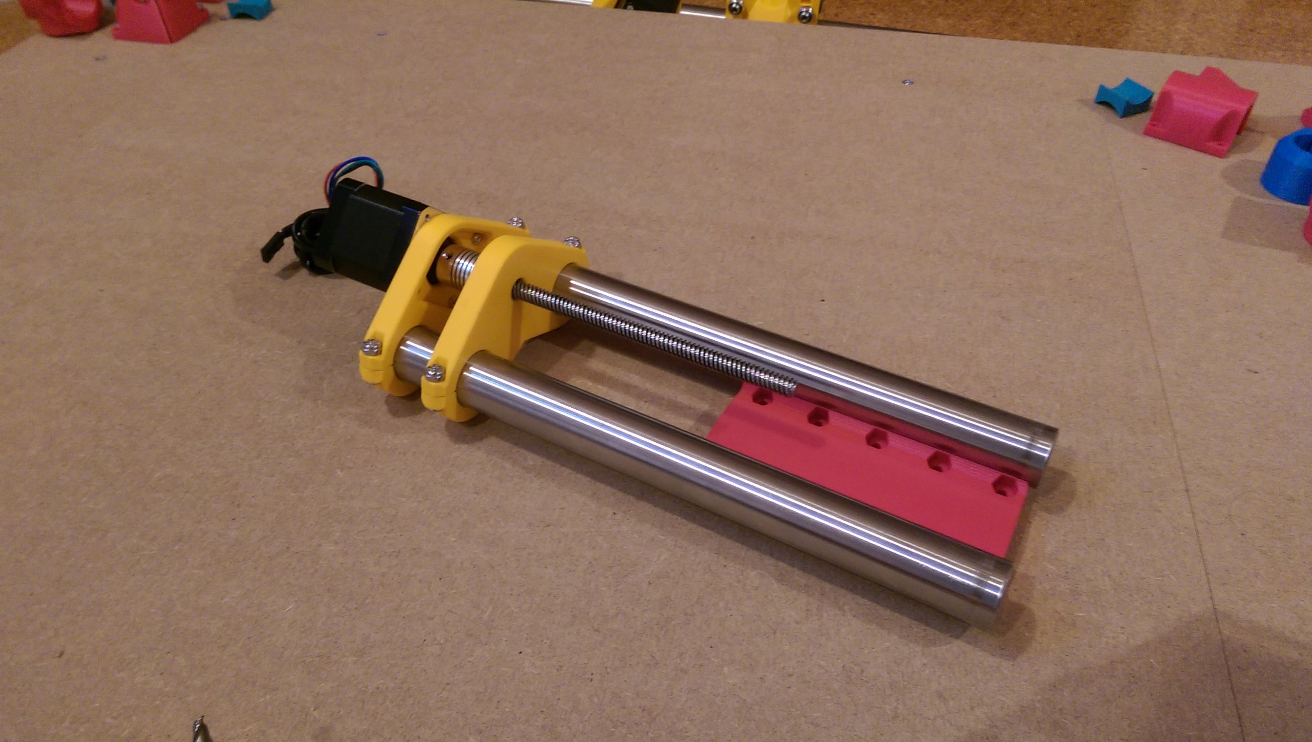

The 6-32 screws and the drag chain finaly arrived last week, so here are some more pictures of my build progress:
[attachment file=72061]
The legs stick through the main plate so that I could lift the entire machine by about 20mm if I ever need some more Z space.
[attachment file=72062]
The bottom_corner and lock_corner parts are solvent welded together witch acetone.
[attachment file=72063]
XY gantry, this was a bit difficult to get square, it’s still 1mm off at 300mm distance…
[attachment file=72064]
Z axis.
[attachment file=72065]
