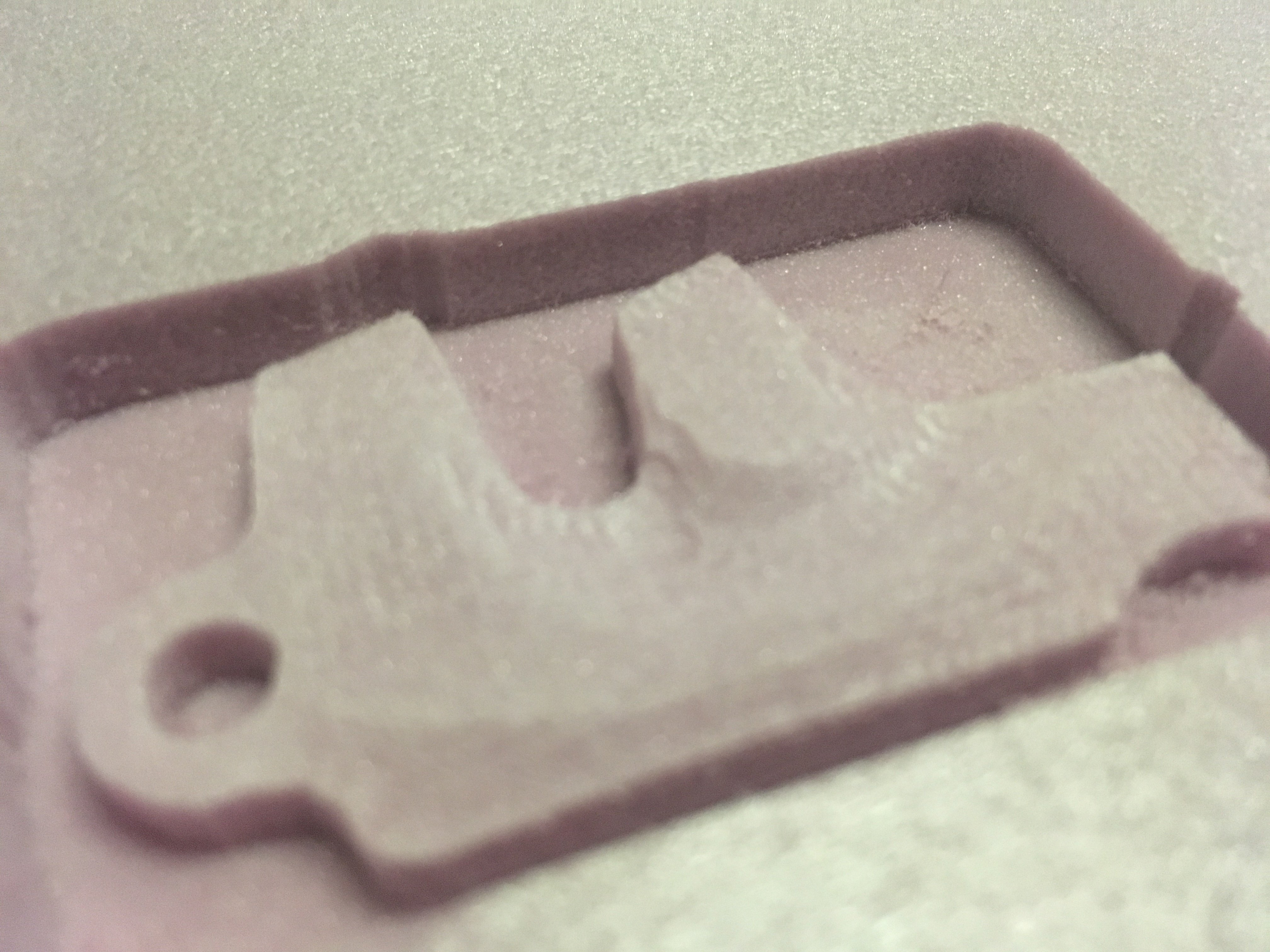

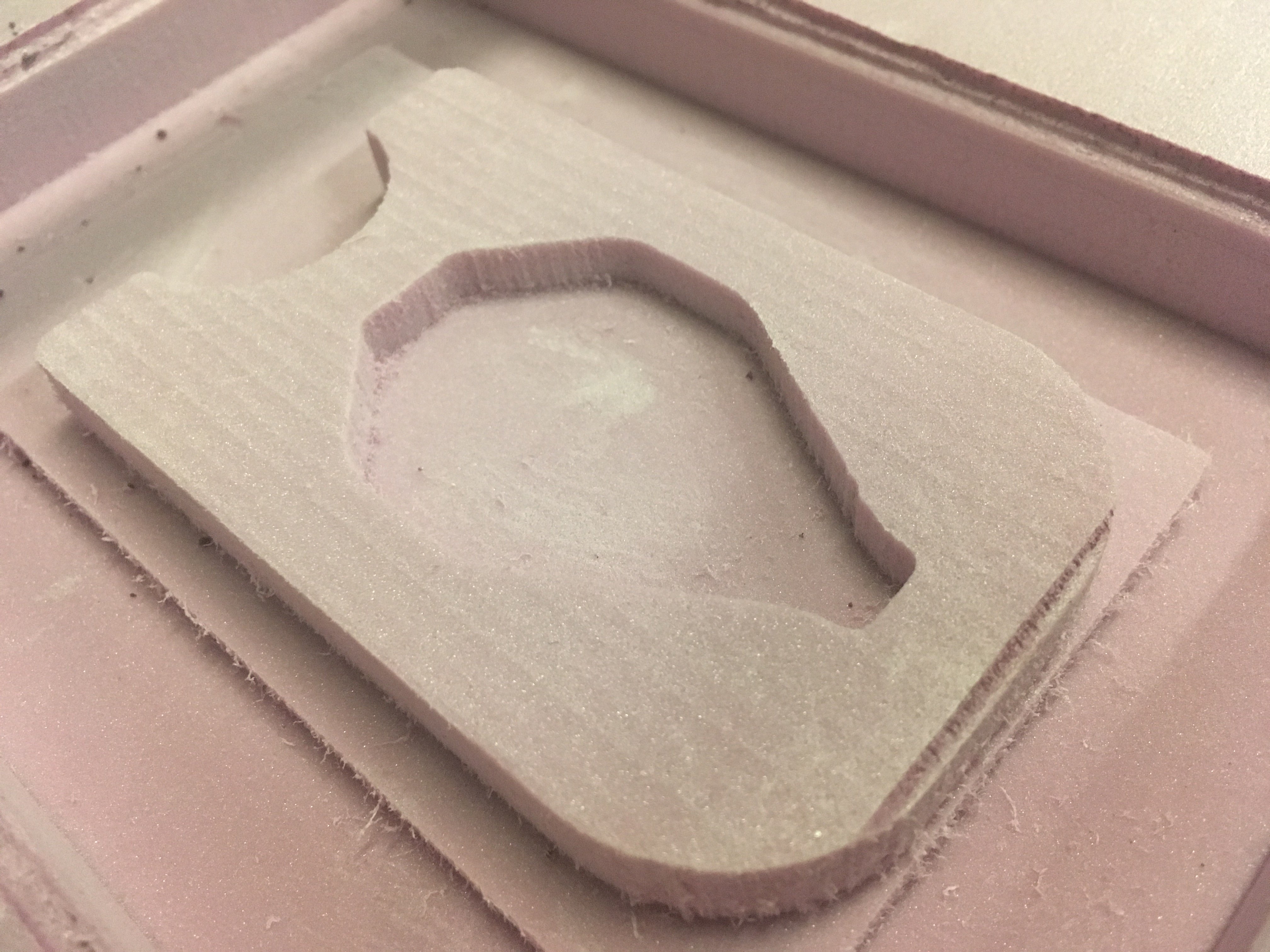

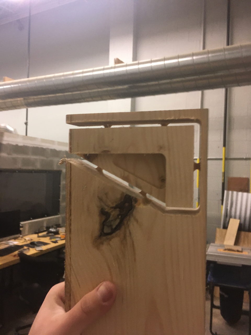

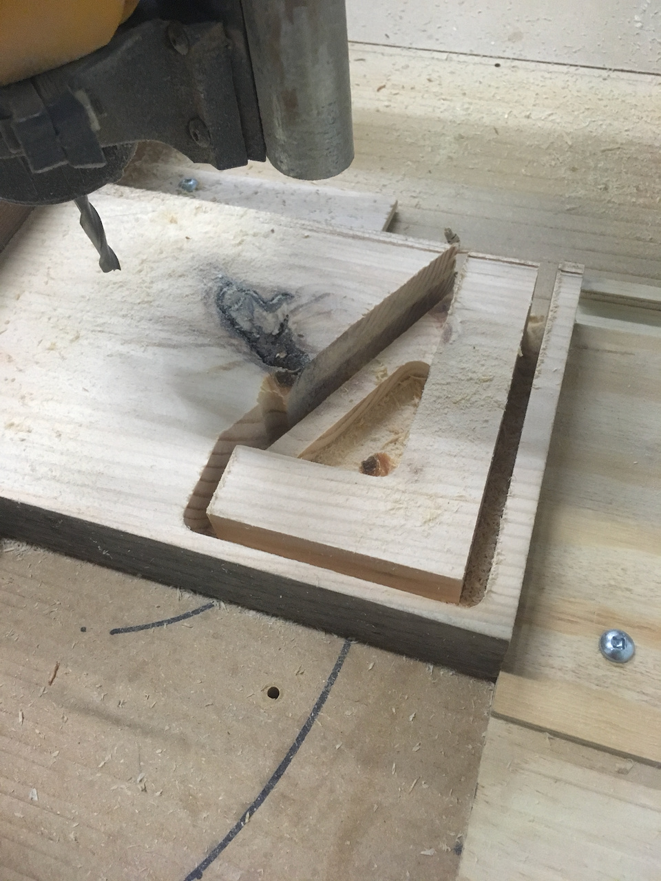

Sample Bracket
This was the first project I did, just a simple bracket I cut out of a pine board with a 1/4" 2 flute cutter. Didn’t really have a purpose in mind when I designed it, but I may use it as a mount for an enclosure. Tolerances were pretty sloppy on it, I soon realized my belts were wayy too loose.

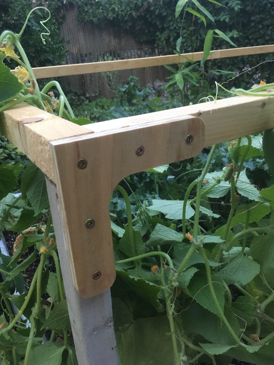

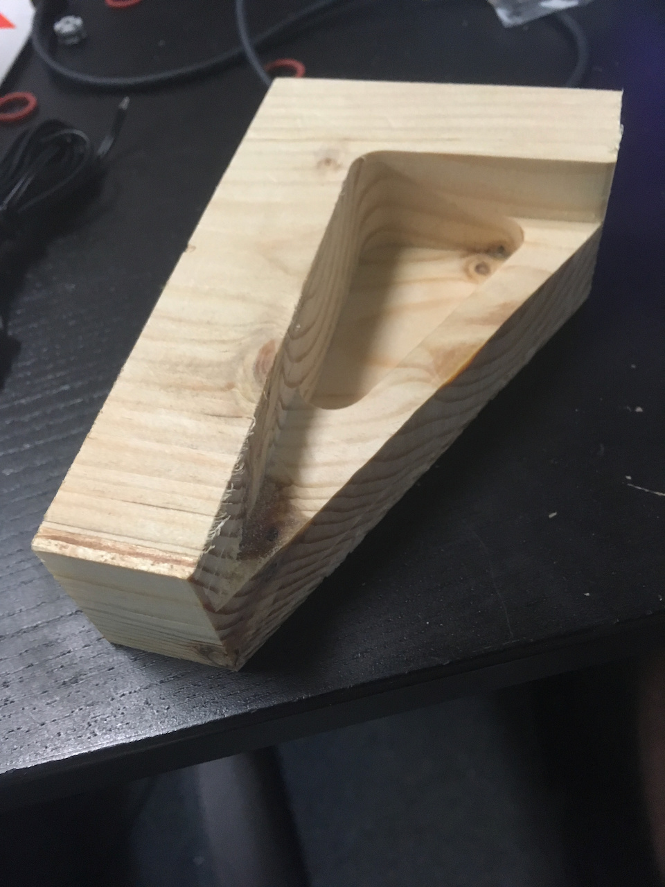

Garden Gussets
With the winter retreating, I decided to build a vegetable garden on the back deck of the house. I made the whole thing from scrap materials, and used the MPCNC to make these rounded gussets. Tool was a 1/8th endmill.

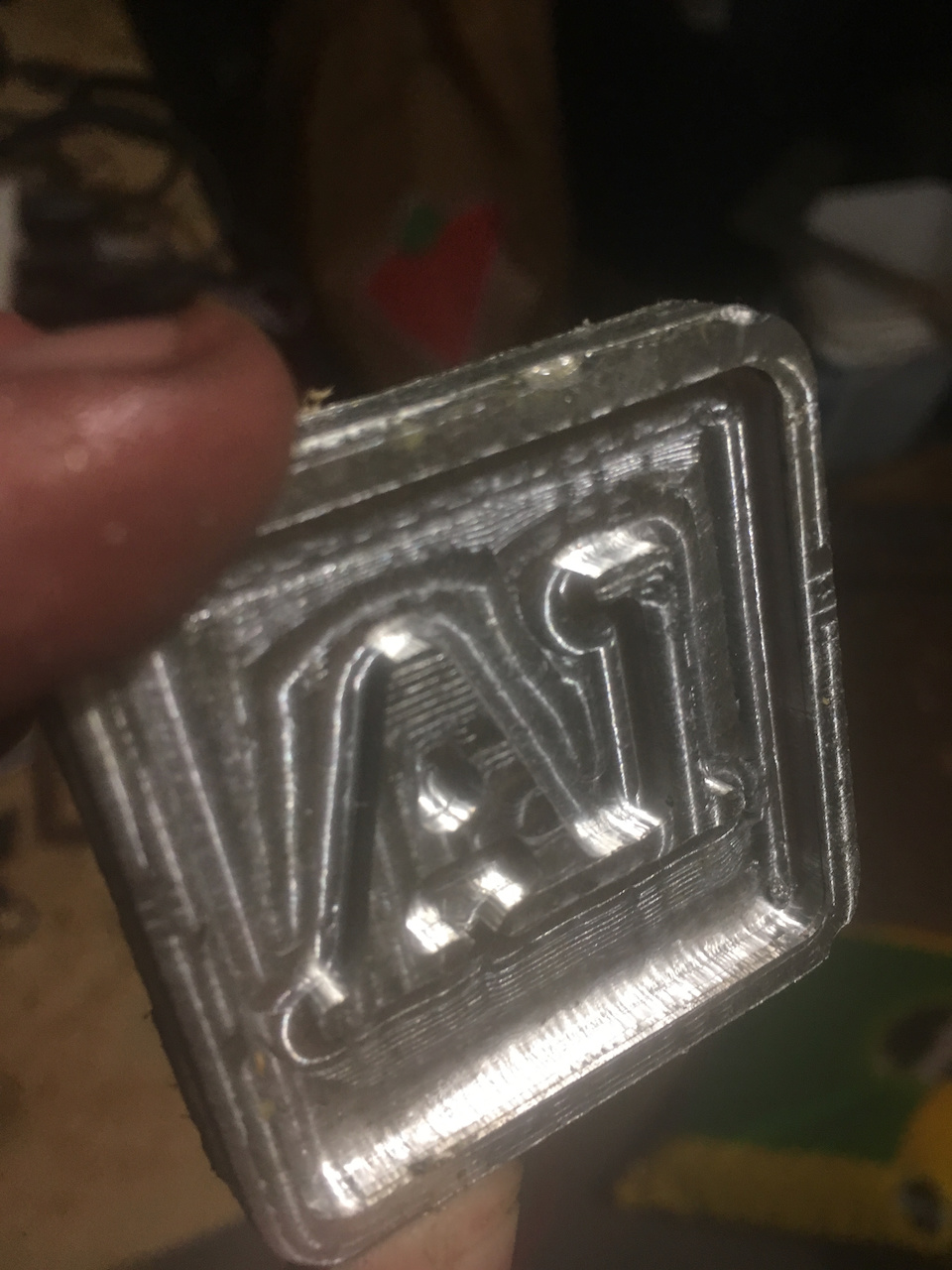

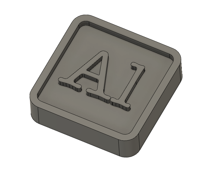

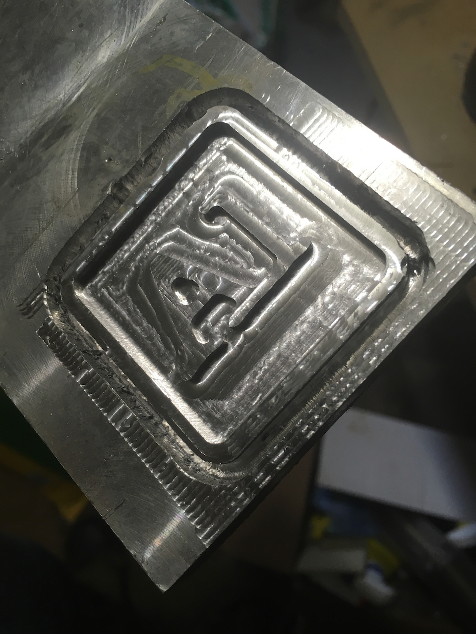

Aluminum
This was a tough one. I designed a simple little widget to test out, and in fusion used a facing, adaptive clearing, and finally a contour operation with a 1/8th single flute cutter. The facing went ok, but the endmill broke very soon into the adaptive pass during the first pocket. I dropped my feed and DOC and managed to get pretty good results with the next attempt, until the endmill got gummed up on the deep contour. Definitely should have added some roughing passes. At that point I was all out of endmills, so I cleaned the part up and freed it from the stock by facing the other side using my shaper. All in all it turned out rough, but I don’t think it was too bad for a bumbled first-attempt.
Not bad! Those are some very promising results for a first run through aluminum! That gives me more confidence to give it a try.
It is really gooey to machine though, depending on the alloy. Did you spritz it with WD-40? That’s actually a decent lubricant for aluminum. Also if I were planning on cutting aluminum I would order some specific bits. I can’t remember the kind off the top of my head, but I know there are some flute types and coatings that work, and some that just don’t.
Also, what kind of shape have you got?! Those are cool! :grinning:
Yeah I was beside it the whole time spritzing it with Wd-40 every few seconds. From what I know single flute is the one to choose for aluminum. I haven’t tried aluminum since, I wanna add rigidity to the machine, and maybe a compressed air blower to help clear the chips before I try it again.

Those are great results. Your machine is somewhat tall, and you may have more success if you prop up the workpiece so you are working near the maximum Z.
You should be able to feel/see a difference in stiffness with the tool near the top vs. near the bottom of Z travel.
Yup, Frame stiffeners and a platform to bring the workpiece closer are definitely on my to-do list. Even with the height I’m impressed with the rigidity.
