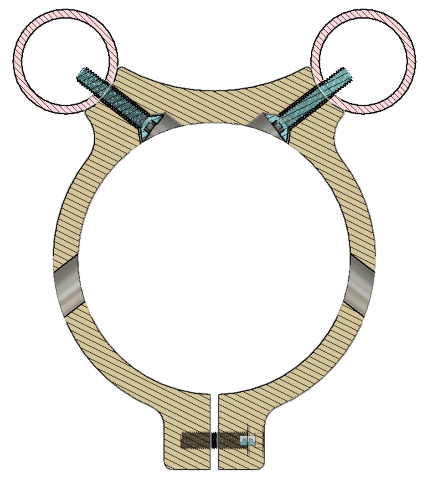

    – No tool mount plate for the spindle, instead I made parts out of aluminum that hold directly the Makita as close as possible to the z-axis (see pictures) and keep the z-axis extremely rigid. Basically this part here out of 25mm Al: https://www.thingiverse.com/thing:2114351

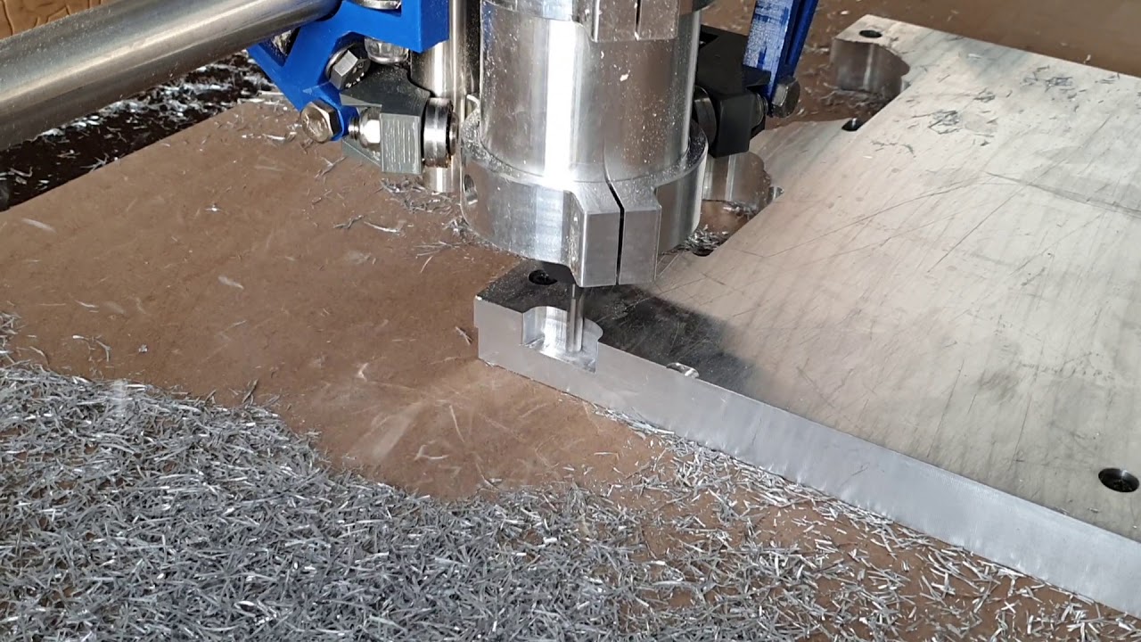

After I finished the aluminum Makita holder with another CNC machine I wanted to try aluminum also on my MPCNC and I’m quite happy with the results. I used 600mm/min, 30000rpm, 0.6mm WOC, 12.5mm DOC, 6mm single flute end mill. There was some chatter and I could feel the vibrations in the z axis but not so much in the cross of the axes. Maybe 12.5mm DOC was too much, with 8 mm DOC it was better. After a finish pass the surface looked quite reasonable.

  • Aluminum: 6mm single flute, 30000rpm, 0.6mm WOC, 12.5mm DOC, 600mm/min

Impressive! Love those aluminum chips! 608 bearings are only 7mm wide right? So i suppose you have a small spacer somewhere to fit the 15mm belt?
Yes they are 7mm wide. There is a spacer included in the rollerplates on both sides to have the right clearance for the belts.
Okay so If you see me say anything that is incorrect regarding this stuff you have to ignore it and act like I am right! (kidding, glad to have some assumption checking).
Well that is one heck of a first post! Welcome to the crew!
I am absolutely floored with your projects and that Aluminum is insanely thick. WOW

But actually the idea has grown during the working time. I had a discussion with our engineers how much this machine can do. Most had the feeling it might cut wood but were worried about the dimension accuracy. And none believed it can really cut aluminum within reasonable time and will rather “file” the metal. At this point I was triggered and had the feeling that the MPCNC is somehow a nice optimization problem (that physicists love to solve). :wink:
@peter: Due to a lack of time I didn’t start with the unmodified MPCNC, unfortunately. The corners looked to me more stable but it might not be a difference to the original ones if you have this small z travel. Maybe with this corners it’s easier to get some tension on the 15mm GT2 belt which I just bought because it’s not so expensive (from china) and I could not see any disadvantages except that you need more filament for the belt clamps.
What I can not recommend is the use of a spindle holder with this two small rings like (https://www.thingiverse.com/thing:2114351) because it does not keep the z-axis as rigid as the tool mount plate does. Better use a tool mount with the full length of the motor body or something out of wood or metal. For me the solution with aluminium was cool because this Makita motor is quite thick and this way I could keep it really close to the z-axis.
I have milled the tool mount on another CNC but with the experience now I would say it can be milled on the mpcnc. With the parameters I used so far for 25mm thick aluminum Fusion estimates ~35min for the center and another 45-60min to cut the outside. The holes were done later on a drill press (first end mill for a flat surface, then spot drill and normal drill), then cut with a saw in the front. To have the right orientation for the holes I made lines on the surface:

Mich wĂĽrde interessieren wie die Alu Halterung(en) der Spindel befestigt wurden / werden.
Danke vorab :wink:
@chattermark Wish I had the Idea with the threaded holes before… :see_no_evil: Sometimes this would be very helpful.
@ben78 Dann am besten direkt loslegen! :wink: The holders are fixed to the z-axis with m4 countersunk screws. The counterbore was the most difficult part in terms of available tools. I used a long 10mm spot drill. Inside the tubes there is the usual setup with the nut trap and M4 nuts.
