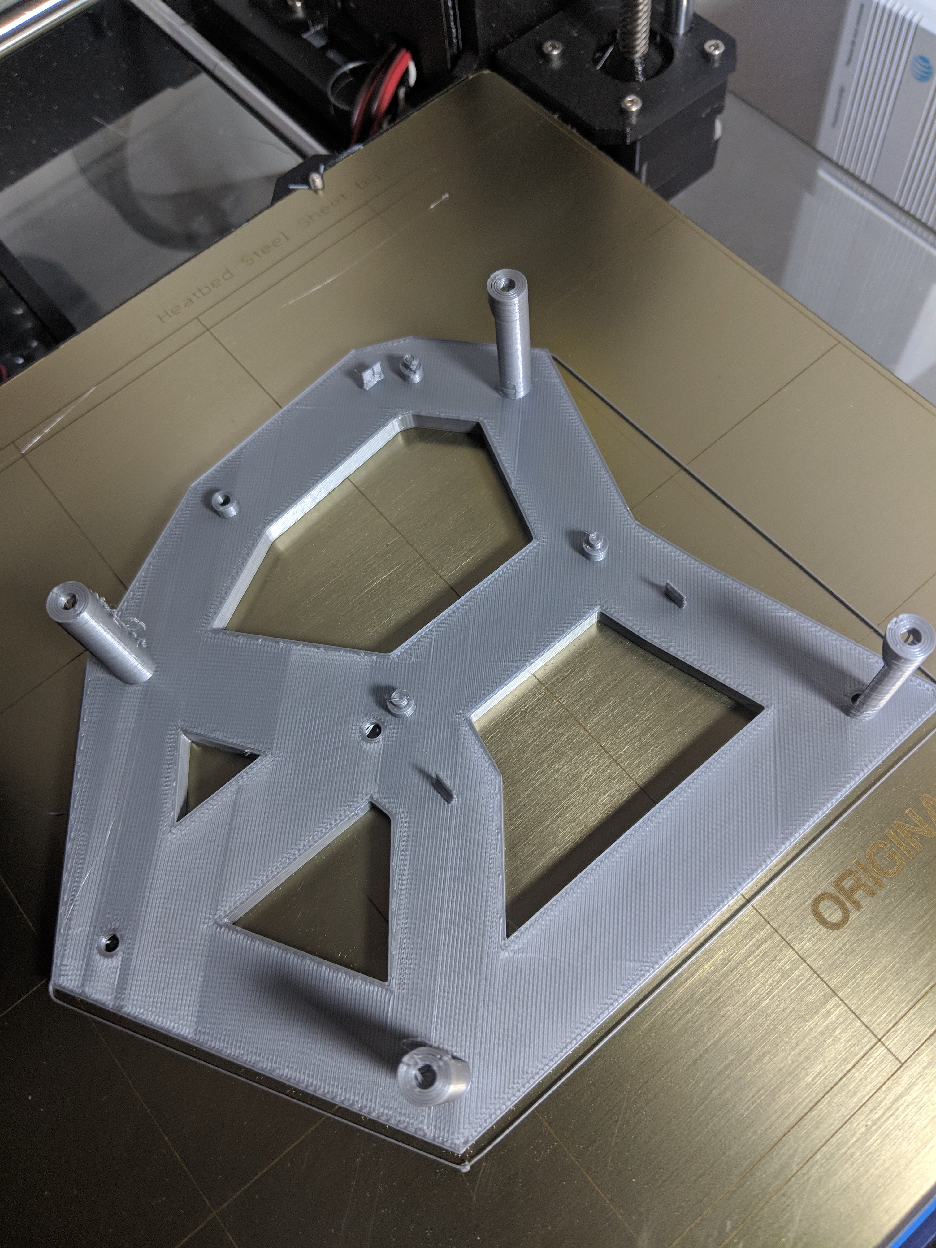

Today, I started working on designing a case for the electronics. I haven’t tackled auto-squaring end-stops yet, but that won’t really affect how I design the case.
I spent the day measuring my RAMBo, LCD, and Raspberry Pi, and transferring all of that in to Fusion 360. I printed a few layers of bits and pieces to make sure all my screw holes lined up and everything was laid out properly.
Oh, and I made a thing to “route” light from the status LEDs through some acrylic rod to the outside of my case, just like an edge-lit sign. https://www.thingiverse.com/thing:2945100
No way. I don’t even like to let my MK3 run overnight, and that fancy hot glue gun on a robot arm is way less scary than my DW660.
Prototyping my electronics case w/ edge-lit acrylic rod on the status LEDs
RAMBo on the top bunk, Raspberry Pi & 12v to 5v regulator on the bottom bunk

Naked prototype, to make sure all the holes and standoffs line up
[attachment file=61223]

My rebuilt case prototype, with a case fan at (what will become) the top.
[attachment file=61405]
I chose the fan because it had a mechanical drawing. It was wrong.
[attachment file=61406]
