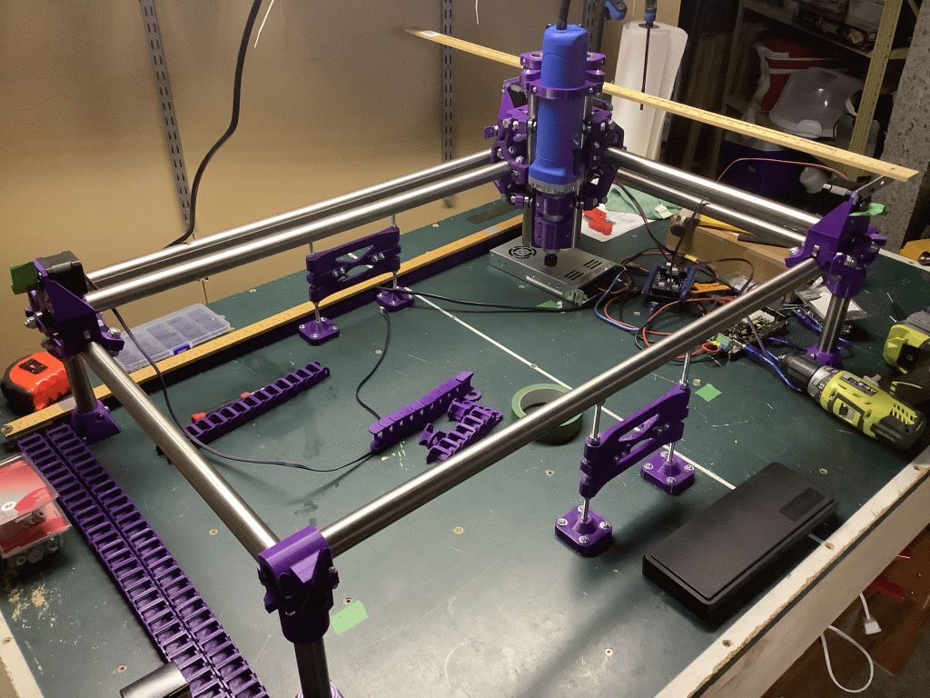

Interesting, and thanks. I installed some X rail supports as we hope to dabble in some aluminum plate one day, so can’t put material in from the X or long side. Have to go in from Y or short side, or down from the top.
But, another question comes to mind. Using limit switches to square the machine, does the squareness wander as it moves to the other extreme? In other words, is it better to be cutting nearest to the point the auto square is achieved?
Plan is to call this location home, and work opposite corner, nearest camera.
I’ve not seen the structure between the rail supports before. Square should be the same across the whole cutting area. Some folks have issues getting the frame perfectly square. The dual endstop firmware helps with this by homing both ends separately and allowing them to be adjusted independently.
All the 3d printing was done last March and April. We assembled it early Aug after re-purposing a portion of ping pong table… As we were assembling, we went looking for those mid span supports and I could not find them. It’s really two threaded rod supporting the X axis from below to eliminate sag, if any, but I figured it might add some stiffness against sway too.
That looks like a very high Z axis. I would be worried about it not being rigid at that much height.
