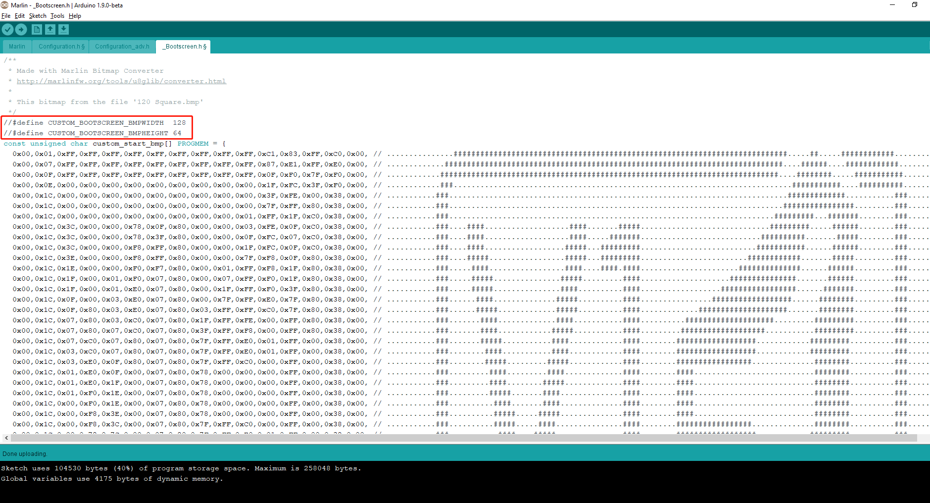

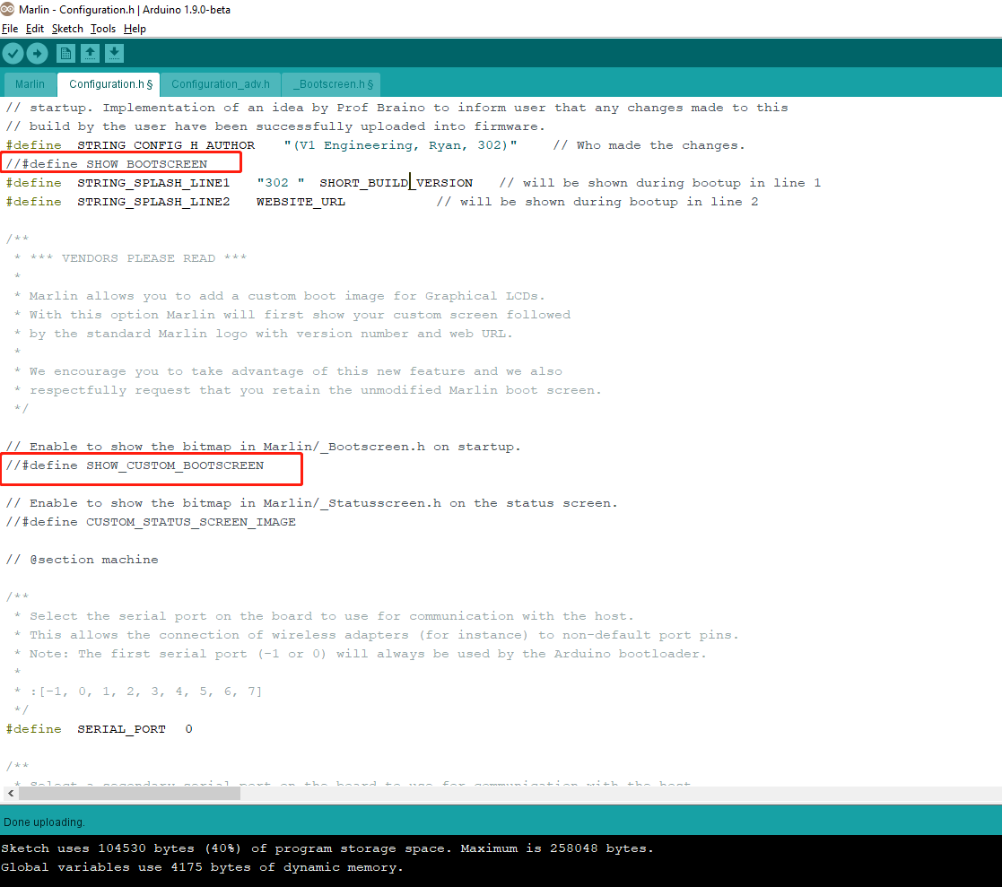

Ok, I just tried on my computer, the issue seems to be because the custom welcome screen is enabled.
So you just have to go to line number 92 and change from this:
// Enable to show the bitmap in Marlin/_Bootscreen.h on startup.
#define SHOW_CUSTOM_BOOTSCREEN
// Enable to show the bitmap in Marlin/_Statusscreen.h on the status screen.
#define CUSTOM_STATUS_SCREEN_IMAGE
To this:
//#define SHOW_CUSTOM_BOOTSCREEN
//#define CUSTOM_STATUS_SCREEN_IMAGE
Basically make sure those two options are disabled. Marlin tried to load and display the vicious1 logo at startup on your screen, but the screen is just too small to display it so that cannot work!
It should compile fine after that. At least it worked fine for me. :slight_smile:
Next time, pro tip: the errors are displayed in orange at the bottom of the Arduino IDE. You can scroll up to see the full error report or enlarge the error message zone by dragging up the separator, then try to read what this is telling you. Then , copy the parameter it’s telling you causes problems, and use the Edit–>find function to directly see where it is in your code. Not sure if my explanation is very clear, but don’t be afraid to use this thing, Marlin is actually very easy to edit and work with once you get it.
I checked my report. Indeed it was a bootscreen error. Problem solved in 5 minutes after reading your message.
So i just disable it and now it works smoothly. I think i am going to add an extra endstop for Z.
Some screen shot for those who need it.
[attachment file=“Bootscreen3.jpg”]
[attachment file=“Bootscreen2.png”]
[attachment file=“bootscreen.png”]

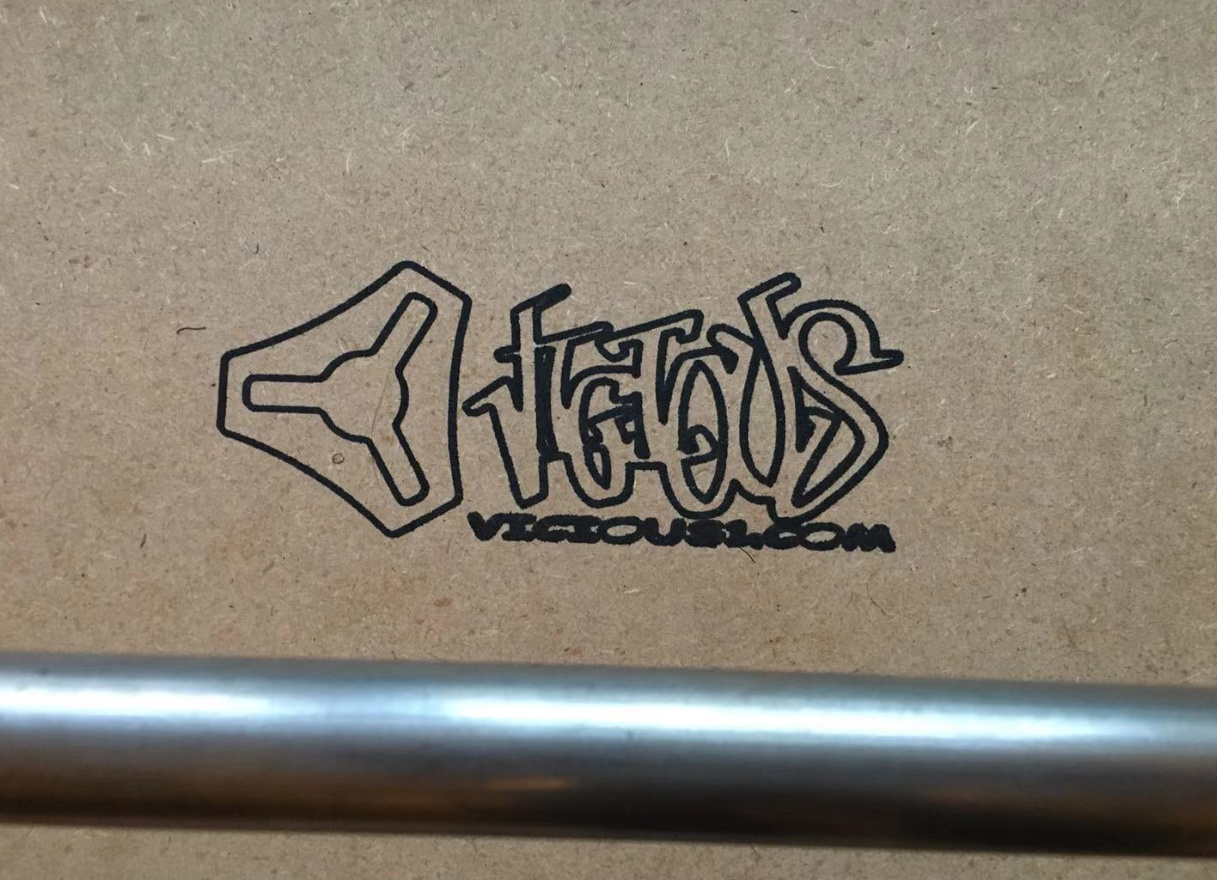

Final result.
[attachment file=79985]
I bought a cheap box to put everything in quickly the time to mill some nice parts for it.
[attachment file=“79986”]
and a logo just to make sure everything work smoothly.
[attachment file=79987]
