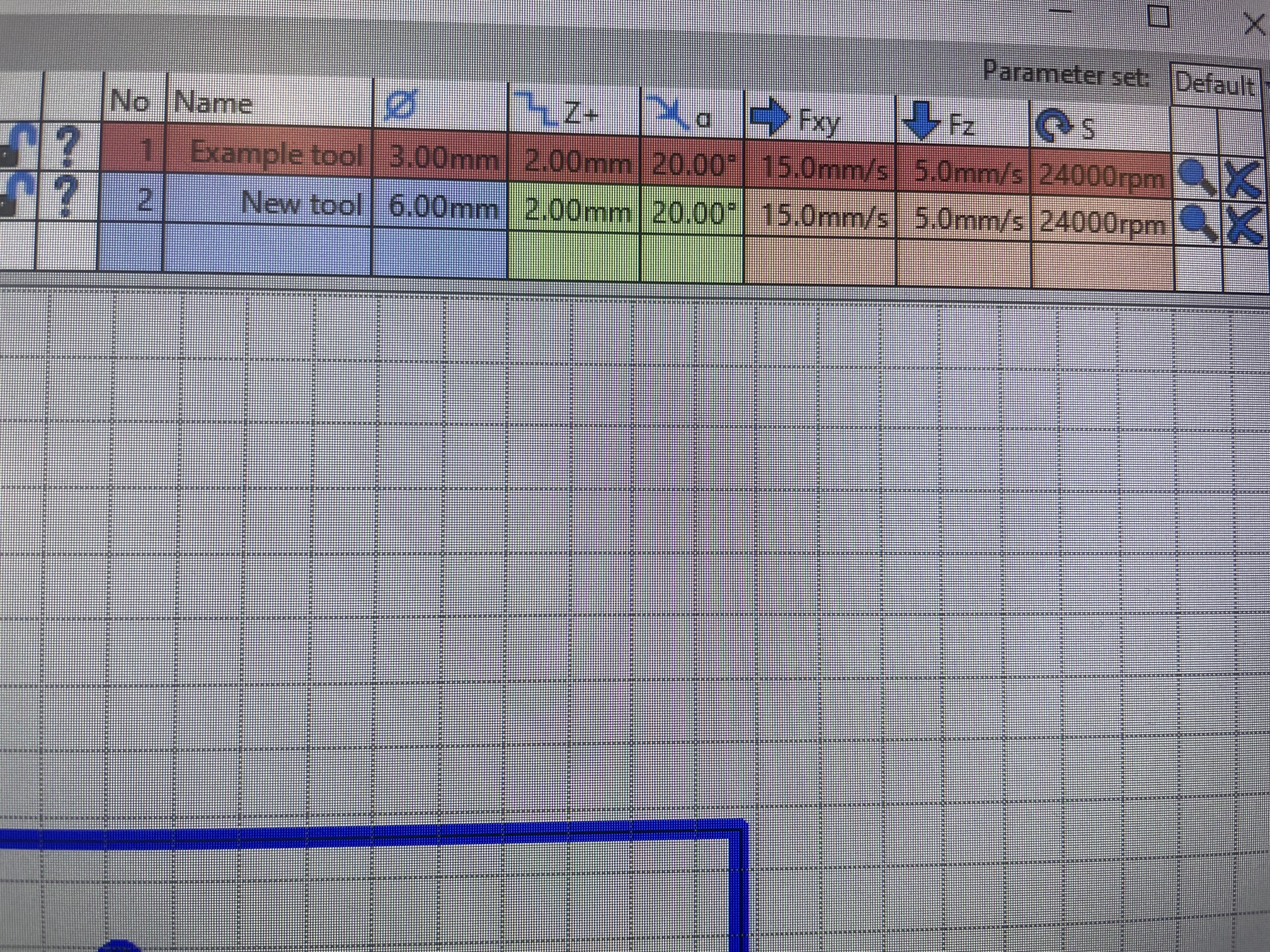

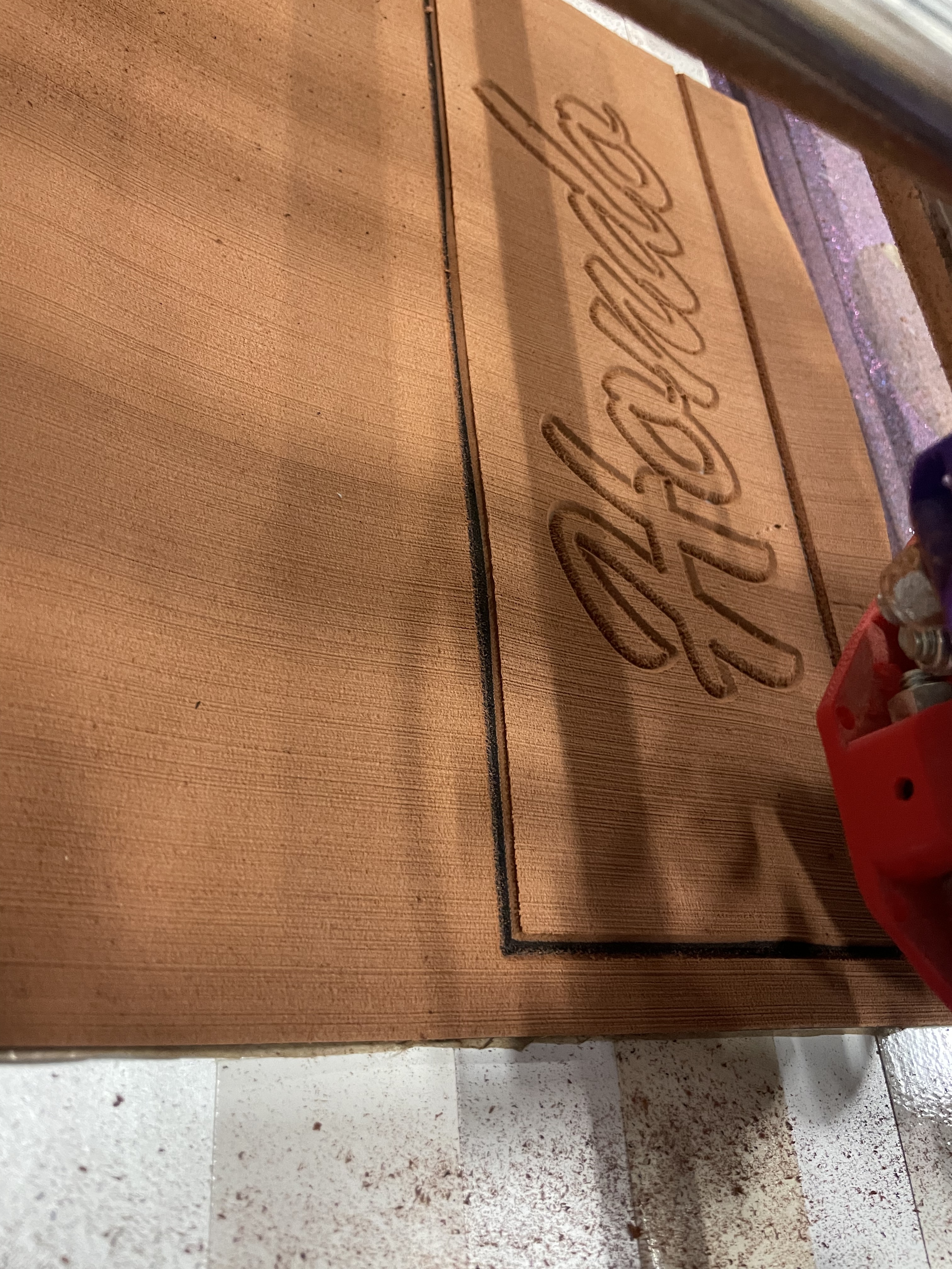

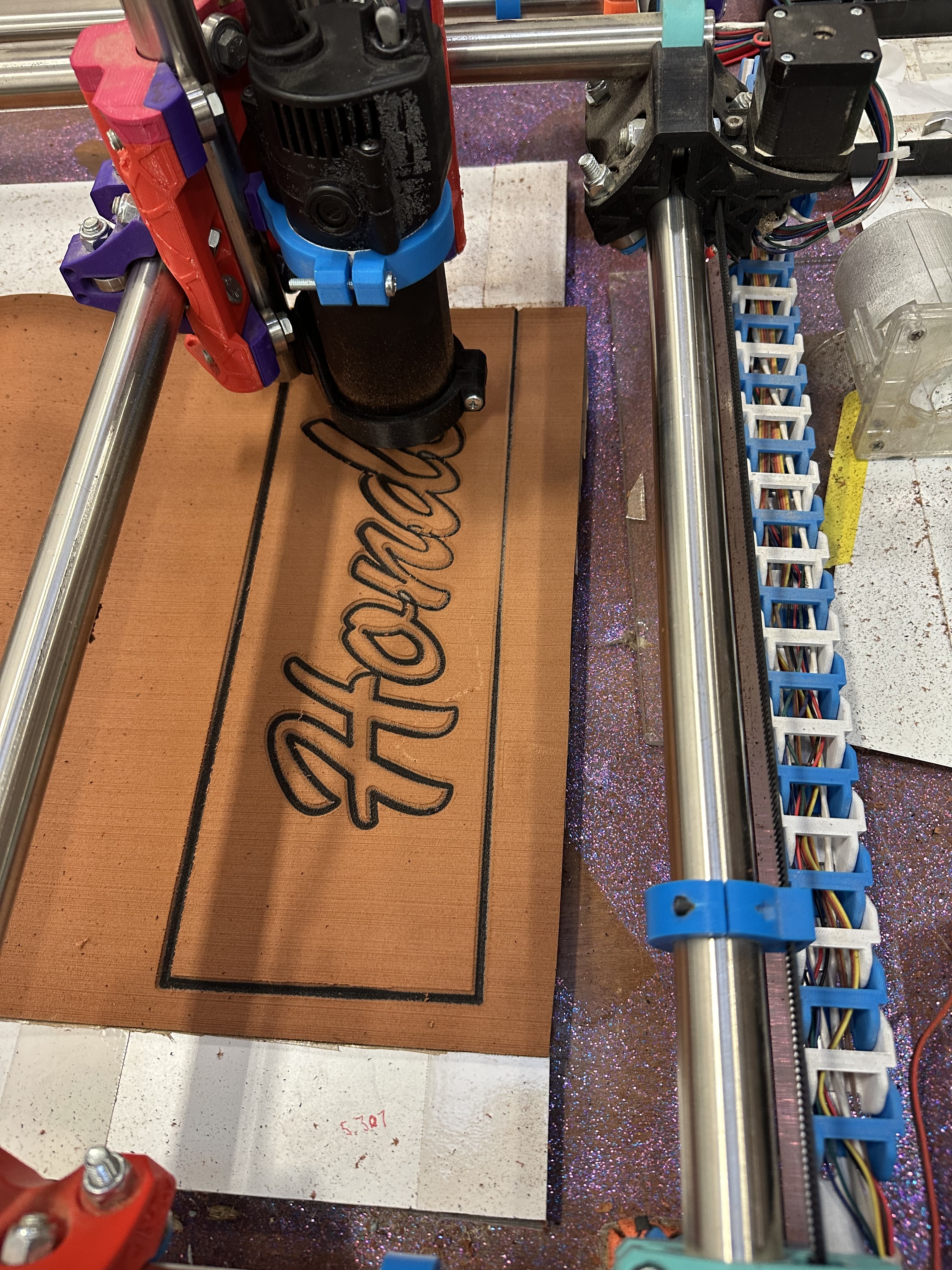

Anyways the project was done using free cad rc. And I downloaded a font to use in freecad. Then I exported as dxf to estlcam. Set my speeds and feeds and figured out my workspace. A nice fellow in here helped me with my start code bc I was inept. Then it was off to the races. I really love the dual end stops bc I am using a cheapo v bit for carving and I want to get my doc just right. So I usually go on the conservative side and go shallow see how it is and then add more. And in this case it has worked well so far. Started with 3 as the top brown color is 2 mm thick. But it wasn’t showing the contrast I wanted well me and the person who’s stomp pad it is ( he is actually our QA guy so I gotta be good I guess lol) so I went to 3.5 doc and I still don’t quite like it. We are going to try 4 mm on the lettering doc I believe I did 4.5 on the border. It’s so nice to be able to let it go and finish, then look and decide if you need more with it perfectly going back to the job. Anyways just a silly project for a buddy at works drag boat he is building. I made the placards for it as well and we wanted the lettering to match so it looks sharp.
The bit is the cheap v 1/4” shank bit that came free with my router.
