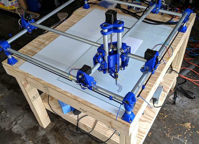

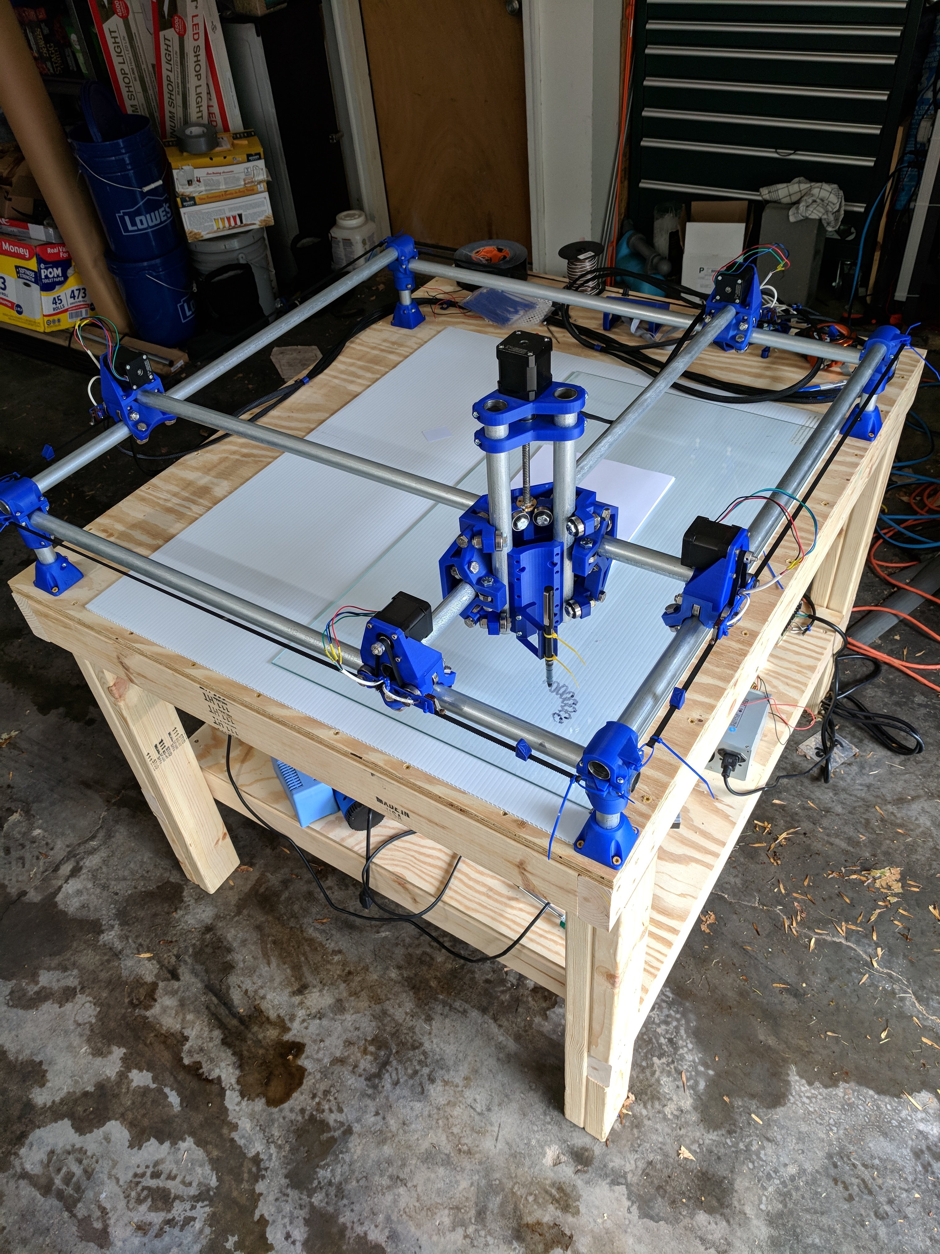

This is my first project with my 3d printing. Still not completely finished, but it’s working. I have some wire management left to do, and some zip ties to snip. Also planning to mount RAMBo board on side, and power supply under table. Loving this machine, tons of fun.
[attachment file=63934]
Looks good so far. You’r going to have some fun with it (…and a few irritations) so worth it!

My first question on this machine as a new user… Does the weight of the hanging Z wires (off the table) keep them off the work surface and out of the path of the milling bits? I’ve only been using small work area with a pen & paper, so I’m trying to figure if I need more cable management for Z axis before putting in DeWalt router…
You should not let there weight pull on the Z axis. Have a look at the tape measure trick. I have it linked in this post. It does not need to be in a sleeve, tape or cable ties work just as well.
