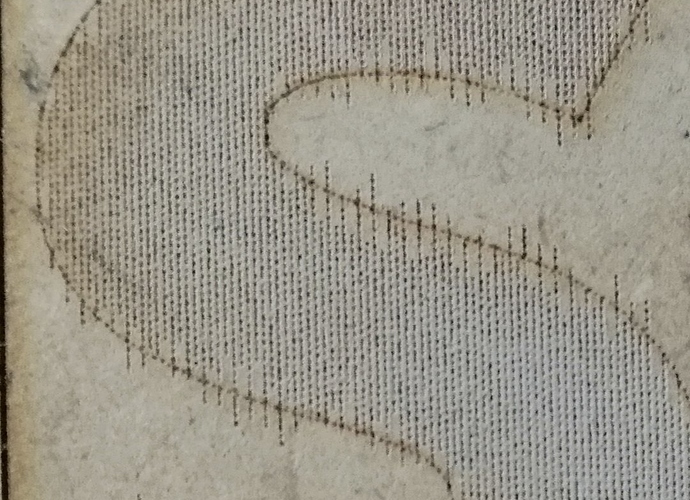

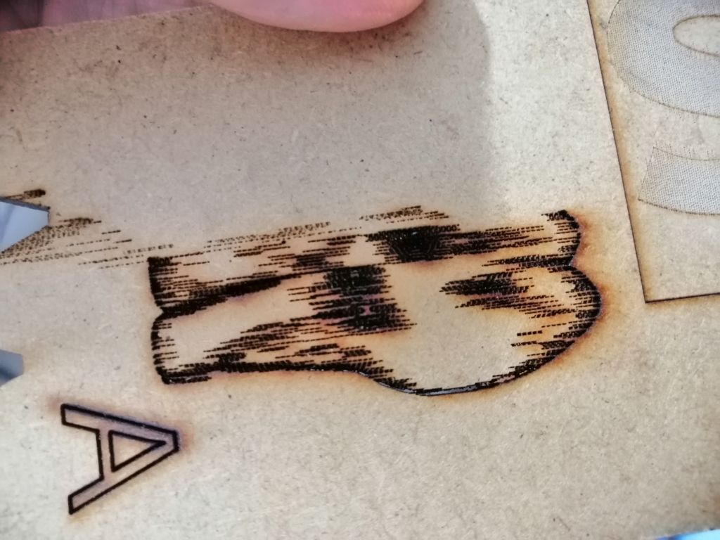

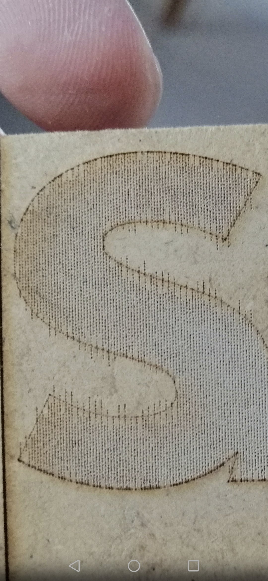

Hello,
I managed to put all the pieces into a working machine.
However, I have problems with engraving.
I have already read info about it in some other thread, however I am not quite sure what is the problem
What I understood is that the older firmware was OK and the new one is missing some component.
I just get much worse results when engraving with CO2 than with my good old Chinese laser diode.
I have noticed also that steppers are pausing to take a breath hehe when I put 3000mm/min and I give a drawing where I have many points like spline.
I have never noticed it before.
Yea, with a bigger laser you have to move faster to engrave. If you ever watch a “real” laser engraver running, they’re hard to keep track of when they’re doing those kinds of fill areas. Our machines aren’t light enough to run at that kind of speed. At least not with these steppers.
Barry, I know , but I didn’t mean I go to slow.
I have completely different problem. With laser diode the shape was not blurry and was not projecting outside of the perimeter of the shape.
Here with Co2 there are some strange things happening. I have no idea if it has sth to do with the firmware.
Oh, I see. It’s not shutting off fast enough maybe? I seem to recall something like that when they started putting lasers on the mpcnc, don’t remember the fix though.
