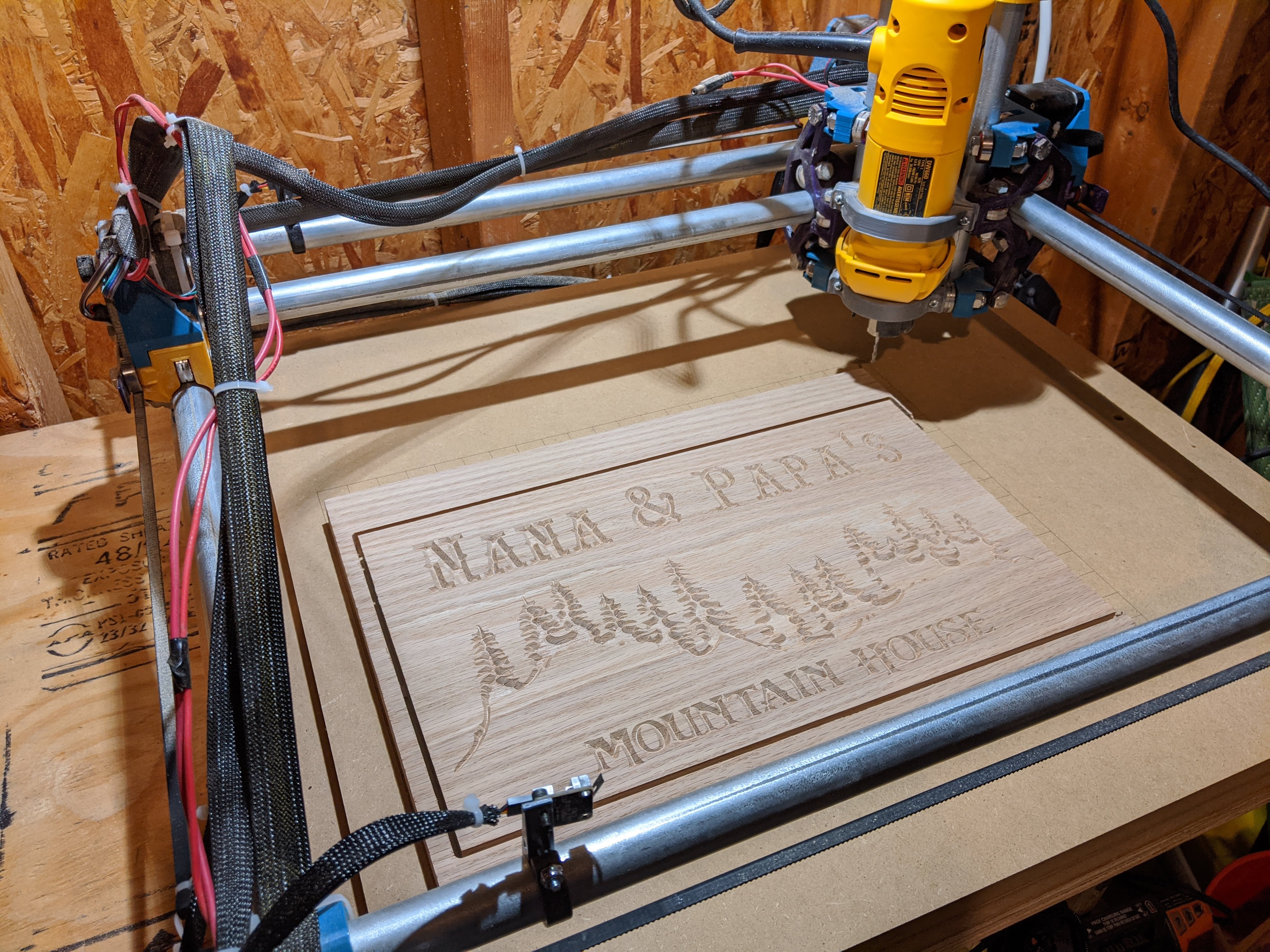

I finally designed and cut something real. Did the first test on MDF but here is the cut on oak.
I used a 90 degree v cut bit for the edges with a 1/8" spiral bit for the flat parts in the middle. Used Adobe Illustrator for the design then ESTLCAM for the CAM since I couldn’t get fusion 360 to do what I wanted.
Used the end stops and a z touch plate to allow me to kill the motors; move the router to a convenient spot; switch tools; then just rehome everything and let it go to town.
After this I switched to the laser and etched my logo in the back.
Doing the finishing work now and I’ll post a final.
To say the least the machine is very very dirty and I need to up my dust collection game.
