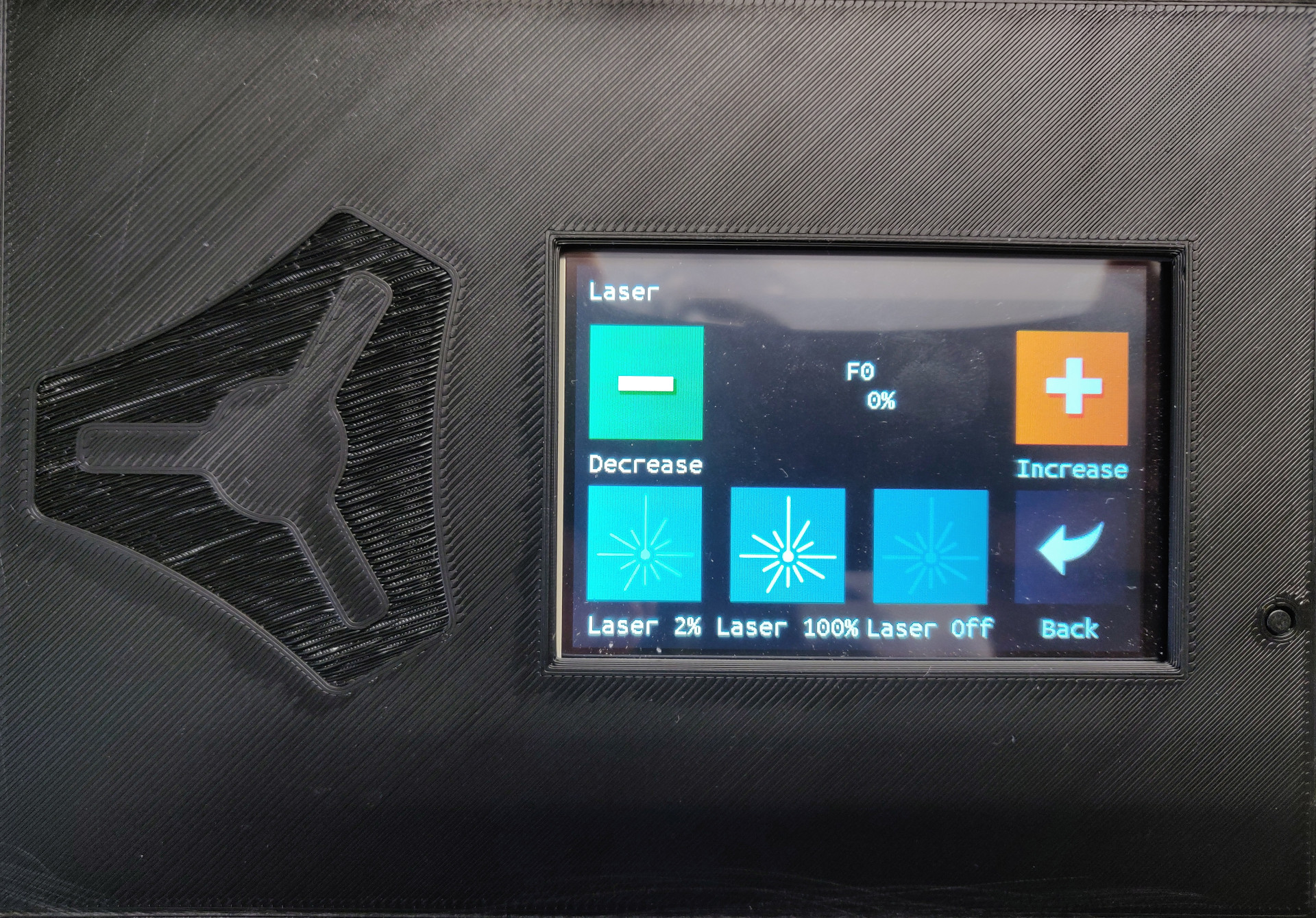

Oh Gabriele, I thought this was just the dogs danglies…until i got it working (I didn’t realise I had to recompile it, I thought one of the existing .bin files would be what I wanted…and then I had to find the configuration.h to enable the laser menu) but I am disappointed because the laser menu controls the fan output whereas I PWM the laser using M3 and M5 with Sxxx levels as per ā€˜proper’ milling! All my software generates power settings from M3 Sxxx …poo!

  • The laser control function by fan output is a porting of @blomsd baseline that I used as starting point of my development, I don’t have a laser in this moment so I kept the concept as it was.
  • I use M3 and M5 without Sxxx levels to manage the spindle start/stop see Spindle.c source as a reference
  • I have duplicated the fan management menu for the laser see laser.c and make it working modifying the support function (parseACK.c, interfaceCmd.c) probably changing in laser.c laserCmd[] = FAN_CMD; to the command you want you can arrive to something working for your setup.

Hi Gabriele, thanks for your reply, I have indeed made a start on converting the Laser control page from using the Fan commands to using M3 Sxxx to specify laser on powers…and it works! I mangled the existing laser.c with spindle.c to arrrive at something that displays a page with 7 icons for selecting different power settings and a return icon, but I am stuck on the label and icons.
In the snapshot is my laser.c showing the ICON_LASER_12, 25,50,75 and the LABEL_LASER_12,25,50,75…all these identifiers are undefined (and therefore white in the workspace and I do not know where to look to define them (or how to at this stage)…I was hoping to find entries in a search for LABEL_LASER_2 but no joy. I have added the icons to the TFT35 folder and made entries in icon_list.inc, as you can see.
If I set all the ICON_LASER_ to 2 and all the LABEL_LASER_ to 2 it compiles and I get this -
So…any idea where I declare my icons and labels?
I will d/l your latest firmware, is there a best way for me to share my efforts with you and others if they are interested?

Hi Gabriele, As if by magic…I start up Visual Studio today and the ICON_LASER_12 et.al. are working. I am guessing because I had made entries in the icon_list_inc file for my new icons after a restart it ā€˜registered’ my changes. I will now try and do as you suggest for the LABELS…
I am not sure an INC and DEC is really necessary for the laser…having more than the 2%, a 100% and a 0% would really be all you need during the setup phase of an operation, all the analogue settings are taken care of during the actual lasing job, I just wanted to fill up the Laser page with pretty icons.
My version of Laser.c is not pretty! I am sure I broke every rule in the programmers handbook bar one…it works! Let me get the labels working and I will post it up somewhere…I will look into opening a pull request…this is new to me.
All done…I have uploaded my version to your github as a pull request…take a look and let me know what you think!
