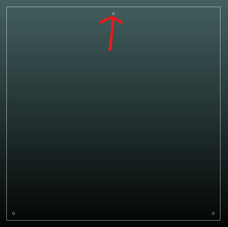

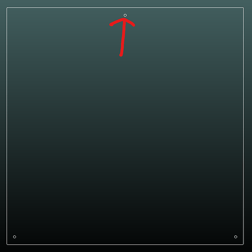

The bottom two holes are straight forward, but do I want the top/back hole to be centered on the plate? With the bed rail underneath the bed being slightly off centered, it has me wondering if I need to adjust the center hole here to compensate for any reason.
On the V5 the back hole is centered. The V4 was offset. This is why the bed mounts are specific to the position on the printer.
If I remember right you should be able to get the exact DXF you need from the CAD. But it has been quite a while since I messed with it.
