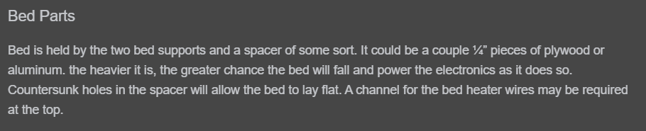

What is the best way to mount the bed plate to the “T Frame” bed extrusions? I don’t see a DXF anywhere for the hole locations on the aluminum bed plate. I am a bit confused on the below as well.
I am thinking of 3D printing some standoffs to use as spacers between the extrusion and the bottom of the bed plate.
Recessed screws at the 2 front corners, and in the center at the back I believe.

Ahh okay so you did print some spacers. That makes the most sense.

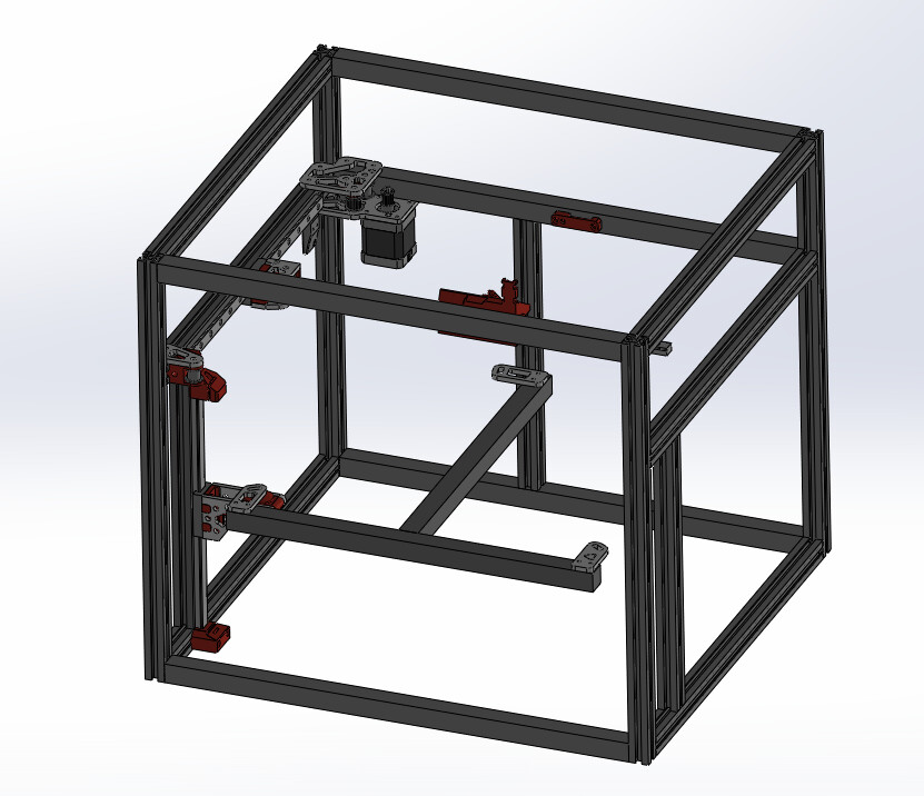

As for the CAD, I downloaded the STEP from the Fusion link and am using it in Solidworks. But I do not see anything about the bed. But I could just figure out the hole locations myself. Didn’t know if there was already a DXF for the hole locations or not.
I don’t think the bed was made solid in the Fusion file, so it wouldn’t have made the STEP. You’d need to open it in Fusion and export the sketch as DXF.
