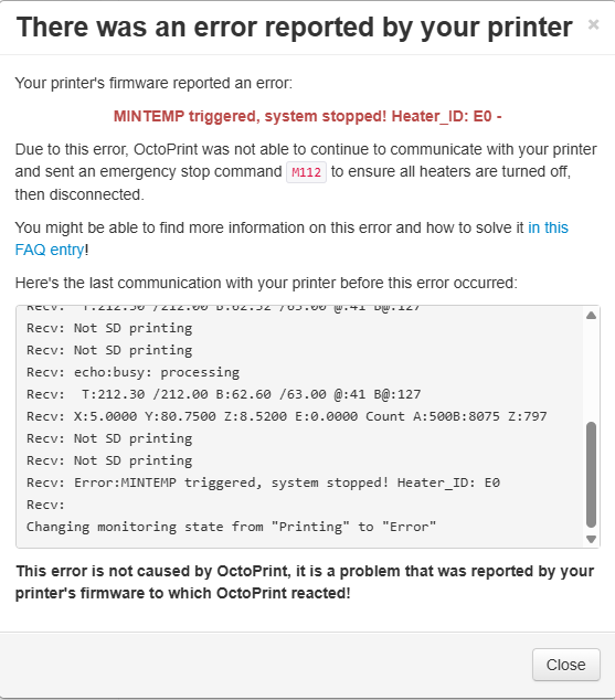

Hello everyone. It has been a while since I have hopped in here.
I am back for some advice. I have all of sudden started receiving this error very early on in my prints, normally while it is still in the bed leveling sequences.
The actions I have taken so far are:

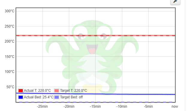

I have left the hotend temp at 220C for over 30mins now and have not had any drops. Would a quick mintemp reading even show up here?
I am only getting this mintemp error during a print, never seems to happen during idle.

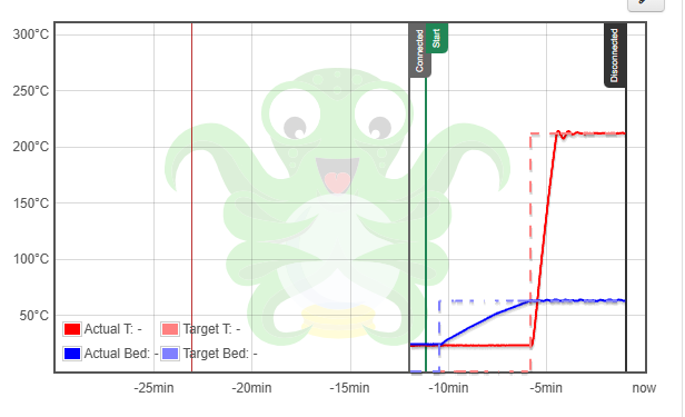

Here is the temp graph during the print. Never made it to the printing, got the error during leveling which is consistent now. Nothing clear in the graph, no drops. The last recorded temp was right where it should be.
As for power supply, I am using a 12V 30A supply and the printer has used it for a year or so now. Not sure what could be wrong there.
