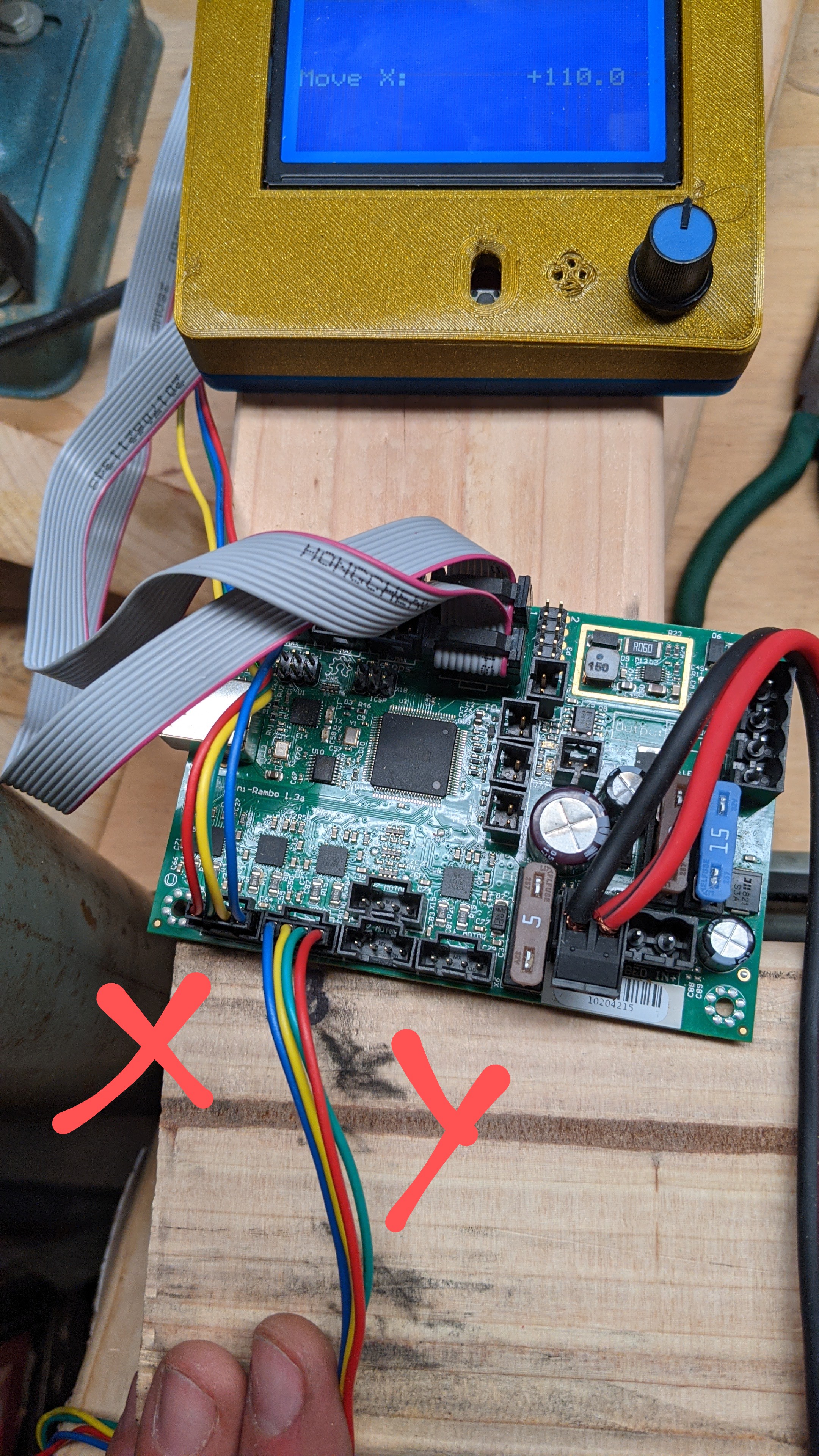

Are my motors mounted correctly? Seems strange it moves smooth in the x and in the correct directions, but jerky/skipping in the y. I feel like if it was wiring the x wouldn’t work or it wouldn’t move in the right directions. Maybe I’m wrong…
I attached a couple pictures of the motors mounted and the wiring to the board.

Your X and Y are switched. If you leave it like that, the patterns will be reversed.
You also have to be careful to get the homing order right and the right endstop with the right axis.
Positive direction is away from the end stops, right?
Yes, but if the endstops are in the lower left, X goes to the right and Y goes away from you. From your picture, it looks like that is switched.

Thanks Jeff! End stops are in the top left so I think I have it wired correctly.

If the endstops are in the top left, then +X should go down and +Y should go to the right. If you don’t do that, patterns will be flipped.
Imagine you were standing on the left side of the machine, then look at my previous post.
However you do it, you need to be able to rotate the machine so this is the case, otherwise, everything will get flipped.
