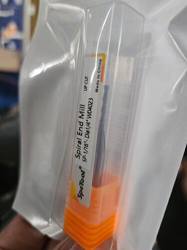

1/4" collet options do exist, and I use quite a few of them. I have several 1/8" cutters with 1/4" shafts, and even have a 1/16" cutter with a quarter inch shaft.
So it can be done, but the 1/8" shaft cutters are cheaper and more convenient.
