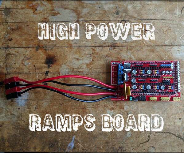

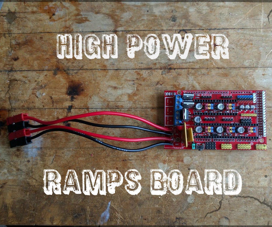

I’m not very familiar with mosfets. I’ve used the ones that were recommended on this instructable:
1.4Ohms @12V is 8.5A. That’s not too much. With the datasheet linked in that instructible, it should be generating about 0.1W. 12V on the 2.8Ohm would be half that current, 1/4 of the wattage. But that’s not making much sense. Do you have a heat sink on the mosfet?

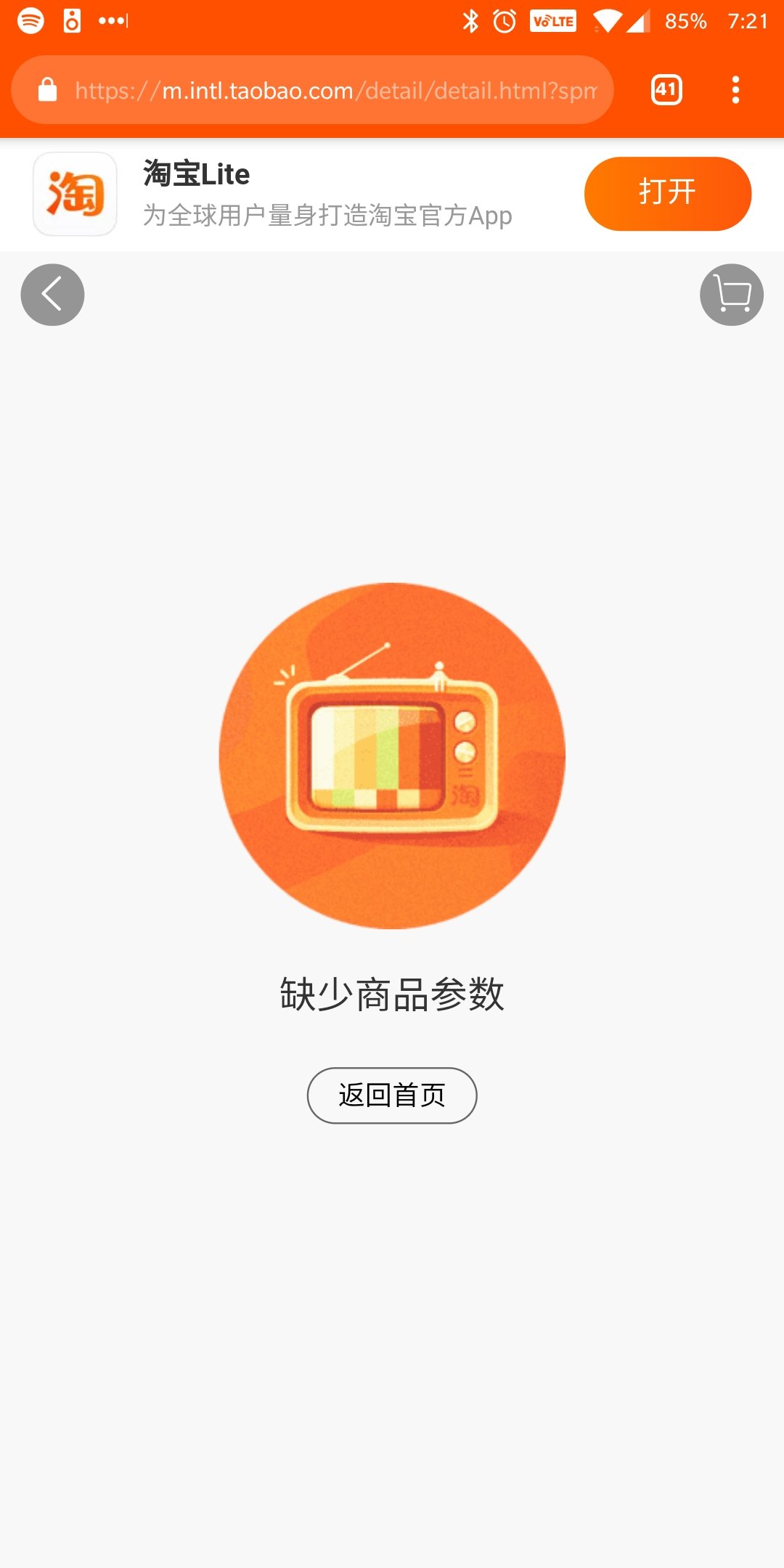

Btw, I tried that site, but I can’t read it, amd when I randomly clicked on stuff, it brought me to the front page. Sorry for my ignorance.

Aw, crap, I guess it is only accessible in China now. Used to be accessible last year but the Internet is getting more and more compartimented between countries nowadays, it sucks.

Once the FET is fully on it should have a negligible resistance, so unless there is some really insane currents going through it (this one is rated at 195Amps!) it shouldn’t heat at all. But given the fact that this power supply is rated at 30 amps, I don’t see how it could come even close to 195Amps…
I suspect that it might not be fully on, resistance is usually a lot higher when FETs are doing the swiching or whenever they are semi-opened. That’s the only way I think it could get so hot so fast.

I made some progress yesterday. Apparently the Ramps was dead, I guess something fried in the PWM driver when the first mosfet died (my guess would be that the gate resistor got too hot because it was really close to the fet, this probably affected its value too much), so that might explain why the other mosfets fried as soon as I replaced them.
So I changed for an other ramps. This one seems to have a better mosfet, which didn’t heat too much. But on this one, the issue seems to come from the polyfuse. At some point, the polyfuse gets too hot and shuts down the heat bed.
I tried first to use the compressor to blow air on it to cool things down, which worked perfectly. So that narrowed things down to a heat problem only, good.
Next step, I’ve put a fan on the ramps, which did make things a bit better than nothing, but I still could not evacuate enough heat to go from 0 to 60 degrees without the ramps shutting down (at least not when using the heatbed+fans+nozzle+motors at the same time). But once it eventually reaches 60 degrees, it can keep this forever without any problem since it is not constantly ON anymore.
So, in the end, I think the issue is just that this heat bed needs too much power and that ramps board are crappy, there seems to be nothing really wrong with the heatbed itself. So I guess I’ll just buy a SSR or an external mosfet to drive it and call it a day.
