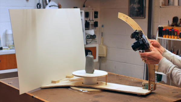

I am thinking about morphing my rotary laser engraver ( Dedicated Compact Rotary Axis Laser Engraver | OpenBuilds) into a 3D scanner. I found this project (https://en.openscan.eu/) that has most of work done and looks like I only need to buy a cnc shield for the Pi & a light ring. I can get a Protoneer CNC Shield from Genuine Protoneer CNC Shield v3.51 for Arduino Engraver CNC GRBL 1.1 - ZYLtech Engineering, LLC that I will have to solder & and a light ring from NeoPixel Ring - 16 x 5050 RGB LED with Integrated Drivers : ID 1463 : $9.95 : Adafruit Industries, Unique & fun DIY electronics and kits that should work. I will probably need to get a newer pi cam as mine is a V1.3. Only new 3d printed parts would be to mount the camera & a wider, thicker rotary table. Probably will have to make the legs on my engraver 500mm long instead of the 250mm. Does anyone have alternate suggestions for the Pi CNC shield, camera or ring light?
[Edit] I posted this before looking at the videos for that project. Looks like I will need to have a tilt for the camera. Original design rotated the model. Since I am going to use a pi camera, rotating that will be a lot less weight to move around & should be able to use a servo for it if software end is not a problem to modify.
This is something I wanted to get to but never did. Very simple. Then you add in meshroom! (open source and free)
