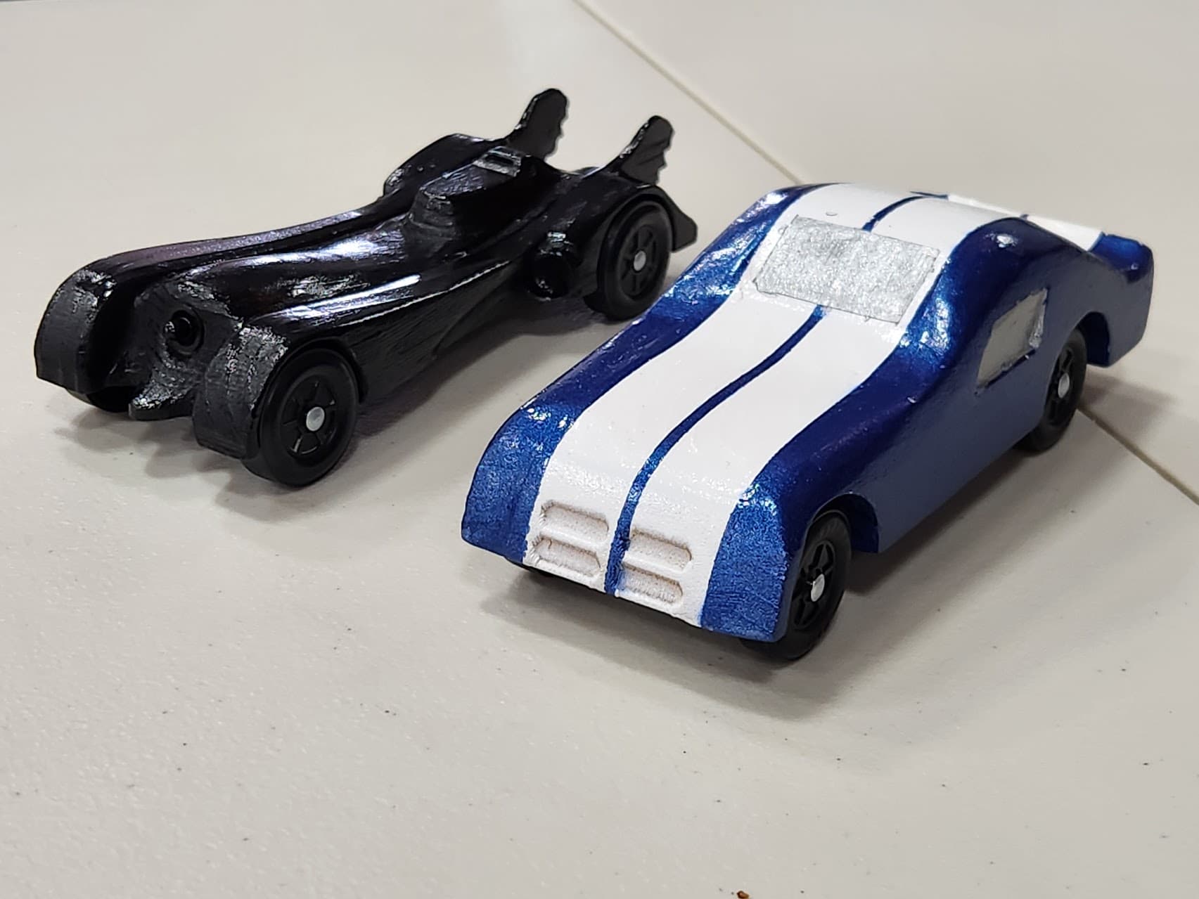

Another local brewery had a 'Pint’wood Derby race last weekend. I put the MPCNC to use. My son modeled the blue car himself from scratch and did the sanding/painting. All I did was cut it out for him. I found a model of a Batmobile and tweaked it to fit PWD dimensions. I think it turned out pretty well too.
My son’s car not only won the Youth division, but it was also the fastest car of the day and beat all of the adults too! Plus it is a sweet paint job! He was a little bummed when I told him he couldn’t race the same car again next year.
The Batmobile had some problems during assembly. The wood split when trying to put the back wheels on. I repaired the wood the best I could, but I had to re-drill axle holes and I did not do a great job. The wheels were not very well aligned. Even so, it had a respectable showing for 2 of the 3 heats. The other heat had a crash. Honestly, I didn’t even care. The car turned out like I hoped it would and that’s the challenge I was hoping to complete.

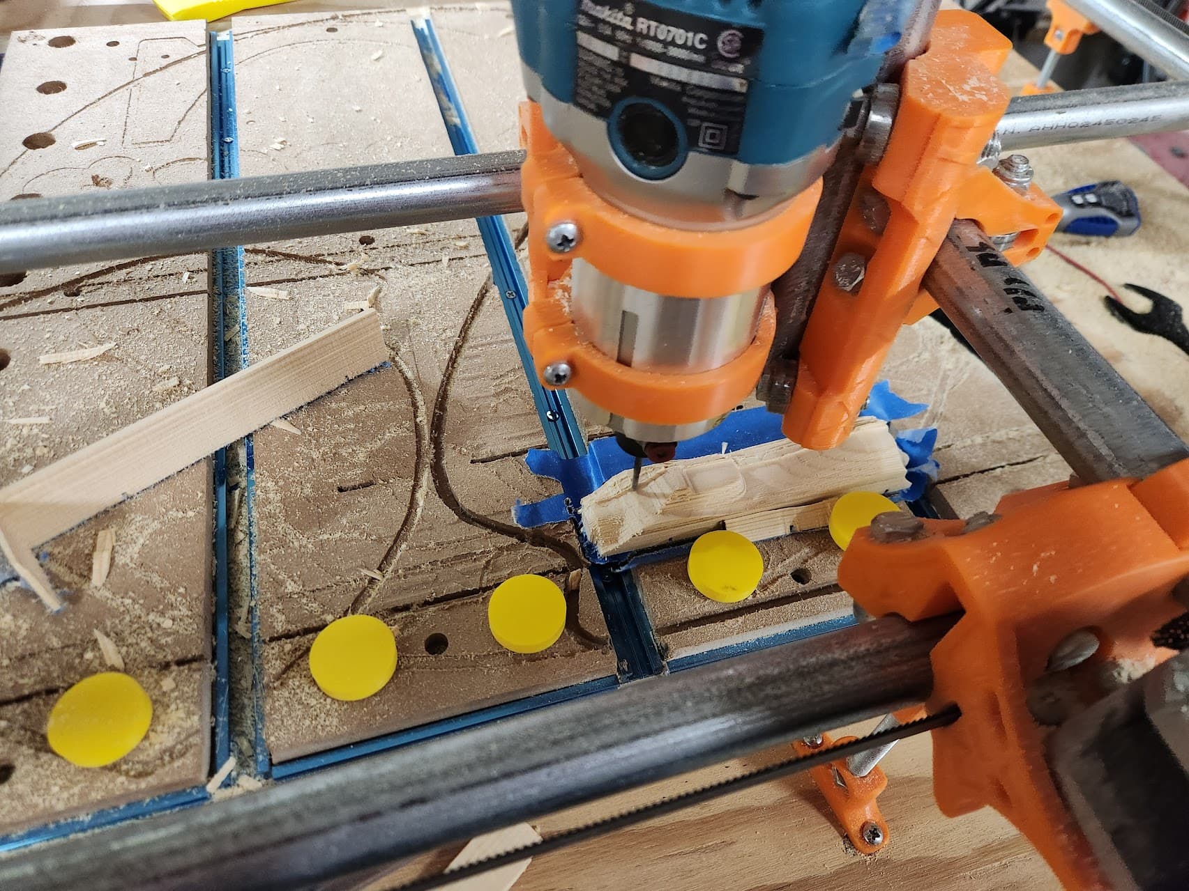

I am hoping to do the same on my MPCNC for the derby next year. How did you hold down the blocks while you carved them?
CA Glue and Painter’s Tape.
The Batmobile was tight. The main body was actually narrower than the standard block. It required a long bit and I barely had enough Z height to get all the way through it. All the clearance moves pulled out of the bottom set of bearings so it was a little nerve racking. If I had to do it again, I would have split the main body up a little more.
The blue car was a little easier since the main body was the same size as the block of wood, so the bit didn’t have to reach 1.25" down. The sides of both were cut out of some 3/4" pine and glued on.

Looks like you were really pushing your Z limits but they turned out great.
