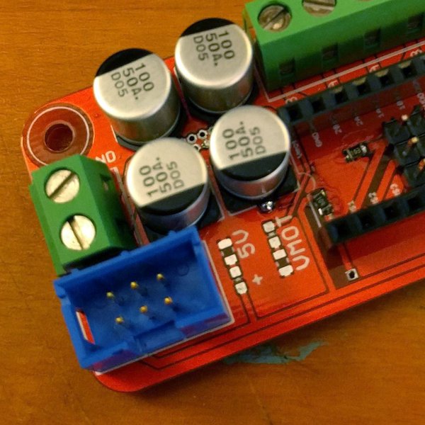

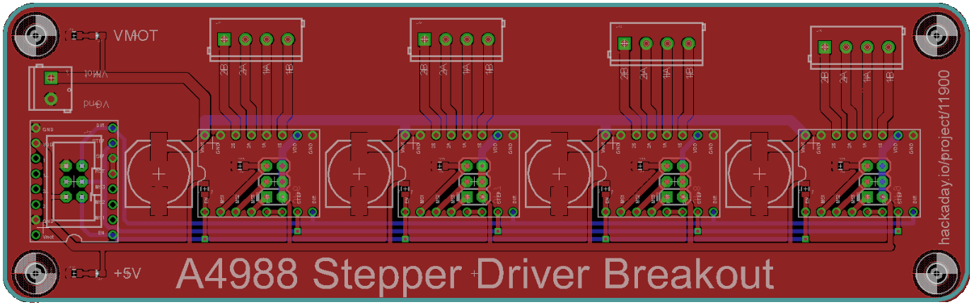

This project uses a break-out board to let you plug up to (4) A4988 boards into a socket meant for one of them:
Has anyone tried it?
Are the boards available without custom ordering my own PCBs, then stuffing & soldering them myself? I would much prefer 2.54mm JST connectors over screw terminals.
I am posting this here because the board looks like it might be a great addition to many of the projects V1 Engineering sells. I have no affiliation with the creators of this project, who do not seem to be maintaining the HackADay page. I am not making a cent on this. I just want to find a cheap way to push more Amps without blowing out my stepper motor drivers.

Thanks! External stepper drivers look like a better option than an Arduino-board connected to a shield-board connected to multiple-duplicator-boards connected to multiple-driver-boards.
