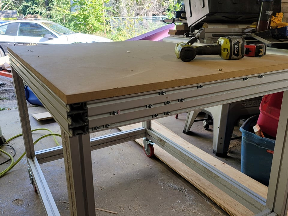

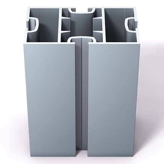

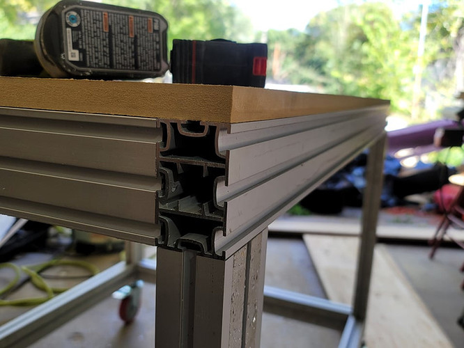

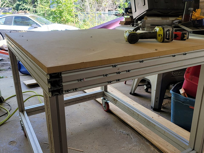

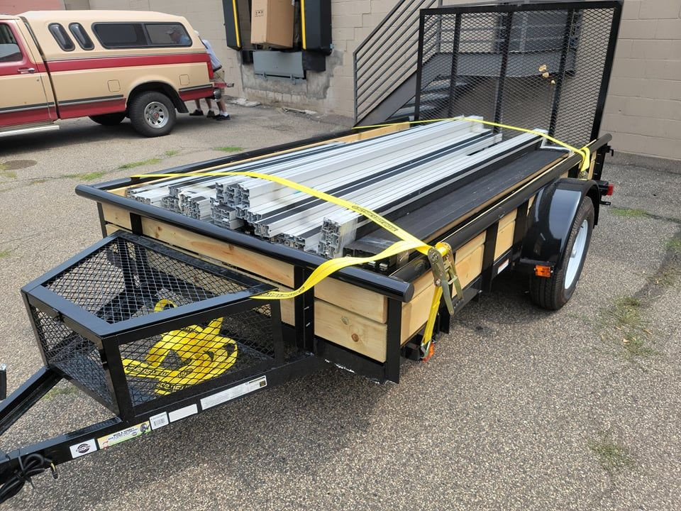

On the CNC front: Progress is finally being made on my upgrade project. The LowRider is being dismantled so I can replace the wooden CNC table with 2X3" aluminum extruded “studs” with T-Slots. These are used for the support structure behind the scenes at large trade shows, and they hold up most of the giant trade show displays… I got a hell of a deal on the entire trailer full. 107 bucks for a 5.5’x10’x18" deep trailer full. New, a single 72" chunk of this stuff retails for 132 dollars. I’d say I got a hell of a deal.
I posted about this on a DIY CNC group, and stumbled across a guy local to me who traded some linear rails and the like to me in exchange for a stack of extrusions, so my large machine project is coming along…

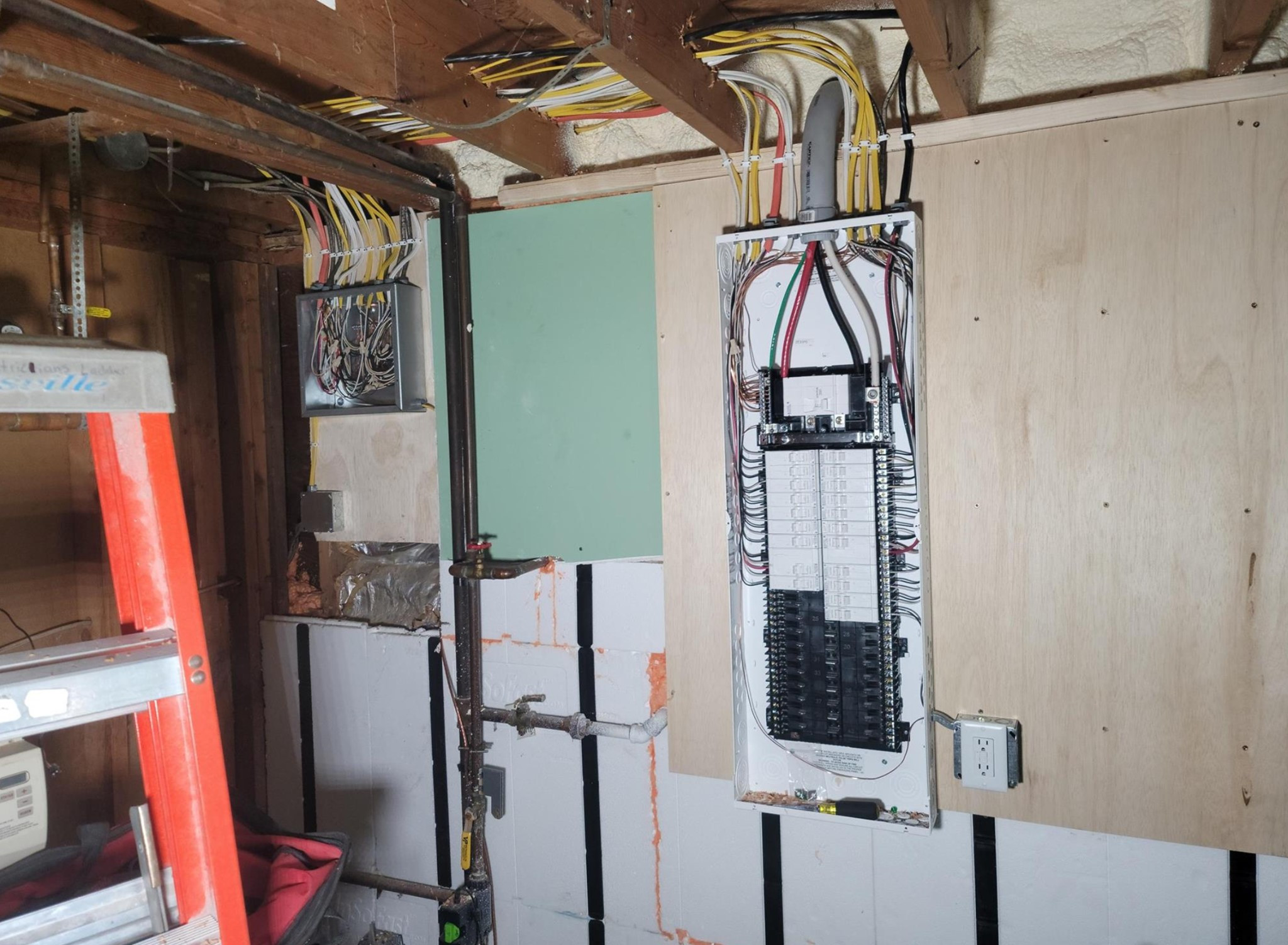

I also had the home electrical panel replaced to bring it up to code. Installed a smart panel, and now have a 100 amp dedicated circuit running to the back shop/garage where the CNC is. This entire project involved ripping out a lot of water damaged insulation, furring strips, etc, and spray foaming and insulating the basement walls to make room for the new panel.
Old panel location is the left side where the large junction box is.

My electrical box is pretty old. I imagine they can’t just use the original wires to the next box, so they extend each one over to the new panel?
If you move your panel, they can junction properly inside of a box and extend the circuits to the new panel. In fact, electrical panels qualify as junction boxes if you add a solid cover and gut the interior. You just have to be mindful of volume of space inside the box as well as volume of wire. You have to have a certain percentage of free space.
If you keep your panel in the same place, you can legally junction the circuits inside the panel to extend them to where the breakers are located in the same panel.
We had to move ours to meet code. There is a floor drain directly beneath the old panel, pipes in front of it, etc. The new location brings it out so it complies with code and gives me room to add/rewire. We’re also installing new hardwood in the main level. This will involve ripping the cabinets out so I can put it in underneath. Since I’m going to be that far in, now it’s time to rip all the old wiring for the kitchen outlets out and run new 20 amp circuits. I didn’t have room in the old panel. I do now.

I am super jealous of that extrusion, haul. That is going to be fun to use.
Oh, you have NO idea… Erector set for adults!

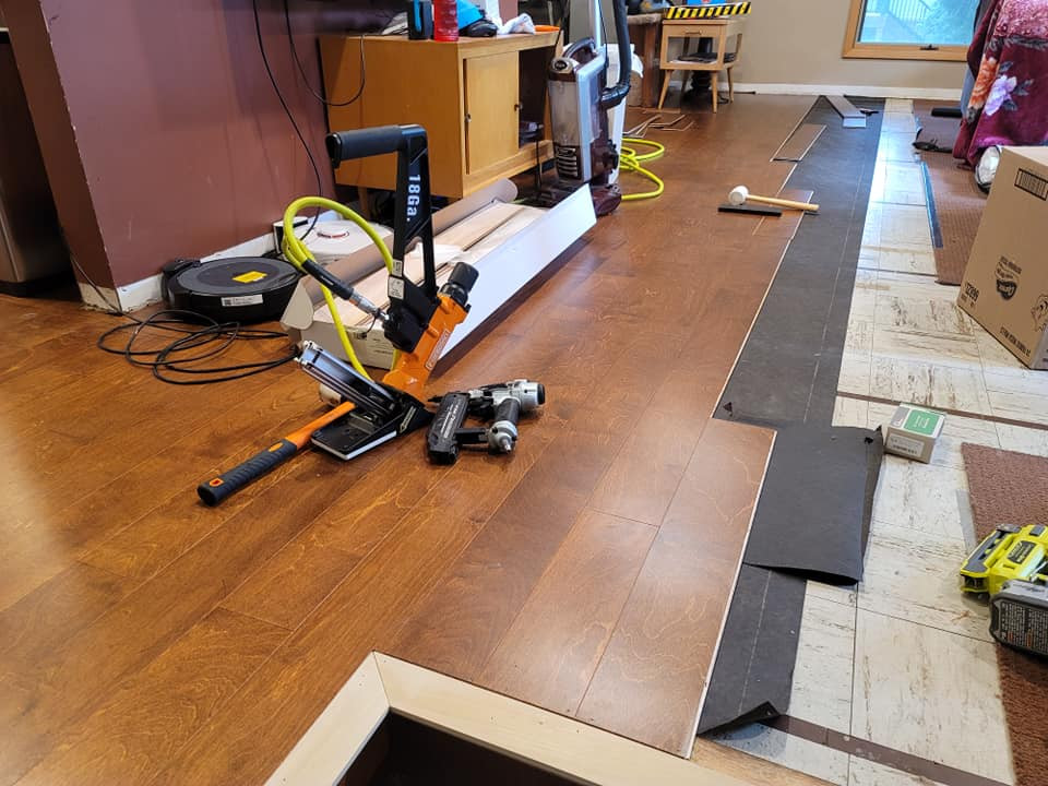

Some recent trips through an auction site have resulted in 1200 square feet of engineered hardwood flooring for less than 1.50 a square foot. So now we’re re-doing all of the floors in the house, replacing poor quality laminate and old carpet with hardwood, encapsulating good condition vinyl asbestos tiles with tar paper underlayment (spec’d by the manufacturer) and nailing the planks down, etc… Before you say anything, several flooring pros said that this qualifies as encapsulation and is just fine, because the wood becomes “structural”… The poplar on the stairs is a placeholder.

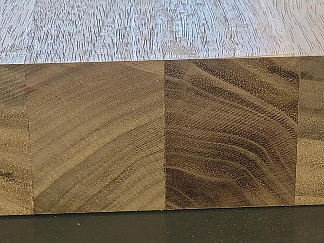

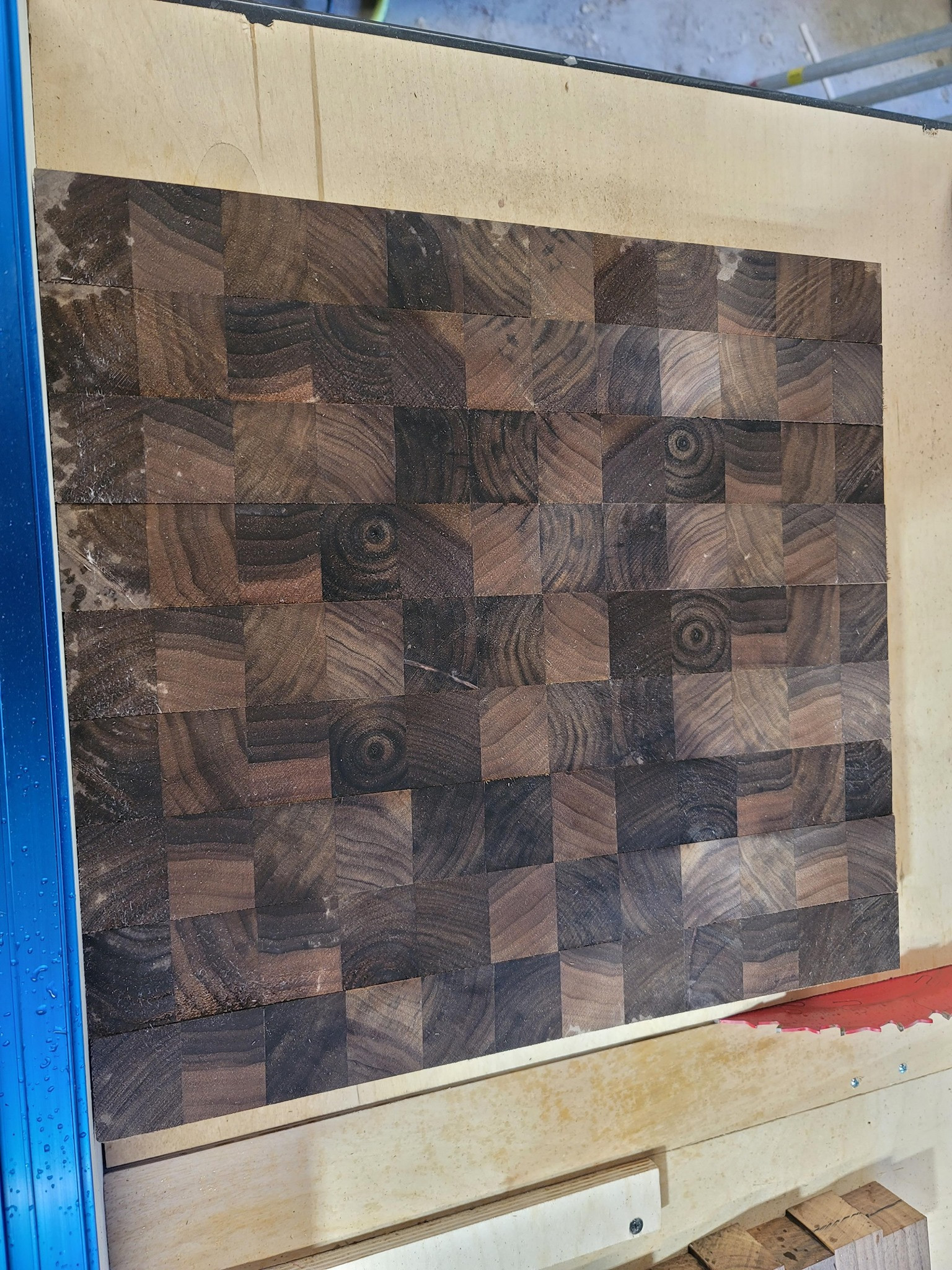

So, LowRider is down. Big machine is coming along, and I’m wiring the control box for it right now with a 220v 3-phase VFD and water cooled 2.2kw spindle, 80v power for the NEMA34s, etc. I have the motion system sorted with 2505 ball screws for X/Y, and one hell of a set of linear rails for the Y-axis… This one will be built within the next two or three months. I have a need for a CNC right now though, as said auction site also resulted in 1400 board feet of 2" thick walnut and birch slabs. Remember the stair nose place-holder above? Yep. Solid birch stair nose on the way. The walnut on the other hand is going to turn into solid walnut butcher block counters for our kitchen, and the remaining 1200 board feet will be turned into end-grain butcher blocks…

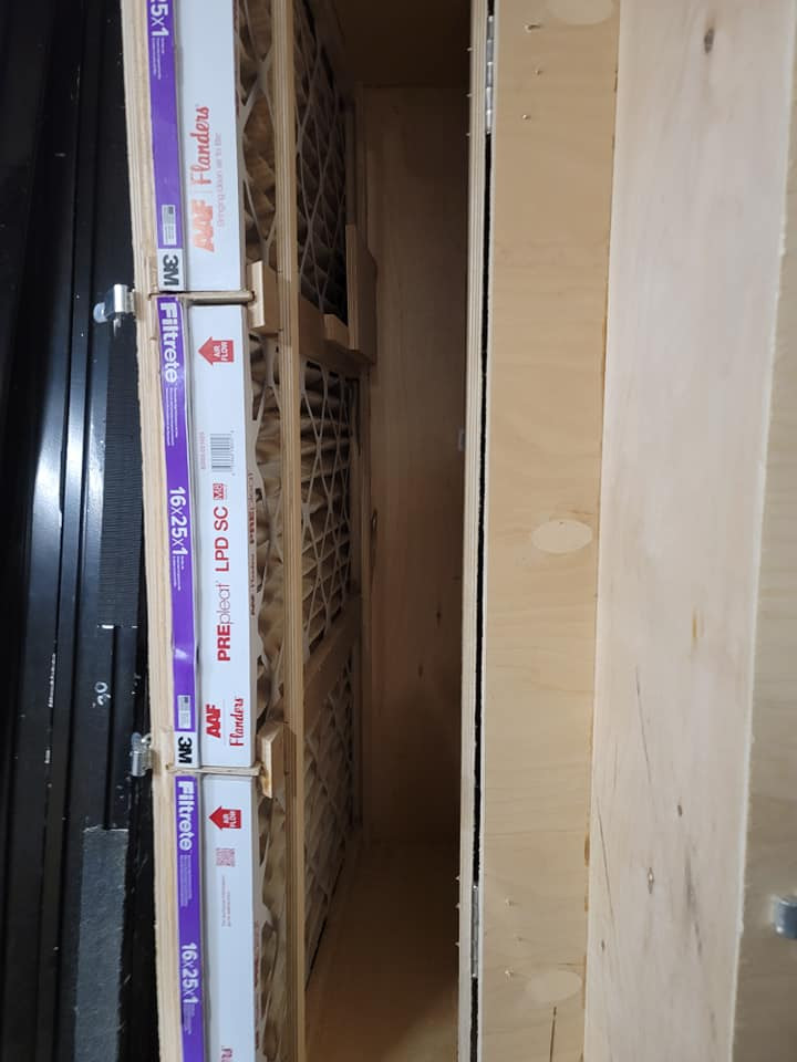

So, back to the CNC stuff… What does this post have to do with the LowRider? Nothing. I just ordered the Primo kit from Ryan, and will be assembling that as soon as it comes in. The aluminum extrusion mentioned above? Fully enclosed CNC housing for turning those end grain butcher blocks into inlaid end grain butcher blocks, cutting boards, carvings, etc. The Primo will serve as my small job machine, churning out repetitive stuff that is quick to do. The big machine will handle all of the long jobs, since it can do it at higher speed and deeper passes.

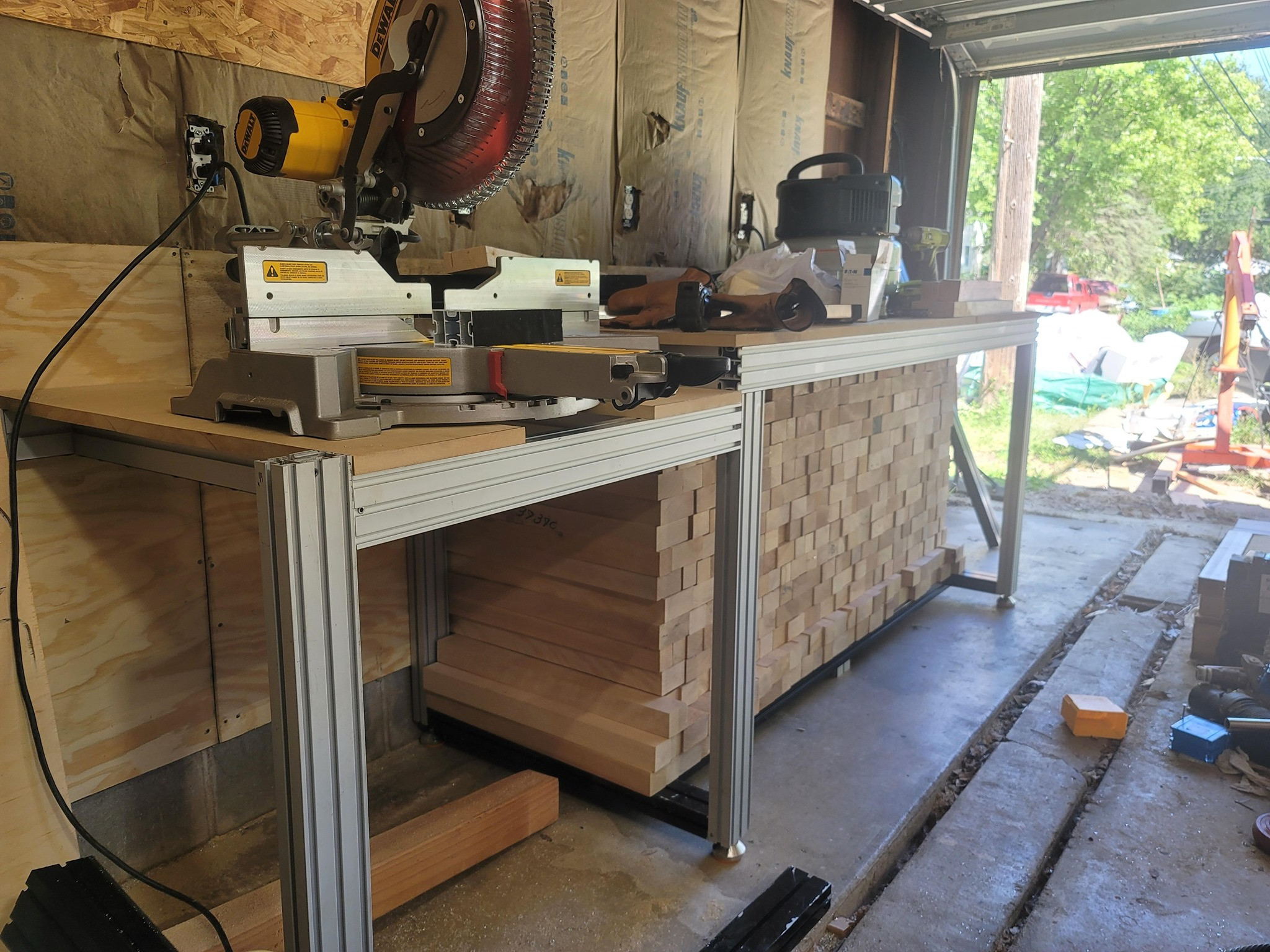

Miter saw station (this is now finished with a table on the left as well)

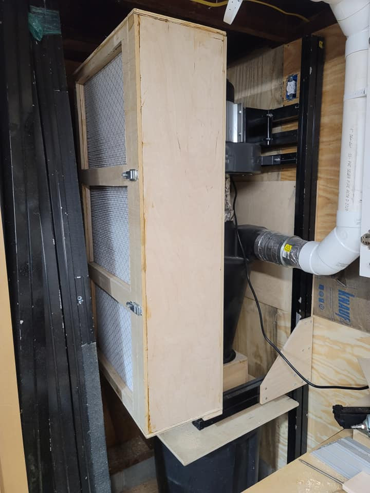

Dust collector ladder frame and filter box.
