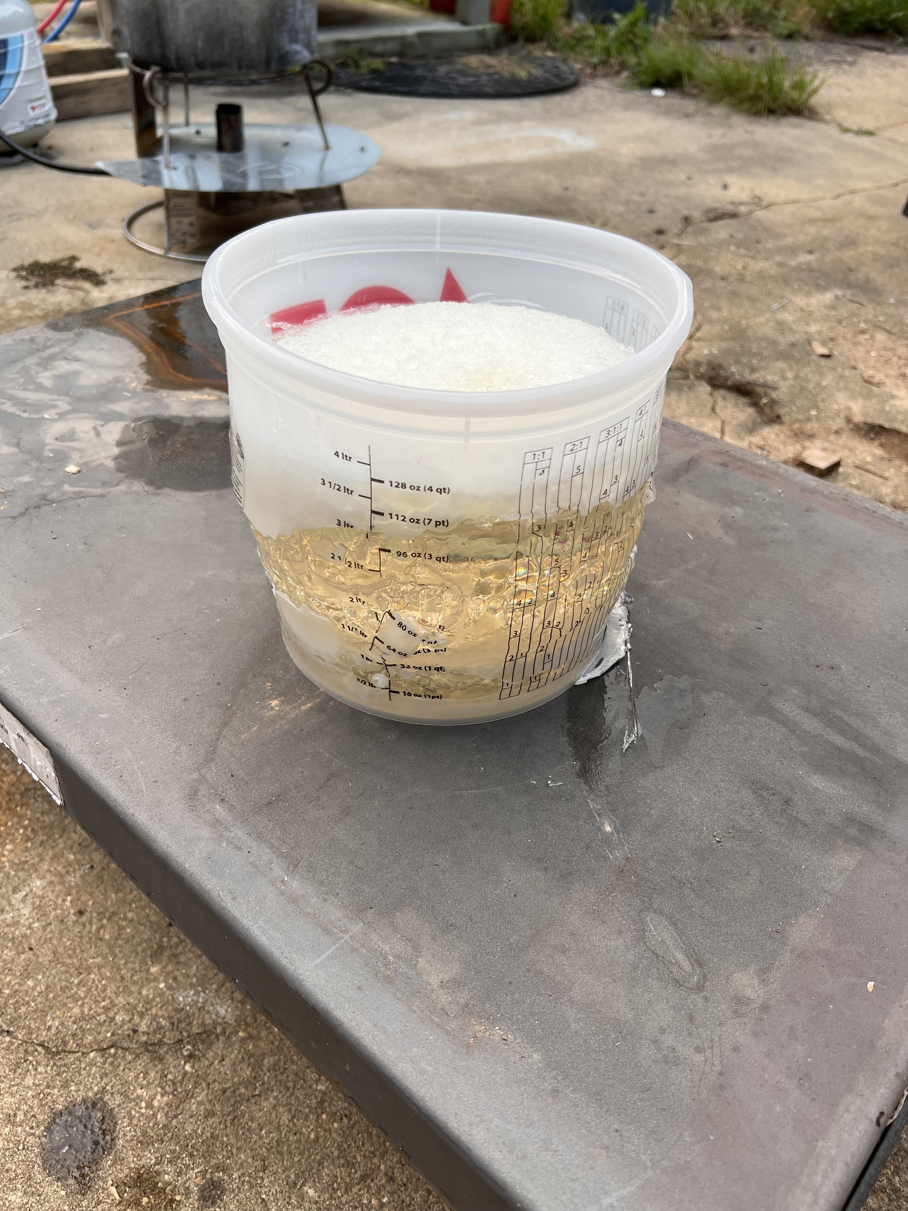

On the first beach sign I made (the one I messed up beyond repair) I had it all finished and was going to do a flood coat of clear epoxy on it. I bought a vacuum pot from vevor and tried using it to pull the bubbles out. The epoxy set up in the pot in literally 2 min. Hard as a rock.
I have no idea what I did wrong lol. Ended up doing another pour and it wound up with so many bubbles in it that I had to surface it off and redo it. That’s where things really went down hill lol. On the second sign I opted to skip the flood coat and just put Rubio on it instead and I’m happy with the outcome.
When you make a huge pot of epoxy like that the chemical reaction as it cures generates a LOT of heat and that accelerates the cure. As you have seen, when it goes it really goes quickly and can get dangerously hot.
Make smaller batches - cool the resin a bit first, and pour it out over as large an area as you can as fast as you can!

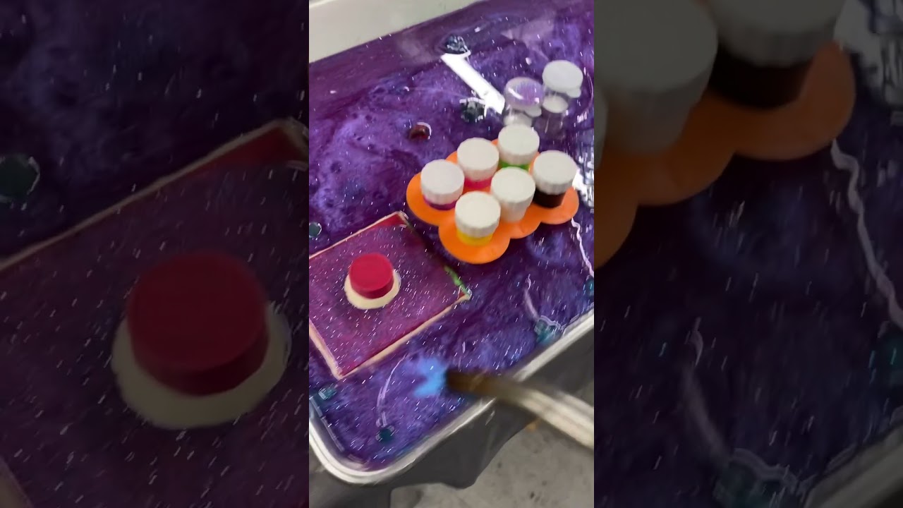

When I do surf boards I flood it on then use a map gas torch and it instantly takes the bubbles out it was scary doing it at first. But I think it either removes some surface tension and the bubble pops or it is some kind of gas affect. I have tried hot air gun but it wasn’t as good.
And when I mean torch I mean like a quick second flash over. Do not hold in one place.

And that’s it it’s All measured. One sec I think I have a video of me doing it. And also seeing some surface tension oddities.
Couldn’t find the one vid but here is me using torch on my arcade top thingy
