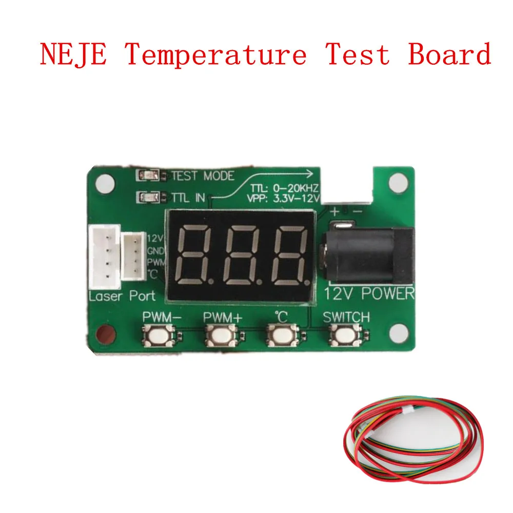

Laser accepts TTL/PWM 3.3v-12V.
The TTL pin is coming out of this board and going into mini Rambo FAN1 port. Am I doing something wrong?

Thanks for your input. So the board I linked above is a pretty cool thing. It is for NEJE lasers which reviews point to currently being the best China laser company. Pretty decent priced too.
The small board takes 3.3v to 12v and then talks to the laser driver itself. There is a switch on the board that lets you either control the laser manually or switch over to TTL mode and only then the SKR or mini Rambo will be able to control it.
So its like another switch you must press before laser turns on, which I like over direct connection and GCode mistake making it go crazy for something this dangerous.
Should not be any need for resistor as this $11 board lets you put in 3.3v-12V so FAN port or a PIN both would work fine.
Challenge is as per above, when I move over to TTL the mini RAMBO even when not running GCODE is sending ON state or 100% TTL/PWM or that is what the board is thinking it is getting from the mini Rambo FAN port, normal connections.
EDIT: Hmm I think I see what you mean. I could try the resistor. One would have hoped this mini board with its added logic took care of this.
