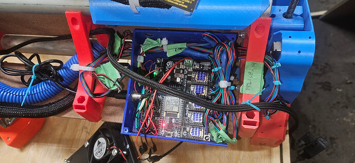

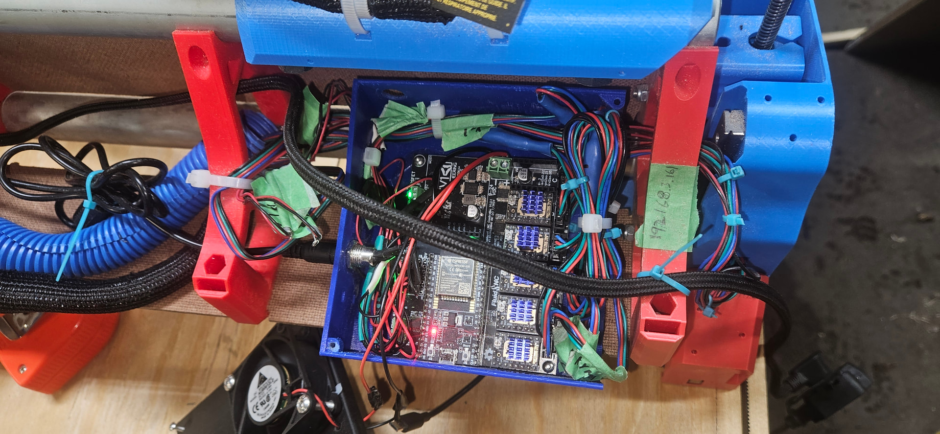

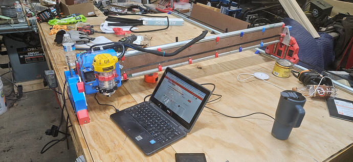

so I finished my lowrider a while back and have done several carves including making the strut plates. I had trouble at first with the jackpot coming programed as mpcnc rather than lowrider but after searching this forum I was able to get it straightened out. I just recently reassembled the lowrider with the new strut plates and all was well. At some point along my journey I deleted the file(s) for macros so I decided to update the operating system through fluidnc web installer in hopes that file would return. I inadvertently did a clean install rather than just an update. I now cant connect with my wireless pendant and can only connect with my laptop, when I try to home the machine the Z and Y min side move at different rates with the min side barely moving. I’ve tried reloading. I’m thinking the connection and min max travel rates are somehow related but I cannot seem to figure it out or find similar issues on the forum. Thanks for any help

is there a different file I should’ve posted. I’m lost as far as where to go and what to try next. Aside from adding a fan and installing the gantry struts, I haven’t changed anything. I used the fluidnc web installer to install v4.0.1 and uploaded the config.yaml, favicon, index and preferences files from V1EngineeringInc/FluidNC_Configs on git hub. The z and y min steppers move extremely slow compared to the max steppers and don’t travel as far either. when I try to home the z axis or the y axis, the max side reaches the limit switch and stops, the min side doesn’t reach the switch and i get a “homing fail, could not reach limit switch within search distance” alarm. everything was working great until I tried to re install fluidnc. Thanks again for any help, I’m hoping someone has an idea what to do and/or try to get this thing running again.

That’s the wrong config.yaml. You have a Jackpot v1 and that’s the config for a Jackpot v3.
This is because FluidNC v3.9 uses ports 81 and 82 for the Websocket connection while v4.0 uses port 80.
going back to v3.9.9 fixed the connection issue. I switched z0 and z1 and the issue is swapped but the same. same with y1 and y0. I thought this was jackpot v3. I’ll try the v1 and see what it does.
you’re the man! I feel dumb thinking my board was a v3. making those changes fixed everything! now onto projects! thank you, thank you, thank you!!
