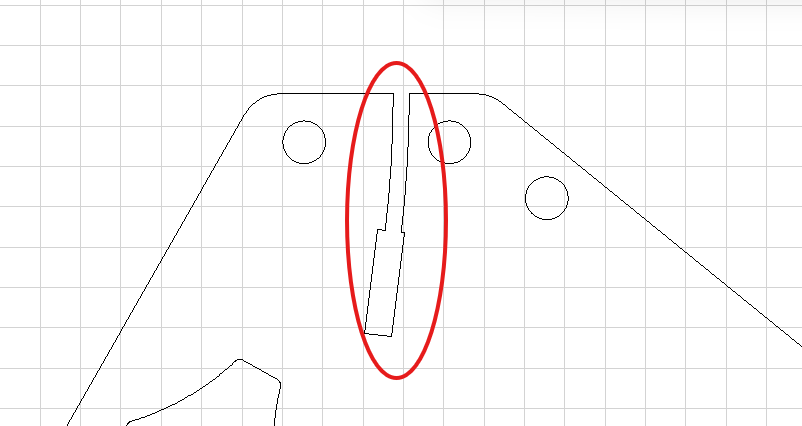

I’d like to cut out some new XZ plates for an LR4. On the Min plate, how are others milling the groove at the top where the Z cable goes? See image attached. I’ve 3.18mm/1/8" bit but the slot at the top is 2mm - is a smaller bit viable when milling aluminium?
I’ve search the forums but I feel I’m not using the correct terminology.
Thanks!
frank.
You can mill it with a 1/16" bit or just cut it with a hacksaw/band saw. It is not critical. Technically, you do not even need it if you put the stubs on after.
