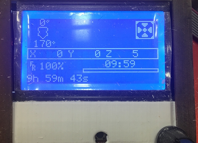

I started with the V-Carve test just to get it out o the way. ESTLCAm figured it just over four hours but the LCD status bar looks like it’ll be under the 4 our mark. It’s showing promise surprisingly too. I was skeptical for the first 10-15 mm of Y cut but once I saw the details starting to come out I think the method might have merit. It’s not a time saver. I told ESTLCam that the bit was a .7mm ball end with a 3mm z step and 45% stopover (although I’m not sure how the tool-defined stopover and the stopover % defined in the free machining dialog relate to each other).
This is 12mm Corian. I made the STL 5mm thick, set the max z to 5.5mm and stepped the model down 5mm which should leave about 1-1.5mm at the thinnest. No presurfacing of the material. The first cut was heavy but after that very first line it’s just nibbling off little bits as it goes (ridiculously low stepover).

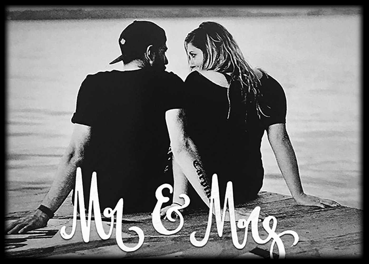

Here’s the image, contrast adjusted and black border put around to try to deal with the margin ESTLCam (set to zero for this test). The artifacting was from the original - I could have fixed it a bit but this is a freebie. And it’ll be interesting to see how the cutter handles it.

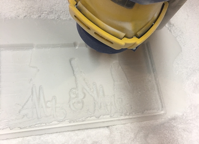

And here’s what it’s looking like after an hour and some:
[attachment file=96016]
I’m working final size in the off chance it works - then I’m done this one. It’s Sunday, nothing better to do than listen to the Dewalt buzz away.

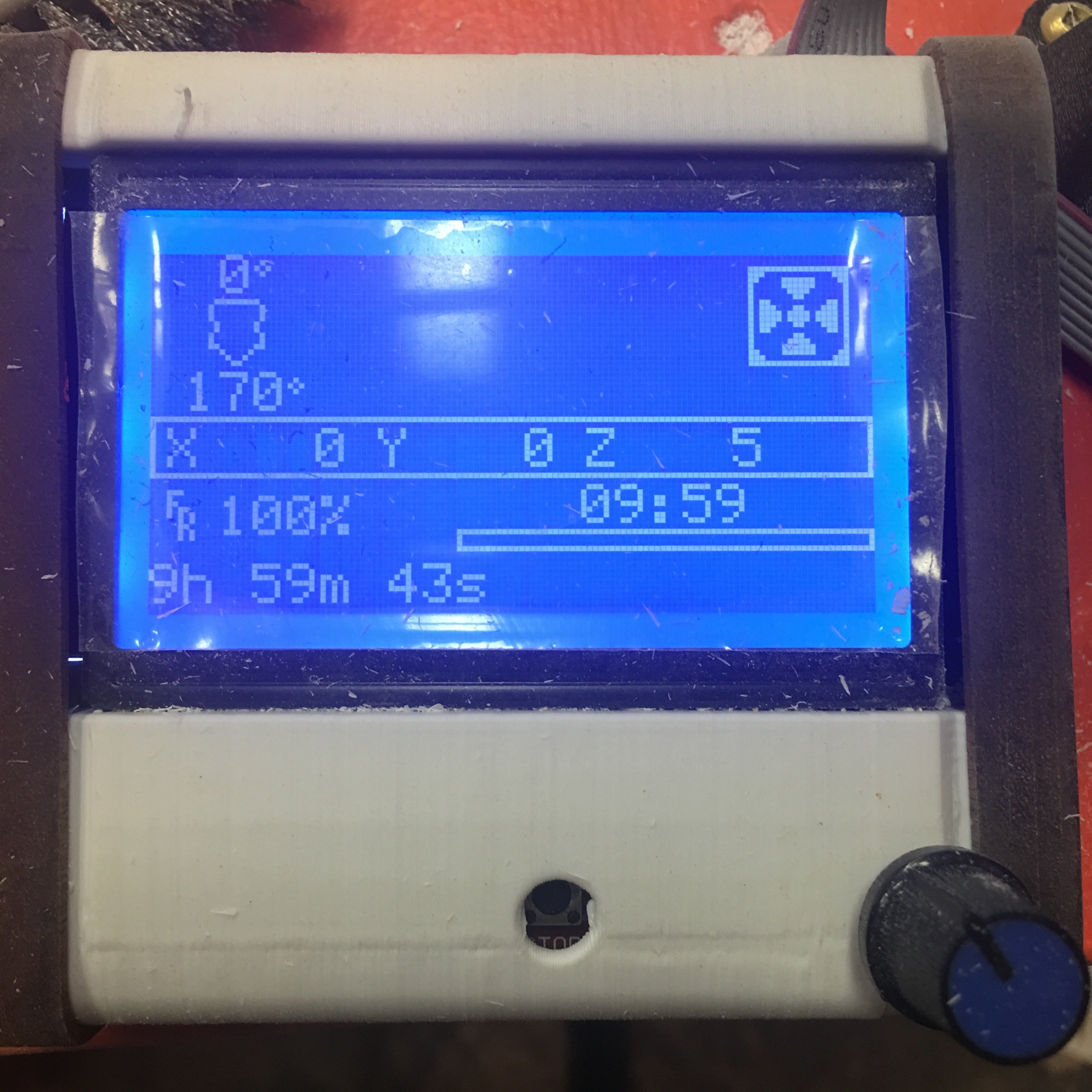

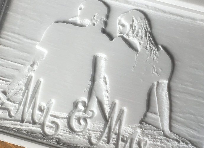

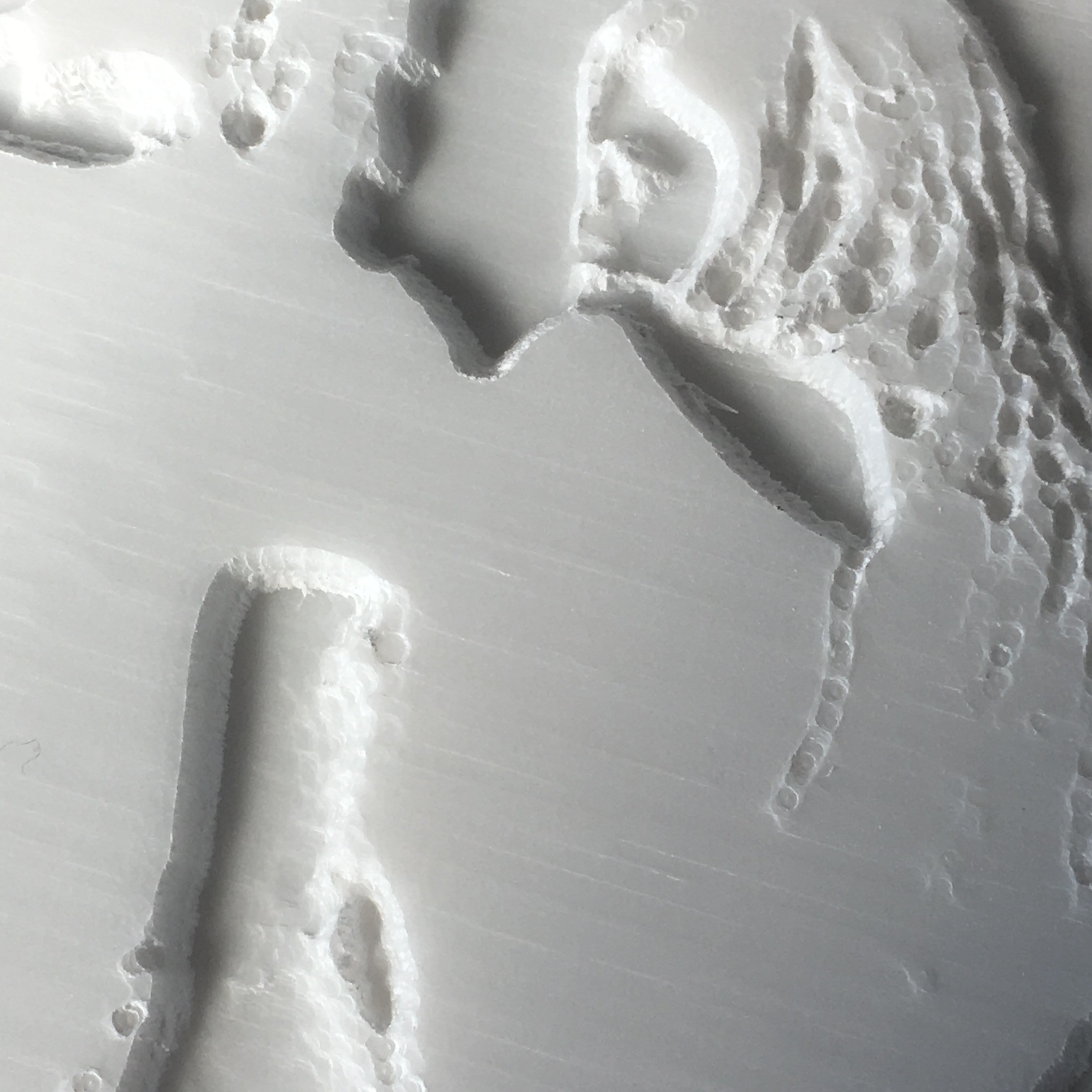

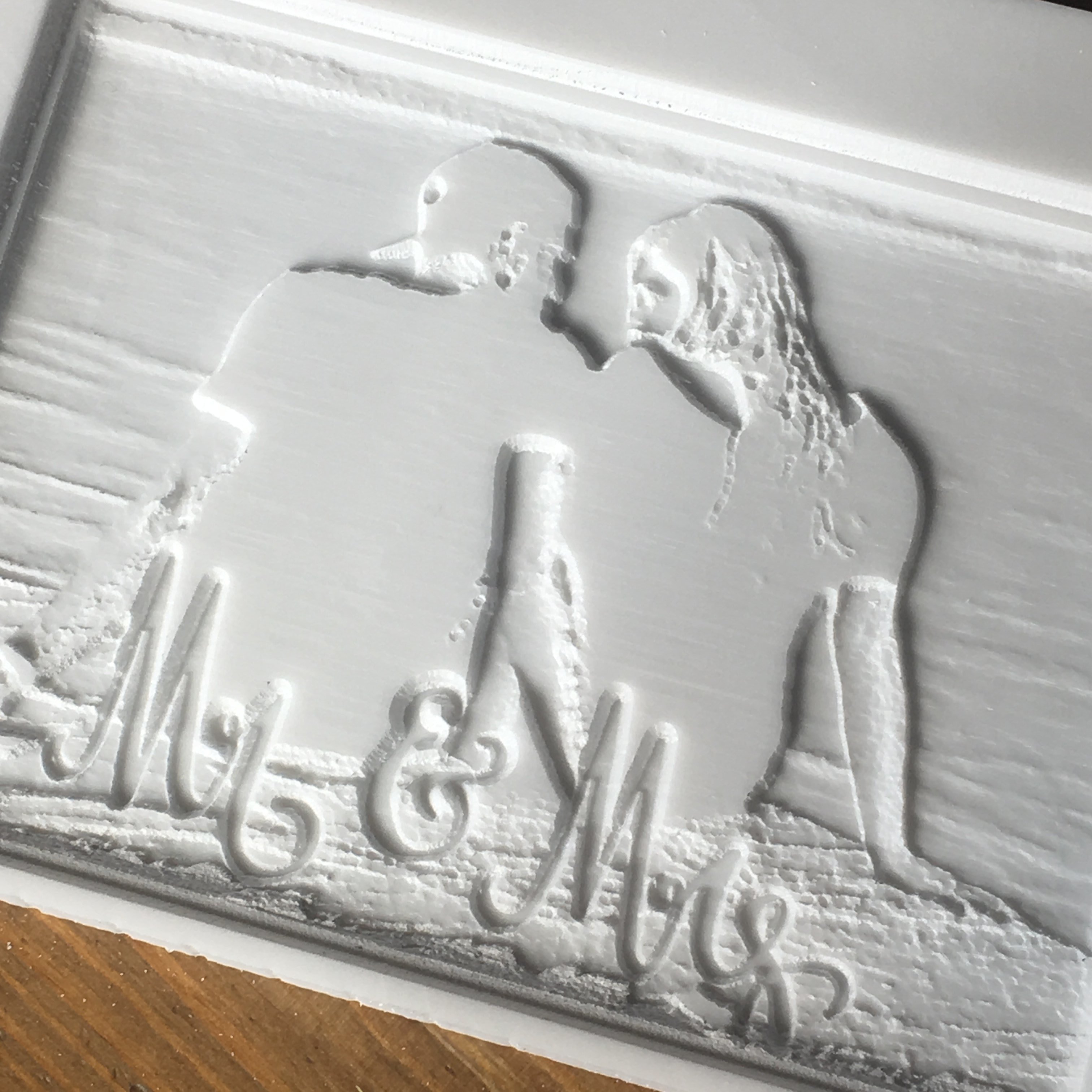

I think the ESTLCAM guesstimate was right. 4:17 in and just about finished to the shoulder level. Hahaha. It’s still looking promising though and the large black expanses feel very smooth to the touch.
[attachment file=96042]

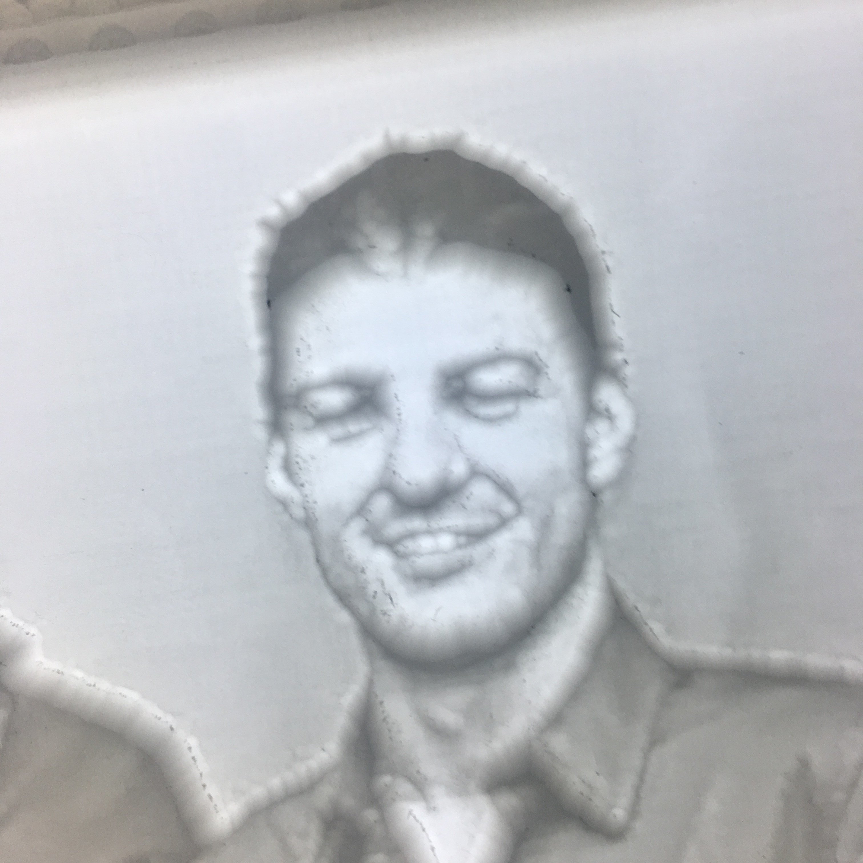

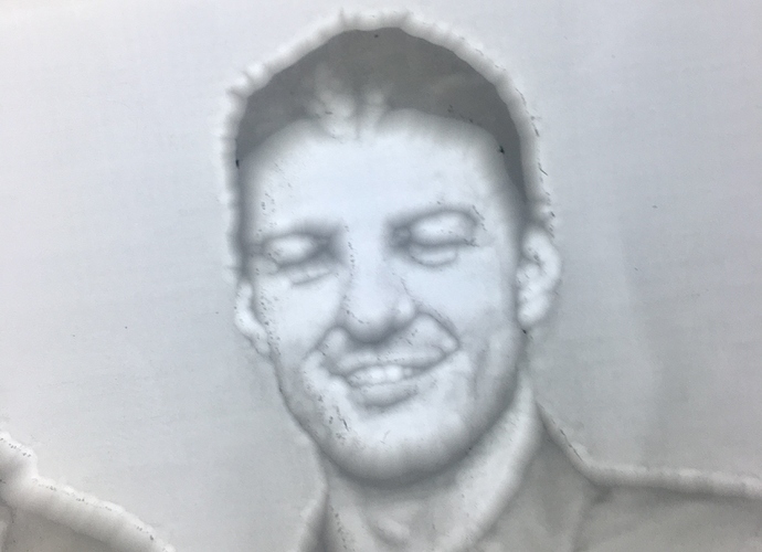

Well I’d call that a success. This was a 60 degree V bit and from what I can tell if I used a 30 degree instead, the vertical separations between black and white would be less stark but you don’t really need absolute vertical.
Total milling time was 5:46 so quite long. The next test which will be this evening and tomorrow morning will be using a 1/8 flat roughing pass and a 1.5mm flat finishing pass. That’s the finest I have currently. Different photo so not a direct test for comparison. Just final finish vs machine time in general.
Looking closely at this one it looks like I could reduce the thickness in the STL - the woman’s eye could use more detail. Of course part of this is the shoulder of the bit used here and the depth of the STL (4mm) as well as the high contrast image.

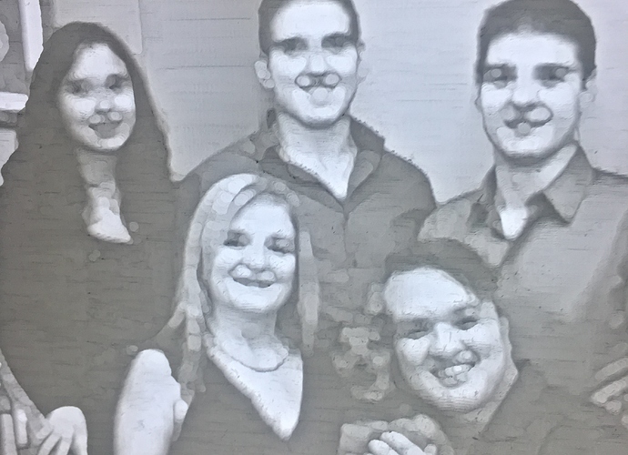

[attachment file=96286]

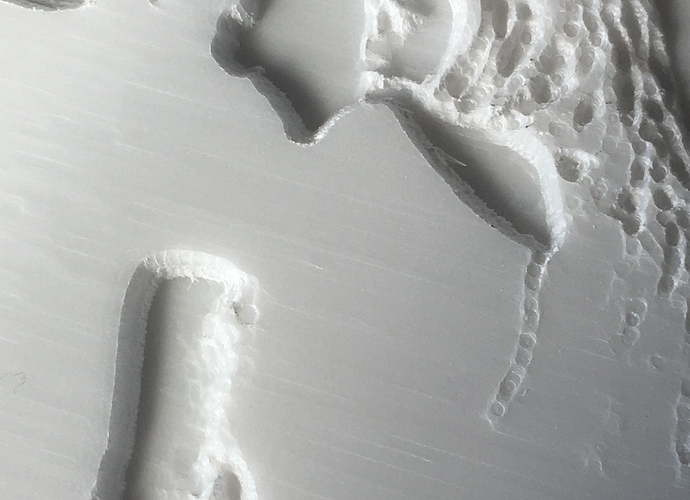

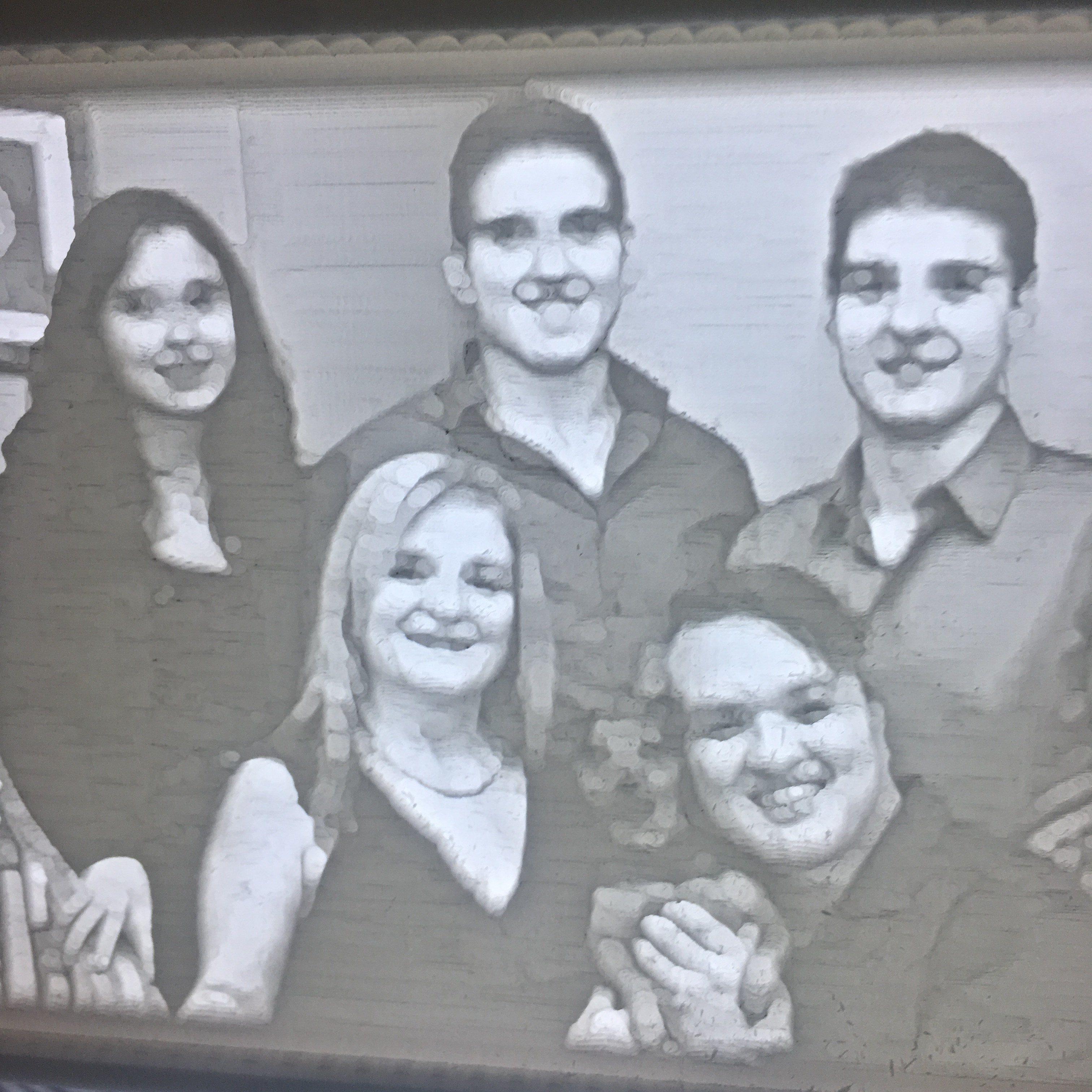

Here’s the first one I did last night. Used the 1/8" flat end mill for roughing and the 1/16" flat end mill for the finishing. This means the bit is still about 1.5mm dia and it shows in the image. It looks like one of the poster daub filters in Photoshop. Close, but not close enough.
[attachment file=96287]

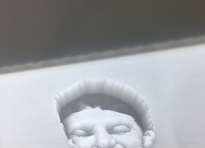

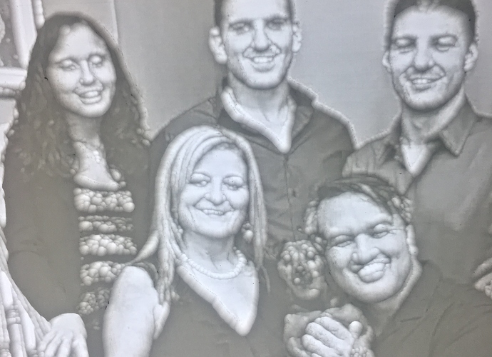

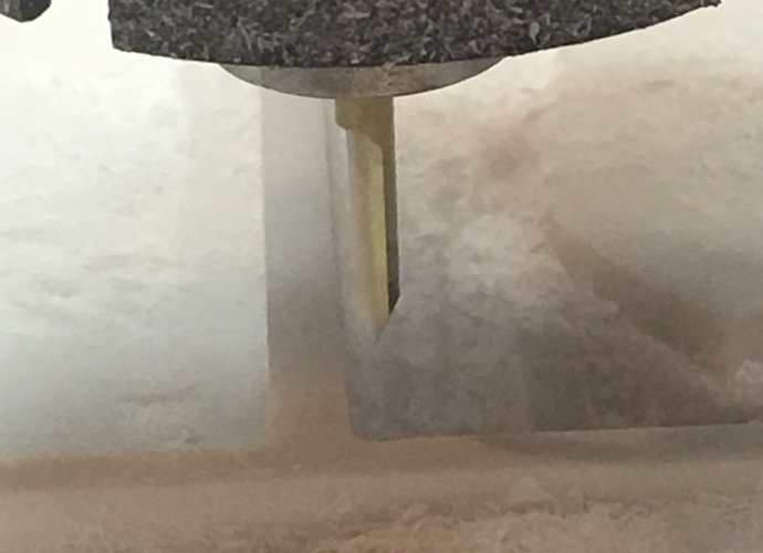

So I re-ran the roughing pass on a new spot on my test piece and then recreated the finishing pass using this bit (I THINK I got this from Ryan?? If I did, it’s a 1/8", 45deg v bit):
[attachment file=96288]

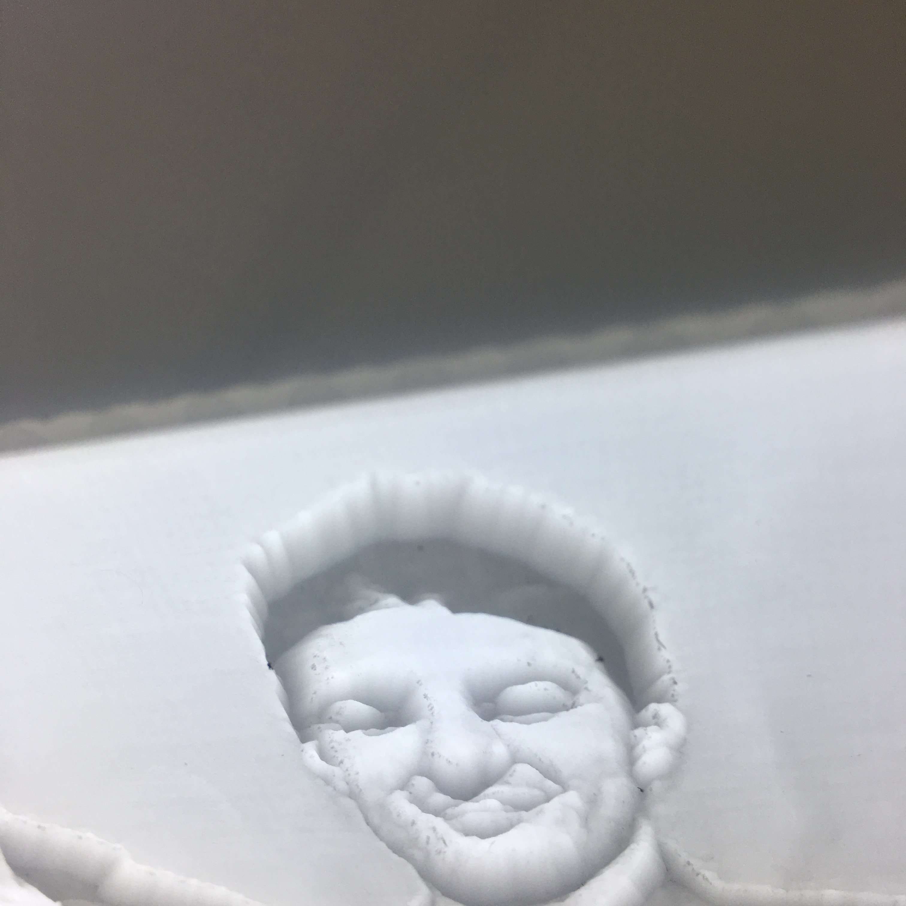

I set the bit up in ESTLcam as a 0.4mm 45degree bit with a 2.5% stepover. All other parameters “standard”. The result:
[attachment file=96289]
I could visually see the change in the amount of detail coming out while it was running. The ladies’ hair, the details on the girl’s shirt on the left and the facial features. Such a difference!
Now have a look at dude top right. See how his hair shows the angle of the bit I used? The instructions I started down this rabbit hole said he used a 30 degree bit and I know that would minimize this ledge angle I’m getting here.
[attachment file=96290]
Still, looking dead on, it looks great. Oddly if you look from side to side the way the faces are cut into the dark hair, they sorta follow you around like those Jesus pictures where the eyes follow you around. Kinda cool, kinda creepy.
[attachment file=96291]
One other thing that I will try and am certain it will make these perfect is to drop the thickness of the lithophane to 4mm instead of five. That, combined with the 30 degree V should minimize the angled ledges enough to be passable. I did read somewhere last summer about a guy that blurs off the edges where steep ledges would form - that’s a possibility too. You just need to minimize how much of the edge of the cutter gets put into service.

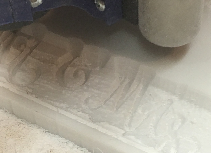

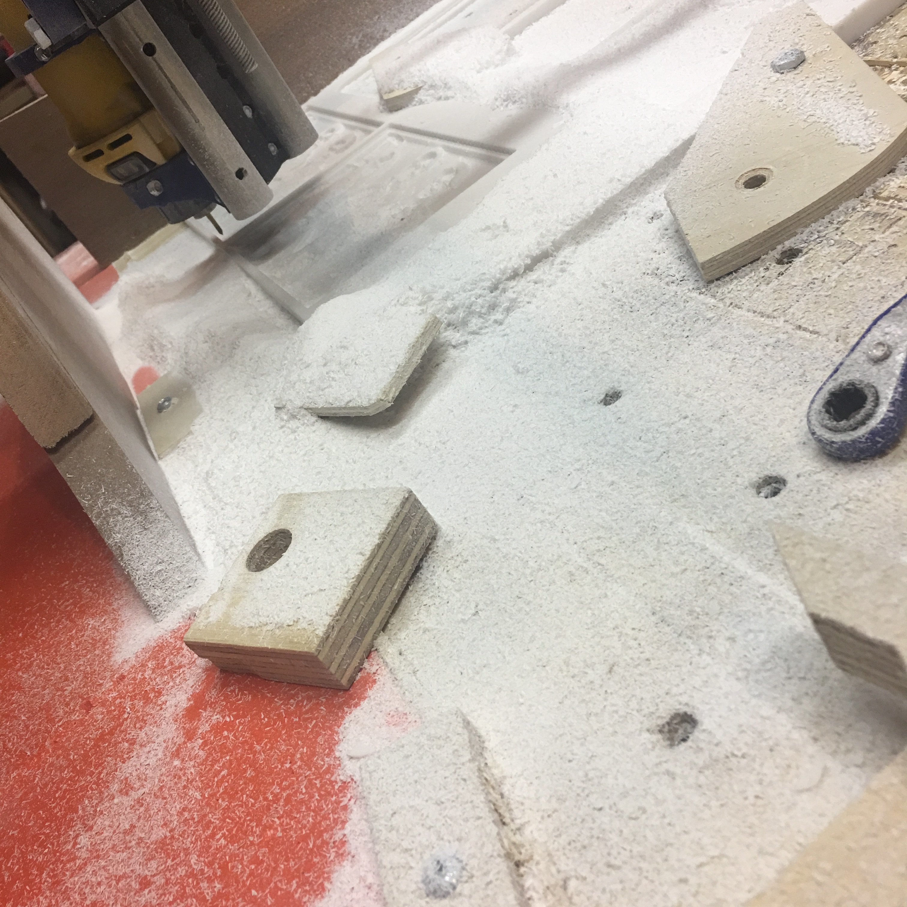

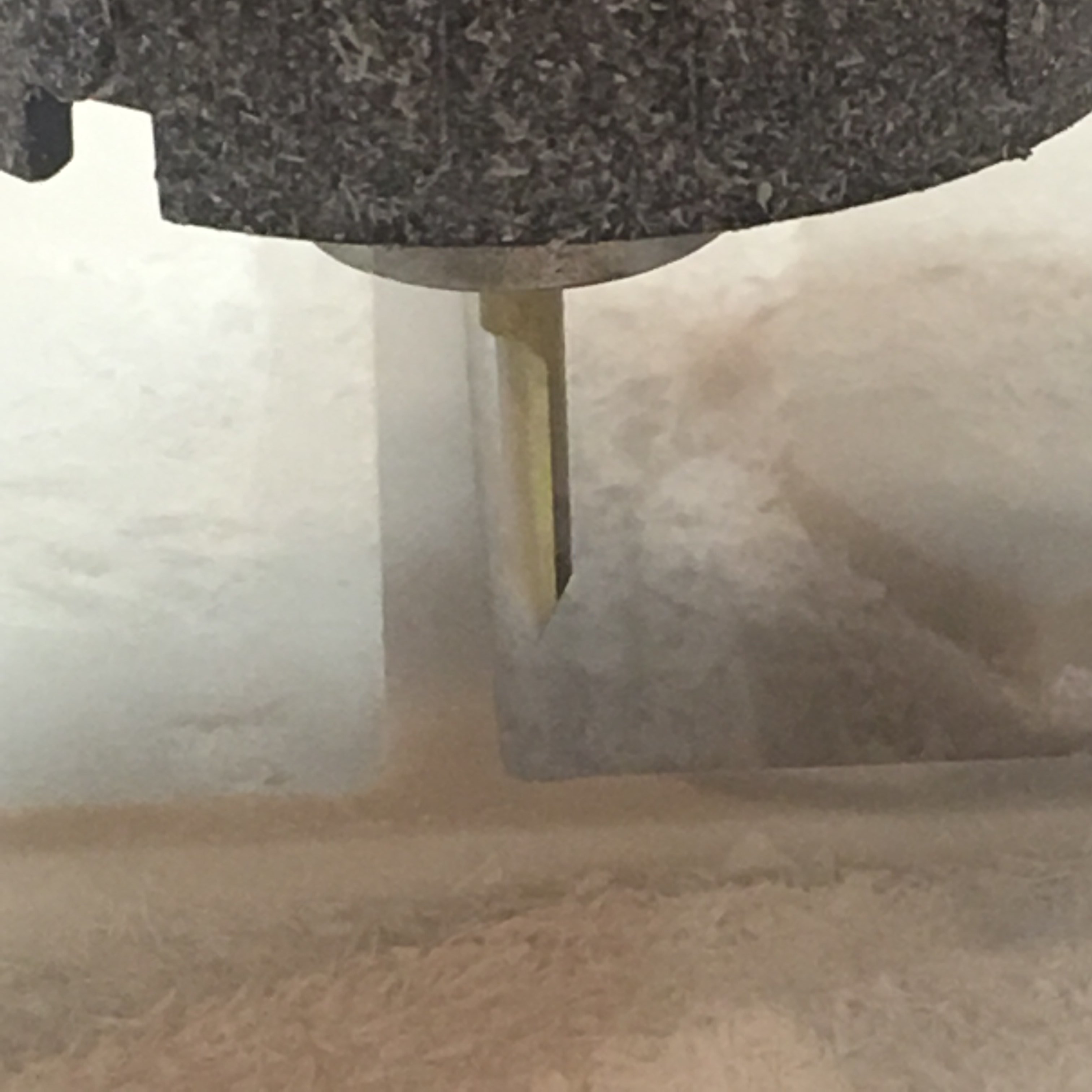

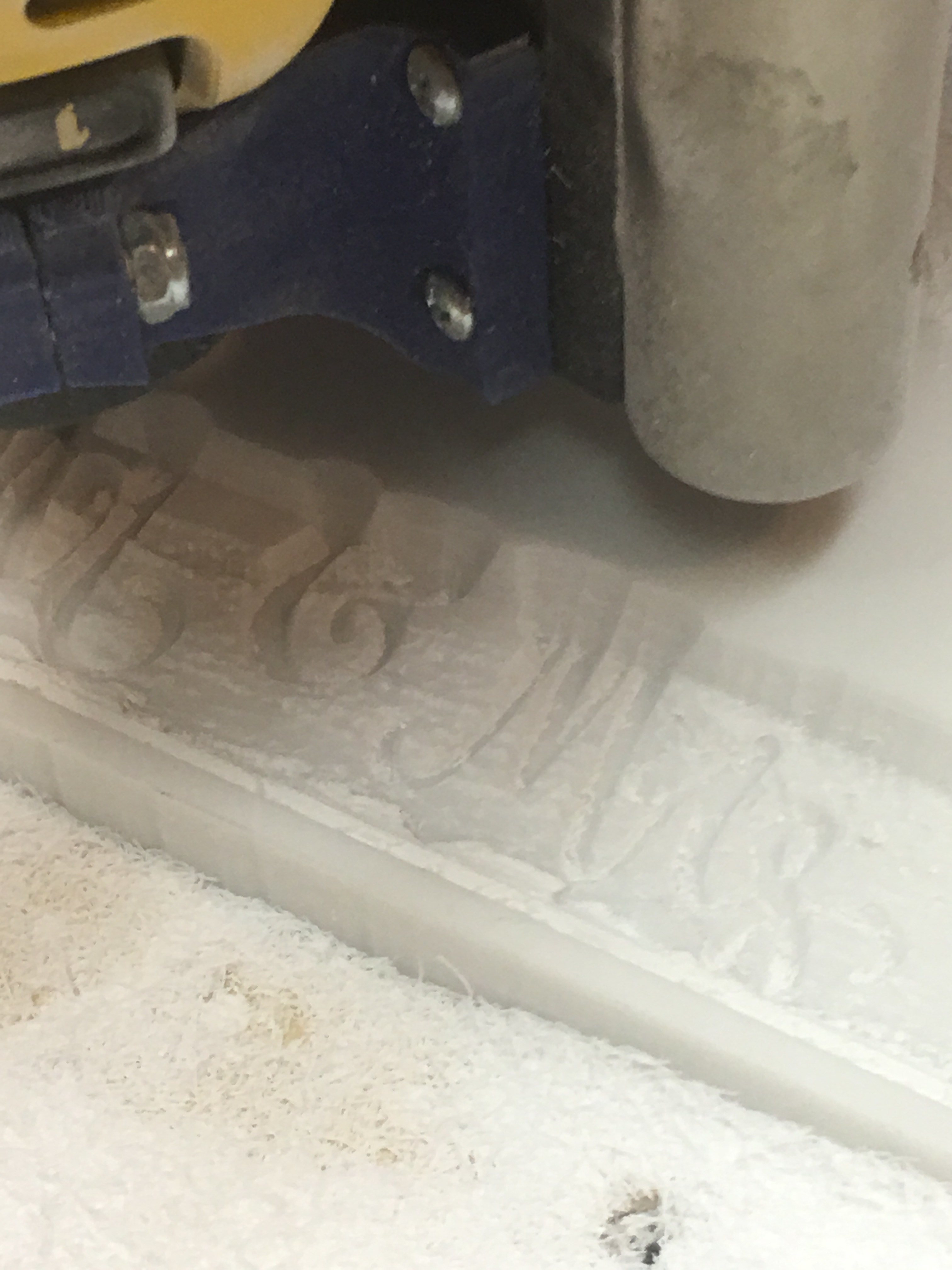

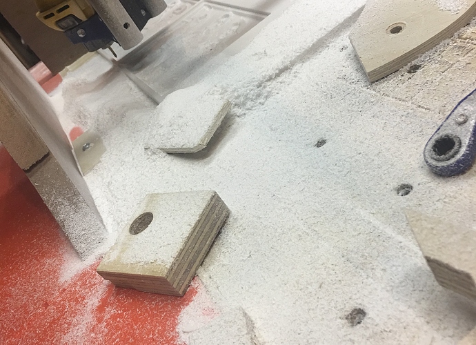

Fun fact about the Corian…it makes snow! The low stopover makes for a very fine cut and the stuff just powders off. I’m actually going to remember this and will certainly use some of it for use with my stop motion stuff (one day…that’s way down on the round tuit list). Ironically it’s not the first time my MPCNC has been snowed in. But last time it was REAL snow. HA!
[attachment file=96292]
The roughing passes create very coarse strands of Corian which are statically charged so they stick to EVERYTHING. Including the rails. The machine needs a good cleaning now - both axis are rough rolling from impacted material on the bearings and tubes. It does clean off well but definitely gets impacted.

Beautiful work!
I am curious, what does it look like if you illuminate from the opposite side and view flipped? I am seeing halos along the edges that my brain cannot explain with physics. I am wondering about lateral diffusion of light in addition to the usual darkening due to thickness.
The halos are just the angle of the ledge there. Where it steps from black to white it should be a vertical edge but with a V bit you cannot achieve that so you get an angle instead. This causes the halos you’re seeing. I feel that if I reduce the depth of the STL file to 4mm and then use a tighter angled bit (30 deg) I should be able to minimize those artifacts.
Lighting lithophanes from the other side makes the visual very diffused and blurred as far as “they” say. I’ll try it though and post for all.
My neck hurts now.
Impressive work though.
That’s weird, I thought the dark parts were supposed to be the tall parts and the light stuff was the engraved.
Weirder still - it IS! I think the angled ledges create some odd perspective shift that messes with you which is why the girl on the left looks like she’s turning her head if you rotate the image slowly. I should try to video that. It’s crazy.
