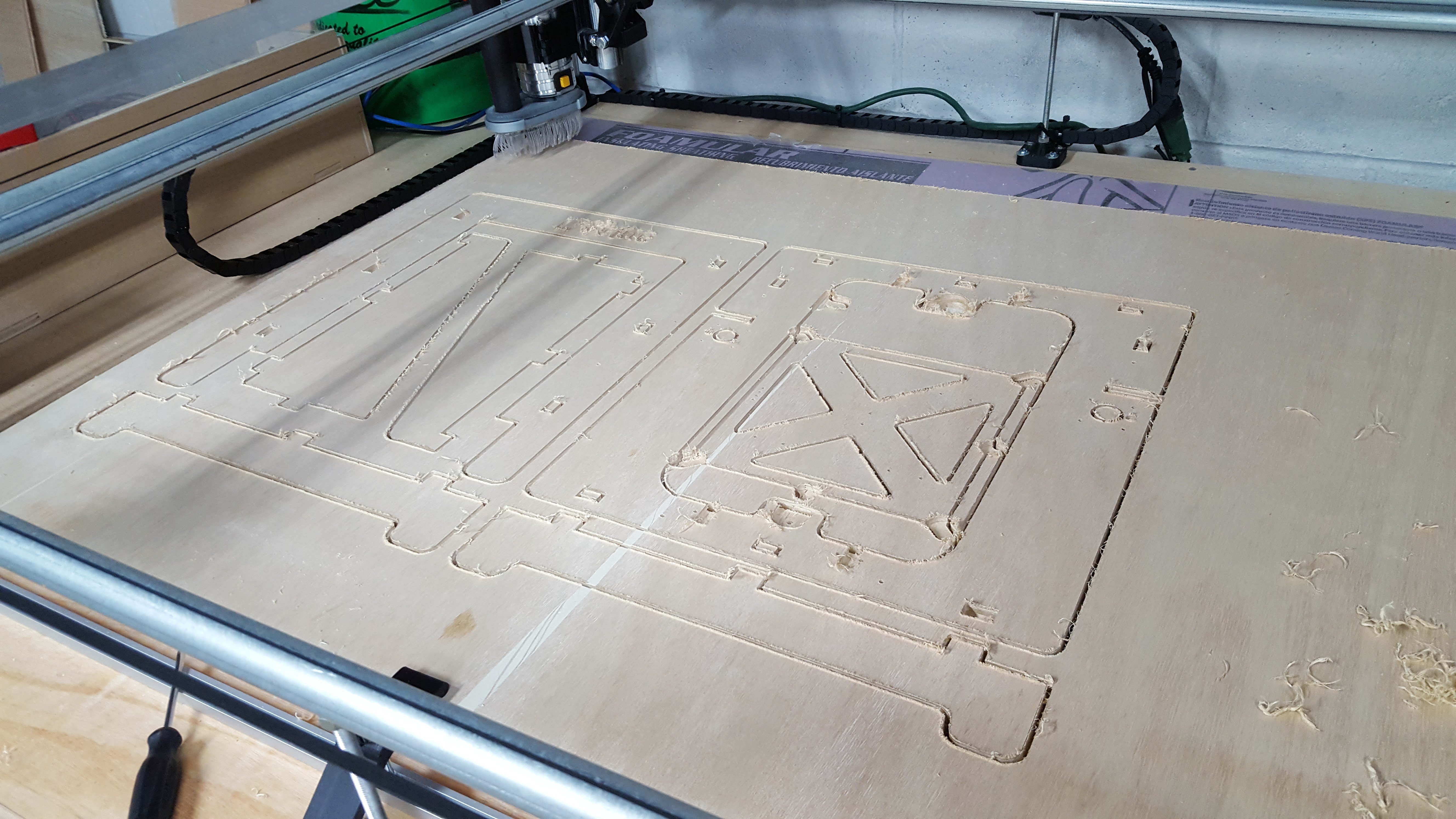

Just wanted to share a few projects that I have done with my MPCNC. One of my favorites has been an iTopie 3D Printer that I cut on my MPCNC. I then created an enclosure for it and have it exhausted out of a dryer vent. I have also attached another project for storing hardware (nuts/bolts, screws, etc.).
Love the idea of the itopie, is it working well? That hardware storage is on my list of things to do as well.
I have only had the iTopie up and running for a few weeks. Structurally it has been pretty solid and mechanically it has been fine. My other printer is a P3Steel so I don’t think its a fair fight versus the iTopie. My goal on the iTopie was to try out a 0.8mm nozzle and really up my extrusion volume game. I have a regular e3d v6 and I have been fighting the max extrusion volumes… got a volcano kit on order to hopefully get them volumes up
