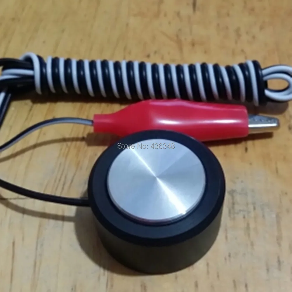

What is the benefits of using expensive piezoelectric touch here instead of usual contact?
Imho i’ts to lightweight to stay flat on a material. Wires will turn it every time. And same time it too small to hold it by finger
Usual being? I use metal tape and a magnet. Always replacing the tape and any sawdust gets under it so the reads can get tweaked if you are not super careful. This is sealed, and could be wired cleanly.
It takes enough pressure to trigger that the bit will push it down before it would trigger if it was up at all. The flat ribbons are nice to hold and can easily keep it in position. It is about the thickness of two overhead transparencies/acetate. It isn’t piezo it is a tiny bare contact gap (sealed).
Ok, it’s not piezo. Then it shouldn’t cost $16.
You saw my probe. It’s piece of metal 50x50 mm, it has enough mass to stay at the place where i put it and same time it’s big enough so can hold it by a finger if i want.

So this little piece of something juts not looks to me as something handy.
You asked about an opinion, that’s it )
I do like the style you have but the others can be had complete for under $2, and maybe less in bulk. That was just the amazon link I used to buy the R&D (quick) testers. With materials any paying someone to solder and crimp your style would cost me way too much. I have a slick version I have been meaning to make for the people that want a fancy one one but this pressure pod might just be a great option.
Yes, i agree that the device you showed has big advantage - it’s ready to just put it into the kit
And your device could be used for 3d printer mode.

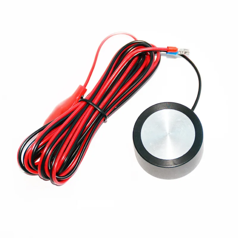

Just for note aluexpress full of such cnc probes with price from $2
Disadvantages are it’s too tall and you have to make Dupont connector by yourself.
This is same item for $3 seems has connectors
Tall ones don’t work for me. I never have that much room above my work. I always shim teh material up as high as possible.
