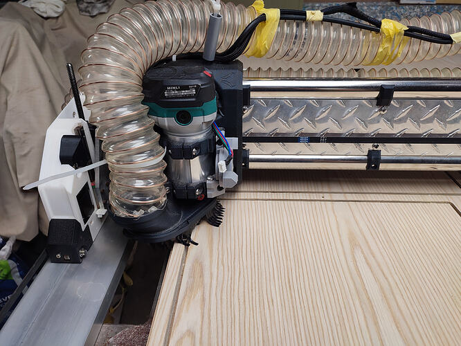

I’ve cut my ones out of aluminum checker plate while still using temporary strut plates. my one is full sheet size machine
I can’t remember the exact cut parameters but something like 3mm single flute end mill 0.1mm depth of cut and high feed like 2000mm/min. the trick is to move as fast as possible with the very low depth of cut to keep cutting forces low but still create chip. also position the plate close and parallel to y rail
that was surprisingly easy but slow because i had to do like 30 passes.
replacing of the temporary struts with permanent ones were a pain but the time that you spend on it is negligible compared to the time needed to get the machine and CAM going and to be comfortable with it

3mm. scrap metal yard special :slight_smile:
cable management is still a bit of a mess. need to design the bracket to keep the hose higher from the core to make the hose to bend on itself nicely
It looks so good, I am sorely tempted. Are those stainless tubes as well?
I’m going with a drag chain on mine, with dust collection from overhead.
yes. 31.8x1.5mm stainless. there is no metal conduit available in NZ and everything rusts over winter so stainless is good
i have a steel welded frame under the spoilboard and aluminum rails on both sides. Aluminum rails are nice because they are flat. not sure that the metal frame was worth it. It was a bit of work to cut and weld it. so cannot recommend it to everybody
fletcher steel do a furniture tube, which if remember it is 31.8 , after 2 yrs only just getting slight surface rust now , the stainless does look cool though
one thing i noticed with over head hose it can effect tramming , i designed this to stop it pulling on bottom of dust shoe , cable ties into existing slots on core , than couple cable tops around hose

used an oval coat hanger rail from bunnings designed some runners to go on rail , works quiet nicely hose runs freely
