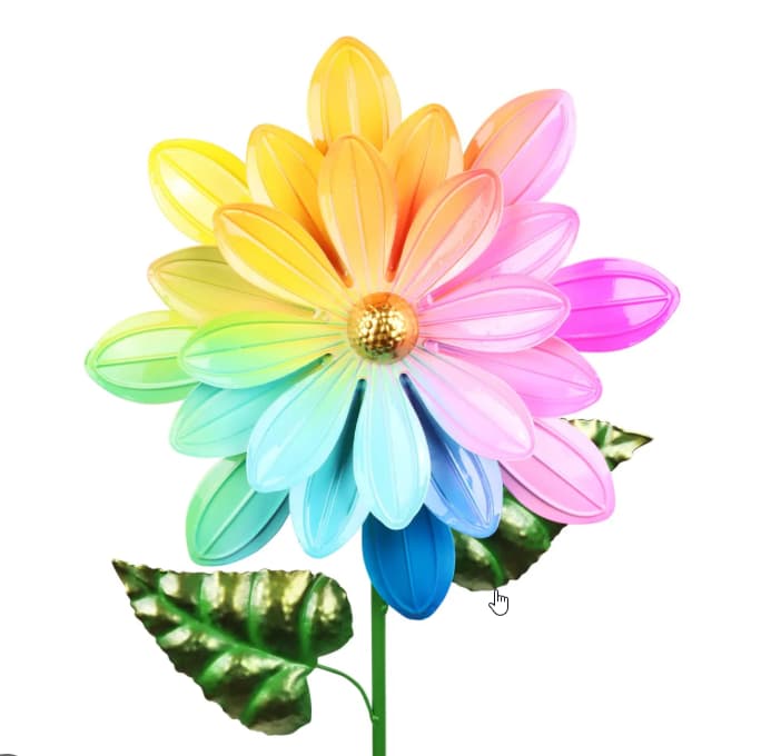

My wife wants to make some flowers like these for fun. I have a low rider, 3d printer, and lots of wood working equipment. I was thinking I could cut the thin metal out and then use some kind of mold either made out of wood or 3d printed and put in in a hydraulic press it to make the shape. I’m a solidworks user but modeling organic shapes isn’t something I’m very good at. Does anyone have good suggestions on how to make flowers like these?

The first photo provided looks to me as though the metal petals are simple profiles which are then either rolled (on the left) or a single bend added down the center (either of which would add rigidity). The visible veining patterning on the right seems to come from a surface treatment (brushed finish, angle grinder and flap disk?) which might be easier to accomplish before adding the bend.

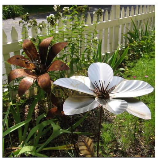

The second looks more die-formed to get the ridges on the petals. My guess is that they use a die to press the ridges, then another to cut to shape. If attempting to press these myself from sheet material, I’d try making a die with raised wire to form the ridges, maybe set in a slot routed to the shape desired. I’d have a hard time achieving the needed pressure in my shop, but I don’t have access to a hydraulic press or roller.
