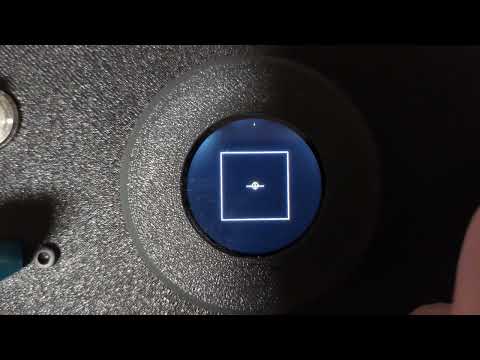

I started to Implement a simple framework.
Maybe I’ll make a video tonight showing the current status.
Currently, it is running on an ESP8266. However, the code should run 1:1.
I still need to integrate the FileSelector and a ConfirmDialog. Ideally, this should also be generic, so that you can simply specify in the menu entry that confirmation should be requested.
I plan to integrate two menus, one directly after homing the axes and one that can be called up during cutting. No handle button is pressed, and then the menu should open by pressing the encoder. Here, the feed rate can be set again to 0.0 or the process can be terminated.
The next idea immediately came to mind: the log file actually contains everything needed to resume a job after a power failure or scheduled break, as long as there is a homing bracket.
I started the implemntation.
Currently only presets works but it is possible to see that I have planned.

Current State:
What the heck?! You crushed that. That looks great.
I see what you mean now. Thanks so much for getting that framework started. I like the approach to have two distinct menus for “runtime” and “idle”.
That’s clean, I like it. It shouldn’t be too hard as long as the SD card closes appropriately upon power failure. The main thing would be to make the binary decoder on the machine side, but that framework is already built out in Python.
One thing that comes to mind when watching the video: what do you think about using a double-click or triple-click to trigger the “back” button instead of a screen element? That could make the interface a bit simpler
Yes, that’s no problem at all, it’s just the back function that needs to be mapped.I also plan to map the handle buttons for Enter/Back.

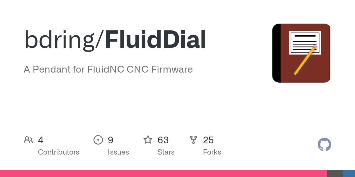

That is making the most out of that screen and knob. IDK why I never thought of this. But the fluid dial is a good example to look at, but it uses a wheel around a screen and has touch:
