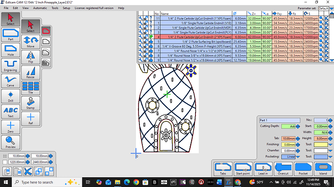

Measured my XPS Foam with a digital caliper, entered into Estlcam, bit drives 6.4mm further
Ok Gang,
I use this same method on 1” XPS foam (well, on any material I cut) and all work as expected except the 2” XPS foam. Stock measured 49.6mm. I entered 49.6mm into estlcam with my 2” XPS foam bit selected. it drove the Z to 56mm, which is now a good bit into my MDF spoilboard and needless to say derailed the gantry at the feed rate for the foam….. the immediate fix was to subtract the difference and re-output the Gcode. BUT why is this happening? my guess would be in the bit settings, but they seem right to me…. (at $53/sheet for 2” XPS, I want to eliminate the guesswork….

Not likely, but your picture doesn’t show what total DOC you are specifying (shows “Ask”), so maybe you specified the wrong DOC for that particular toolpath?

the issue happens as soon as the z axis lowers to run the job. it overdrives in z before it has made any other moves. when I changed (cheated) the thickness of the stock (49.6mm) to remove the 6.4mm that was overdriven into the spoilboard, everything cut fine. I just can’t figure out why that is happening? and only on the large stock. everything else is 25mm or under….

Funny thing is I cut a ton of 2 inch foam last spring for Cinderella and had “0” issues. the only thing that has changed is an older (shop) laptop and Estlcam has updated a bunch of times…none of which should give this problem. again to reiterate, I get the stock thickness with my caliper, i enter it into estlcam (i always have estlcam ask for the total cut-through stock thickness because it ALWAYS varies.) it generates the gcode. I copy it to the micro SD card and then run the job. (It has already run the homing gcode) as soon as the z axis drops, it goes deeper than my settings….
and only for the 62mm bit…

Exactly, any thoughts on what in estlcam could cause what I’m experiencing? I’m leaning on it being something there since that is where I’m an endmill and setting a depth ….thats were the gcode is created. Plus if the homing code had issues it would manifest randomly and I would see if the homed position was off before loading and running the actual job….
