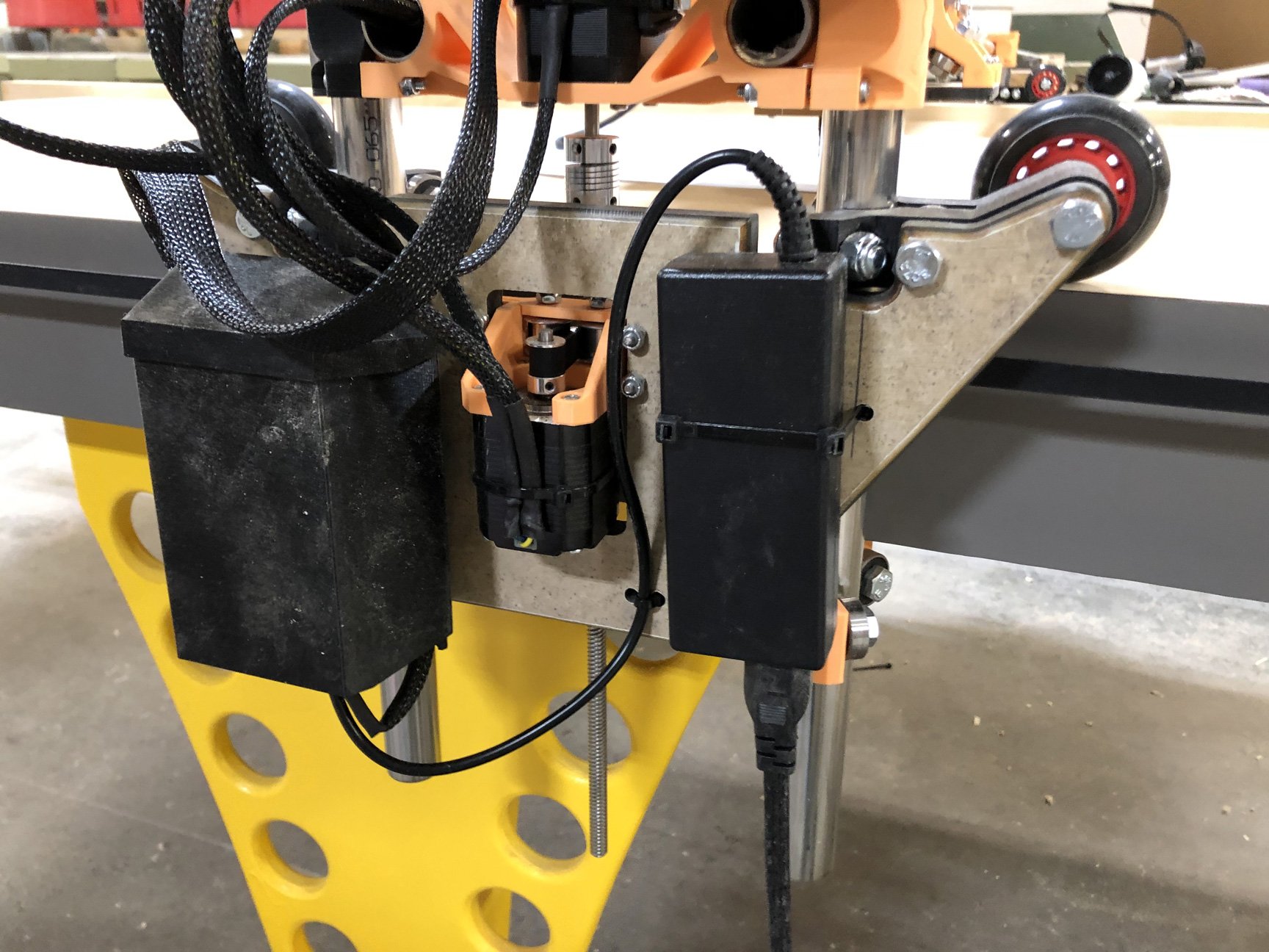

[attachment file=“2019-06-24 11.56.02.jpg”]
Holy crap
You win…I quit!
Looks Good. I like the colors. What are the rails made out of?
Thanks, rails are two layers of 5/4 x 14" Finger Joint White Pine, ripped to 5", laminated together and straight lined on the beam saw. However, I made them 4-1/4" tall not thinking about the limit of the carriage. Had to route away a quarter on the bottom for clearance. The table is 1/2" mdf top and bottom and 3/4" mdf for the grid. The grid was half lapped on a radial arm with a dado set. It went together pretty quickly. The legs took a while though.
Well, I cheated. I have a shop full of tools and since I’m the boss, I have time to work on what I want. Only advantage of getting older.
I wanted it to look like something I bought. I’m building a new shop and it will be right beside the office.
If it’s that beautiful now, can’t wait to see what it looks like finished! Looks awesome!
Amazing work…
What a great table build!
I am a little jealous of the shop too.
Ah! I see an MPCNC in the background!
How did I not see that?! That is how sexy that table is, wowzers.
Very Nice! I’m jealous of all your shop space!
More Pictures, construction of torsion box.[attachment file=104652]
[attachment file=104653]
Plates cut from 1/2" phenolic sheet salvaged from Chic Fil A restroom remodel.
[attachment file=104654]
[attachment file=104655]

[attachment file=104656]
[attachment file=104657]
Sweet! Hopefully they were off cuts of the restroom dividers…
Your minions wear red? I need to get me some of them.
Awesome pics and videos, makes me want to clean up the “dirty” side of my shop.
The phenolic sheet was indeed a USED bathroom divider about 5’ x 5’. Amazon has a 4’ x 4’ x 1/2" sheet for $864.00. I did clean it multiple times before even handling it. LOL. I planed a piece down to 1/4" for the 611 plate. Very rigid.
I know you cleaned it, but did you save any phone numbers? Jokes?
Awesome job, like a previous poster noted - I too envy your shop! Thanks for sharing!
“For a good time: visit v1engineering.com”
