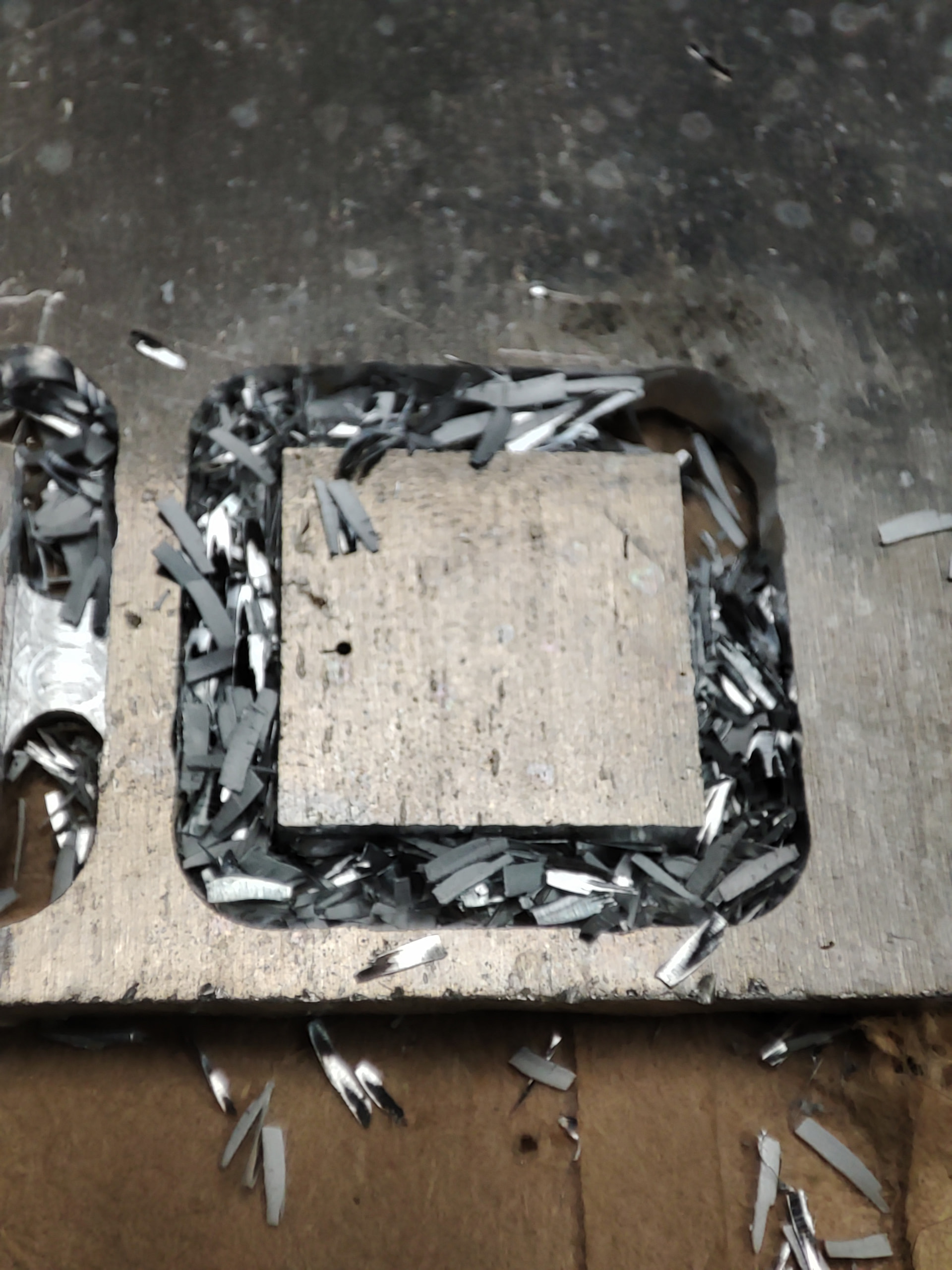

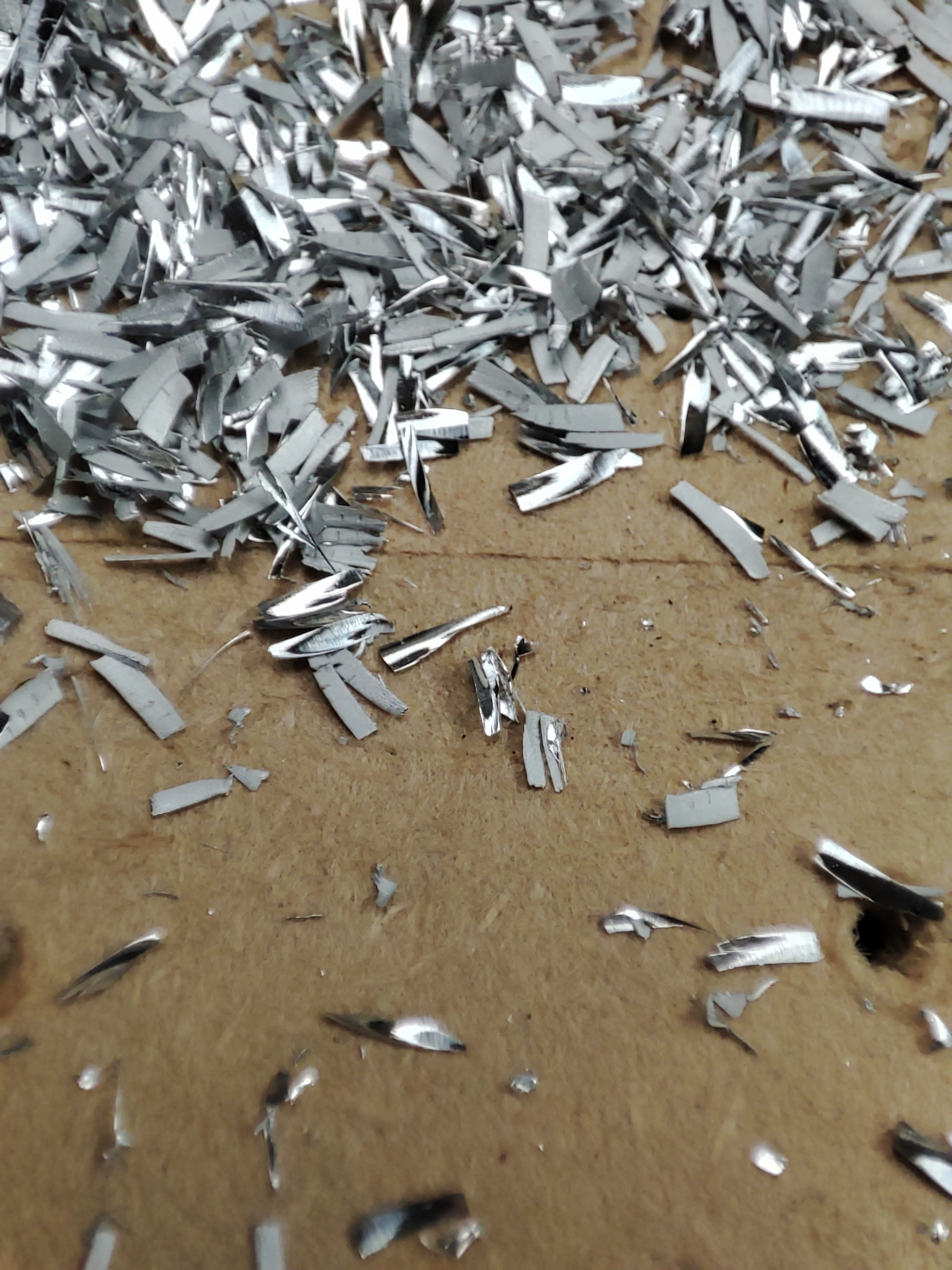

It actually may be not a problem as AI suggested to me initially. I did couple of test cuts on my Full Sheet LR4 and it cuts no problem with nice chips. The router set between 1 and 2. set to 1 initially but sounded happier when i’ve increased the rpm a little bit
3.5mm mystery aluminum checker plate from scrap bin. cutting in one pass 10% stepover
Those are some nice darned chips!
I read something somewhere… I think it may have been in ESTLCAM where basically for trochoidal, set your feeds as far as you can without shaking the machine. I think the theory is that the cut time is only like 5% of the tool path so the rest is essentially a very small rapid. No it isn’t a rapid but sane idea, the machine is moving around to take the next pass.
Not sure if that is worth anything to you, but it’s something I’ve read recently while looking into optimizing for aluminum.
