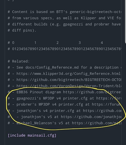

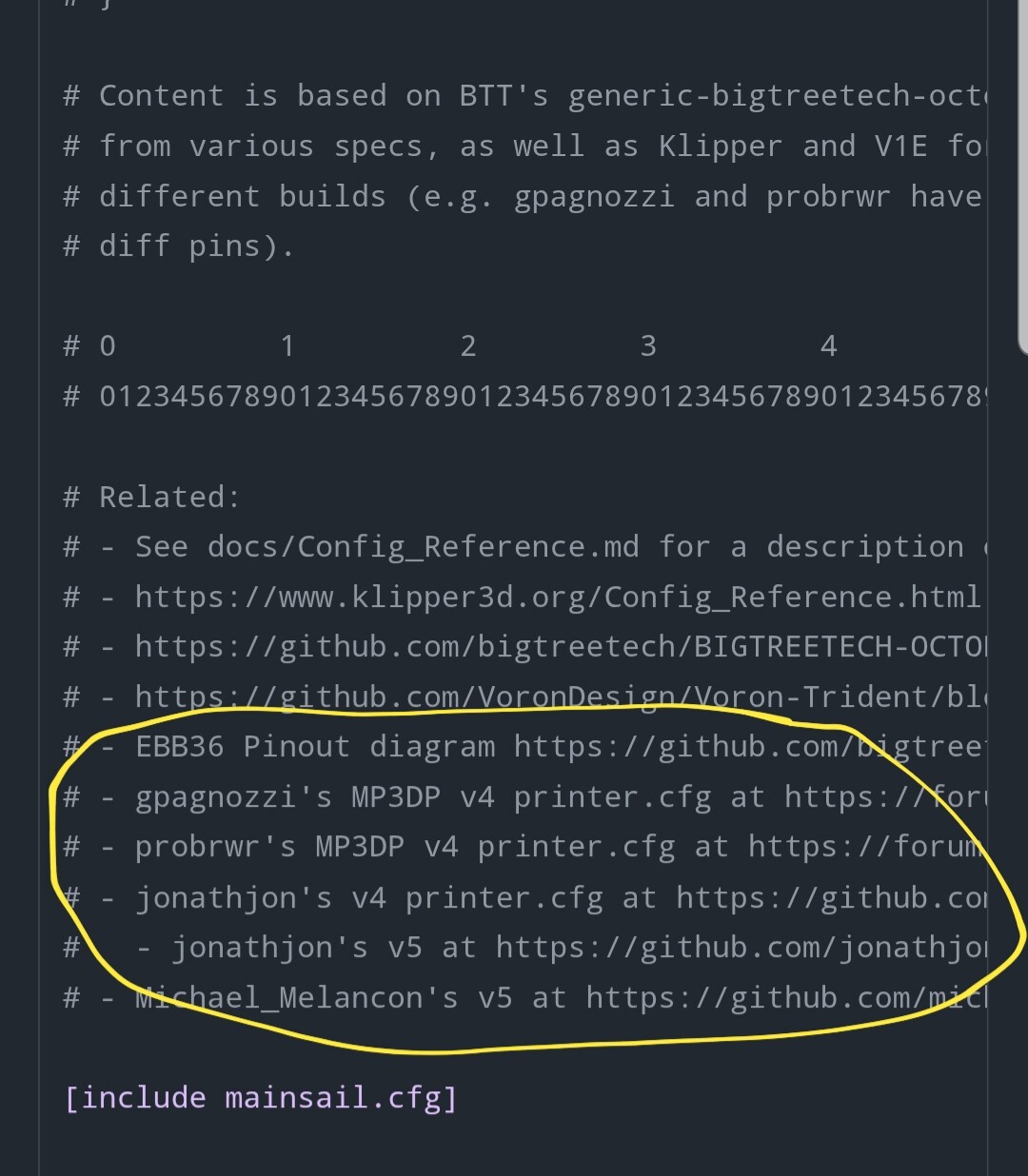

I believe that Aza’s config file is for a canbus setup, right? I am not using canbus on my printer.
Referenced some people’s configs in my config…
Thanks for this Aza. After looking through each one of them, it appears everyone is running a Manta M8P board and/or running a canbus system. I would be looking for an SKR Pro V1.2 without canbus.

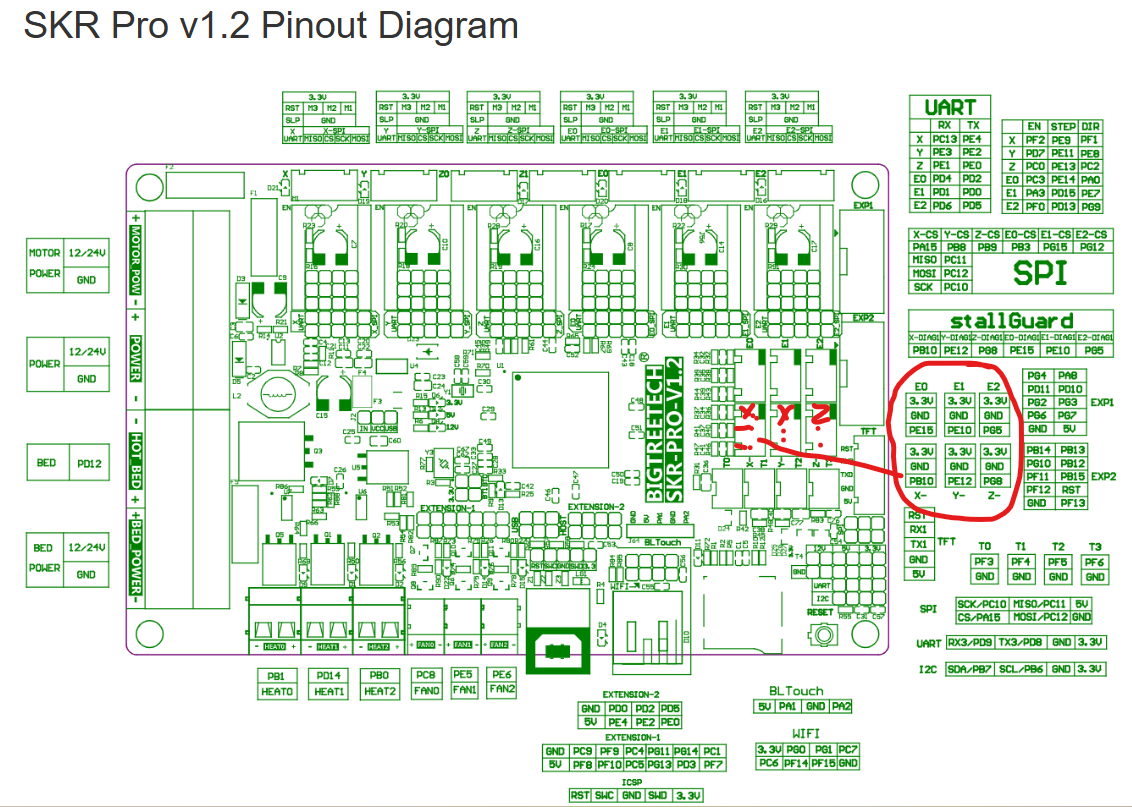

Is it a simple edit to switch the config from Manta M8P to Skr Pro? I am not familiar with the pin mappings.
Get a copy of the skr board pinout (google image search) and change the pin names to match and delete the can bus reference. If you get it wrong, when it tries to load it will tell you where the problem is and you just edit and click restart. It was a little intimidating at first, but is really straight forward. I learned a lot from voron documentation and klipper docs.

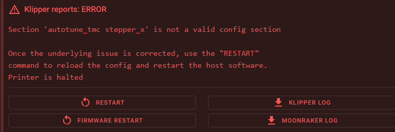

It also doesn’t like this section. Do I get rid of the section?
I’d just comment it out and restart.

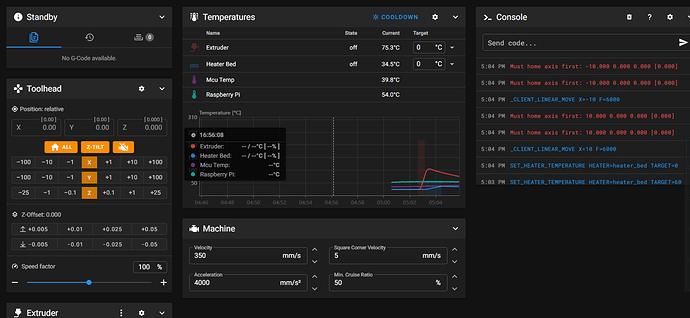

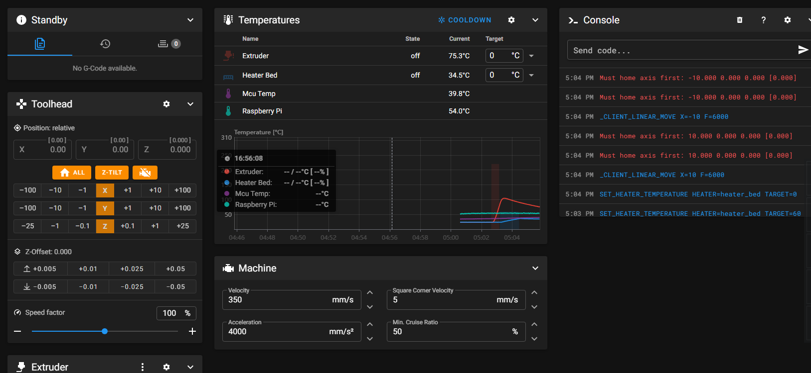

Okay I am connected (corrected all the errors). The bed heater and hotend are working. I tried to move the machine and it needs to home first. I tried to home it and nothing moved.
Safe to assume my pin assignments are not correct?
I notice different microstep settings as well. I remember from before that there are switches underneath the motor drivers where you can set the correct microstep. Do those switches need to be adjusted to match the microstep in config file for any reason?
I am getting no communication with the steppers or the endstops. I did QUERY_ENDSTOPS and was not getting any feedback. I feel confident that my pin assignments are correct. I think.

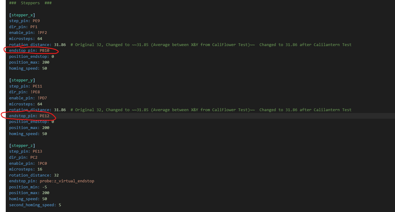

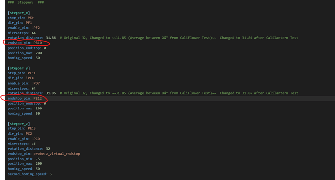

So now my axes are moving in the correct direction but still not communication with endstops. Any tips there?

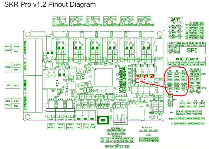

they are normally open endstops I believe. according to the photo:
are they wired correctly?
I may have not wired mine in a standard fashion, so verify X, Y, Z E0, E1, E2 and how they correspond with X, Y Z axis endstops.
according to the board pinout diagram above,
X would be PB10
Y would be PE12
Z would be none because you use a BL touch… If you plug it in to the board header for it, the code for that is here:

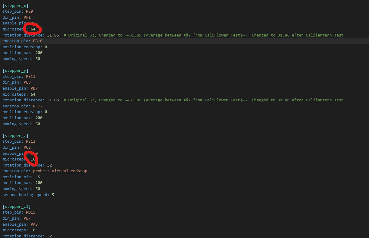

I feel like I am over-extruding now. When I was running Marlin, I had my flow ratio for PLA around 0.96. I am all the way down to 0.6 flow ratio while doing the tuning and it still seems to be too much.
Is it the steps/mm for the extruder? Is it something else config wise?
You should just be able to do the 100mm extrusion test to see how close you are. From there, there are test prints, if you want to get a little better.
Doing this now. I extruded 100mm and it went waaayyyyy past the 100mm mark. Clearly not right there. However, in the config, it is not steps/mm. It is set to 16 microsteps for the extruder. Should I try 32 and 64?
EDIT: Nevermind.. I see it is rotatation_distance in Klipper.
Getting ready to do this calibration myself, maybe tonight after work. I wish I could find someone who’d published a “close enough” starting point for the extruder I bought from E3D but everyone says “don’t trust other people’s numbers.”
Dont trust. Verify. But as an iterative start, it doesnt hurt to have a number in the ballpark.

Here is what I calibrated my rotation distance to. I have been printing perfectly since then. I should be all set.
