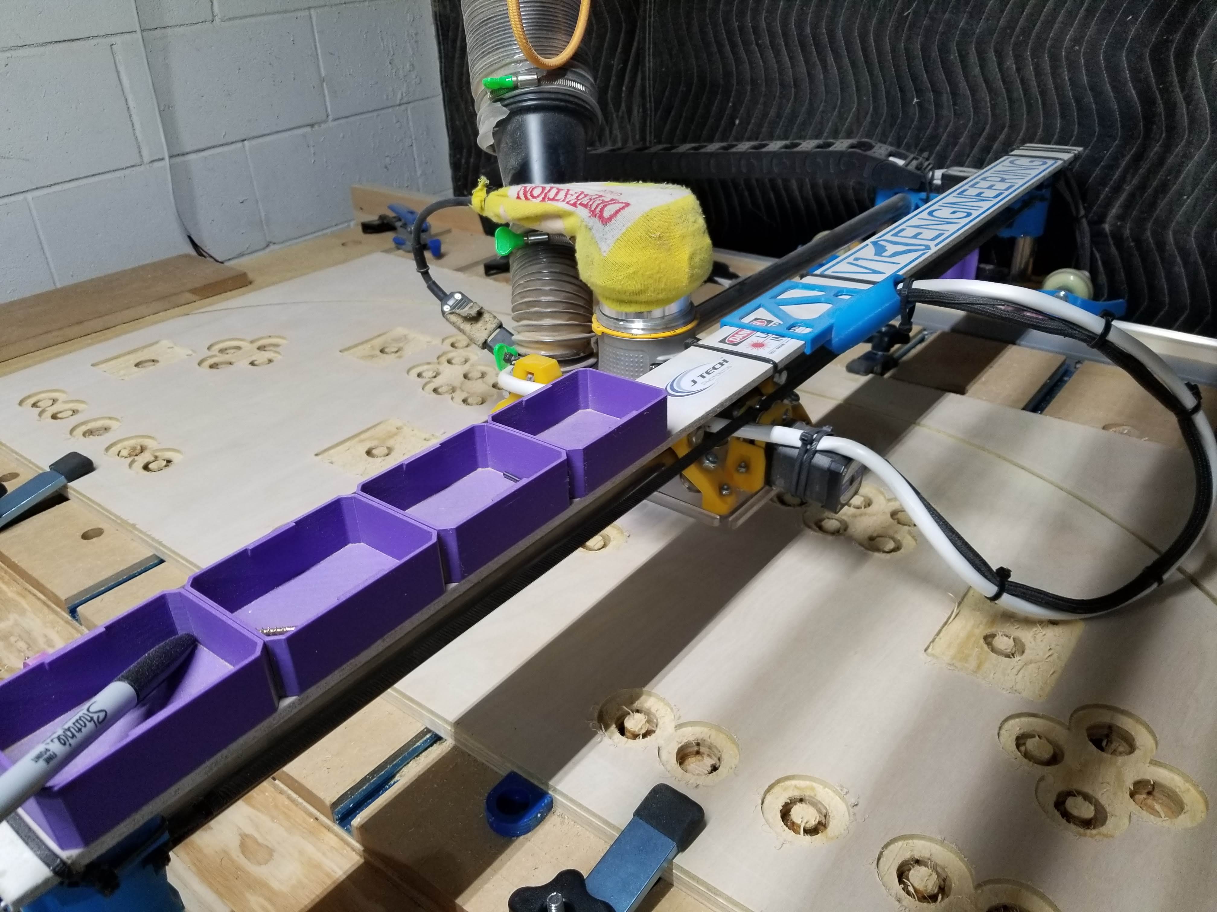

Setting up toolpaths
On the Lowrider
I cut out recesses behind all of the buttons and joysticks as I knew I was going to be adding a 1/8" protective layer over the artwork. This plywood is a bit hairy…
Milling the “glass” (polycarbonate)

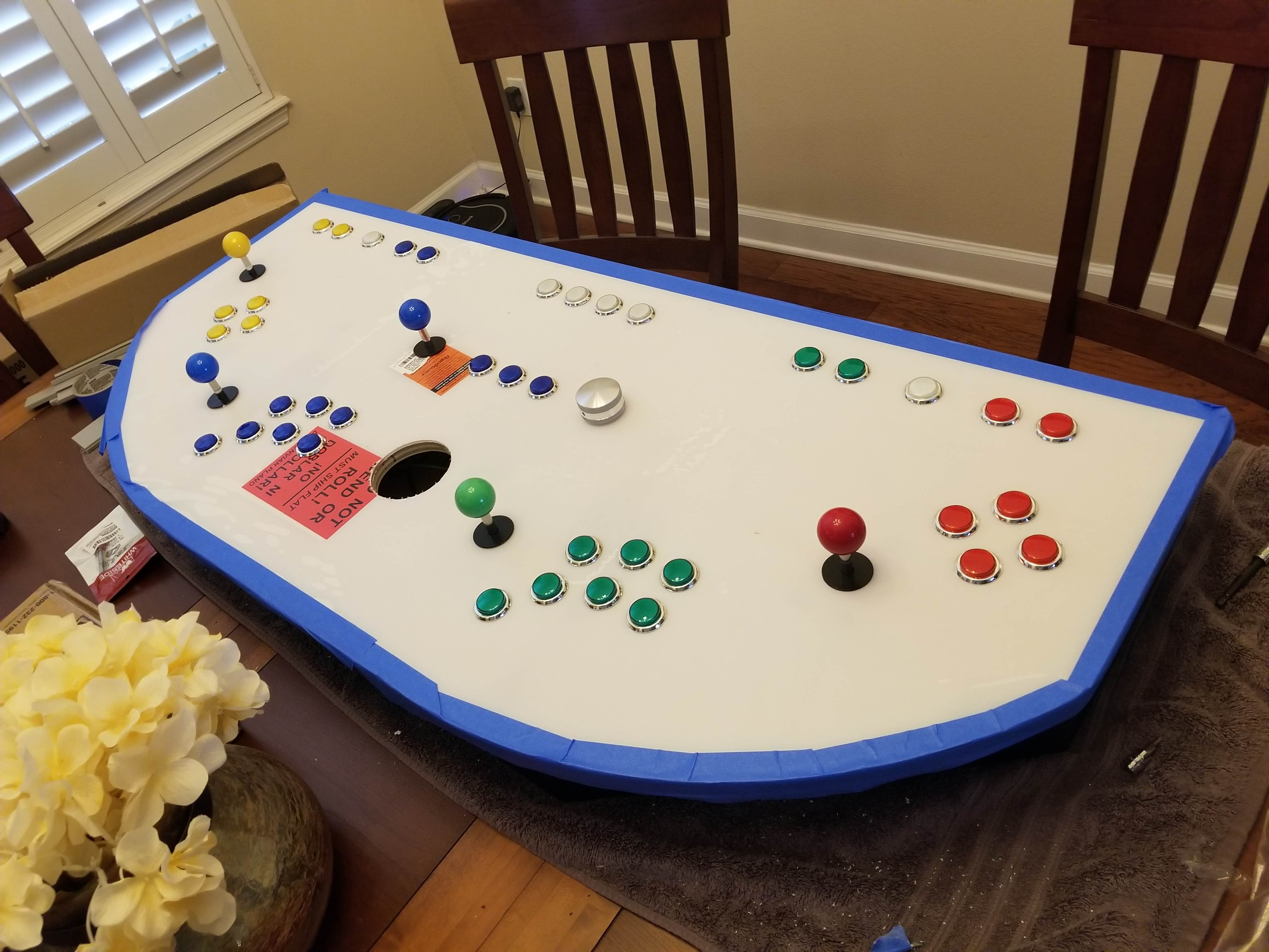

Some prep work (body filler and sanding sealer)
Completed box assembly + Fit test + Wiring up a hot mess

And finally, finished and trimmed…
