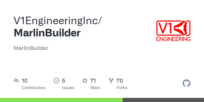

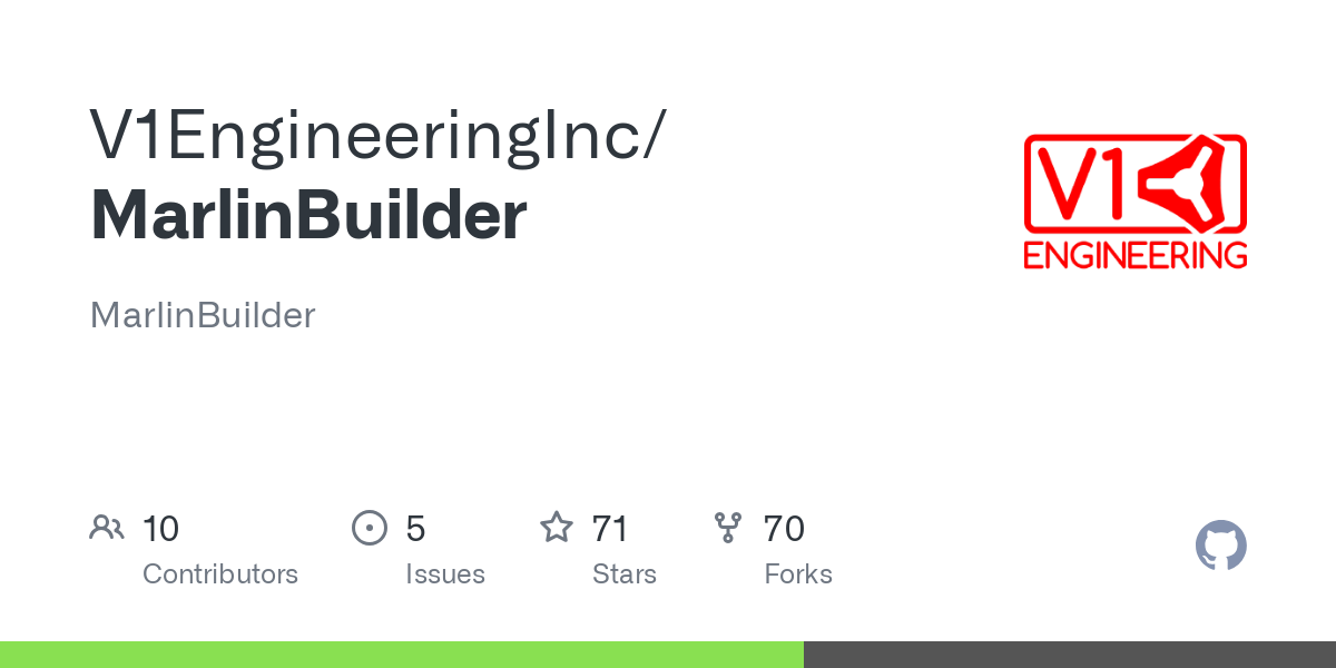

The new MarlinBuilds approach should help with this so all the combinations get configured in a systematic way.
But MarlinBuilds doesn’t build RAMPS non-dual-endstops right now so your best bet is to download Rambo ( V1CNC_Rambo-2.0.6.1-src.zip) and change the MOTHERBOARD to your RAMPS and change steps/mm to 200 instead of 100.
